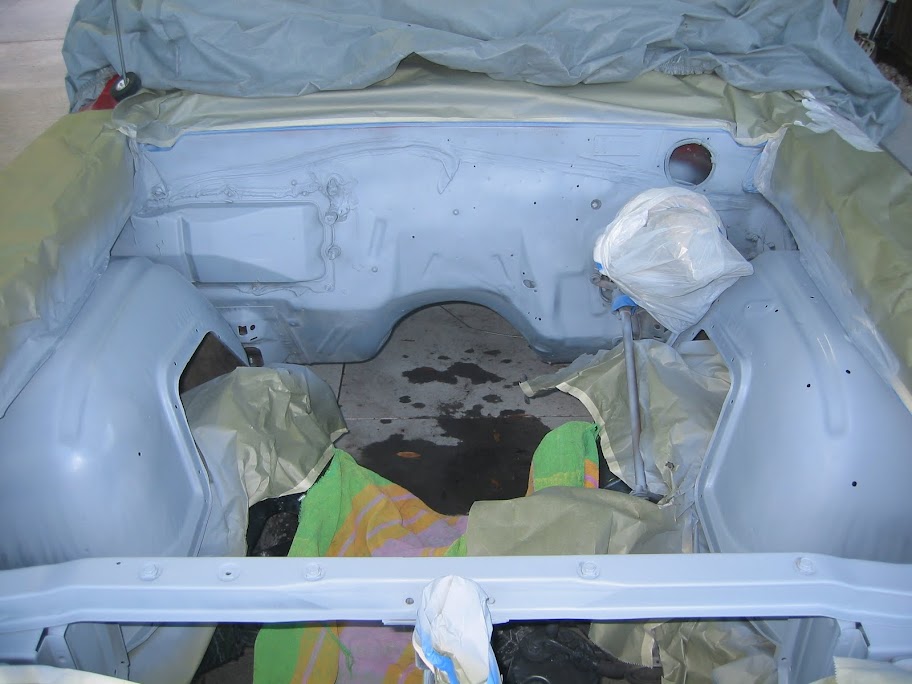

Well, I may not have the actual cars to compare so I did what I thought might be the next best thing. I went on the web and looked for engine bay pics. The 2 inner liners do not look the same at all.
Here's the 66 Cutlass engine bay showing liners
And here's the 66/67 Chevelle engine bay

Bummer. Thank you for taking the time to look up that info!! Anyone know where I can get them?

66 and 67 Olds A body is the only interchange for inner fenders, no aftermarket offered.
