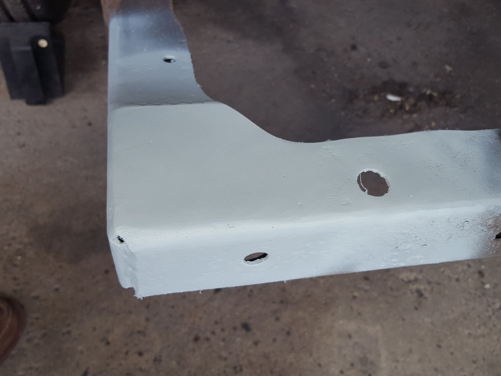

I am by no means a Restoration expert, I can only give my opinion on how I repaired my 72 Cutlass convertible frame
I had 7 frame mount holes that were rusted and needed repair. I bought a couple washers for this but found the metal was too thin and the washers wouldn't cover the entire area.
I decided to weld in new metal and recut the holes, If you look at my Photo Album you can see my process.
I would think if you want to just weld new washers on top, your call, but as you mention, to keep it all level you would have to do them all and unless you remove all of the
rust it would just come back and you would be in the same boat
Good Luck

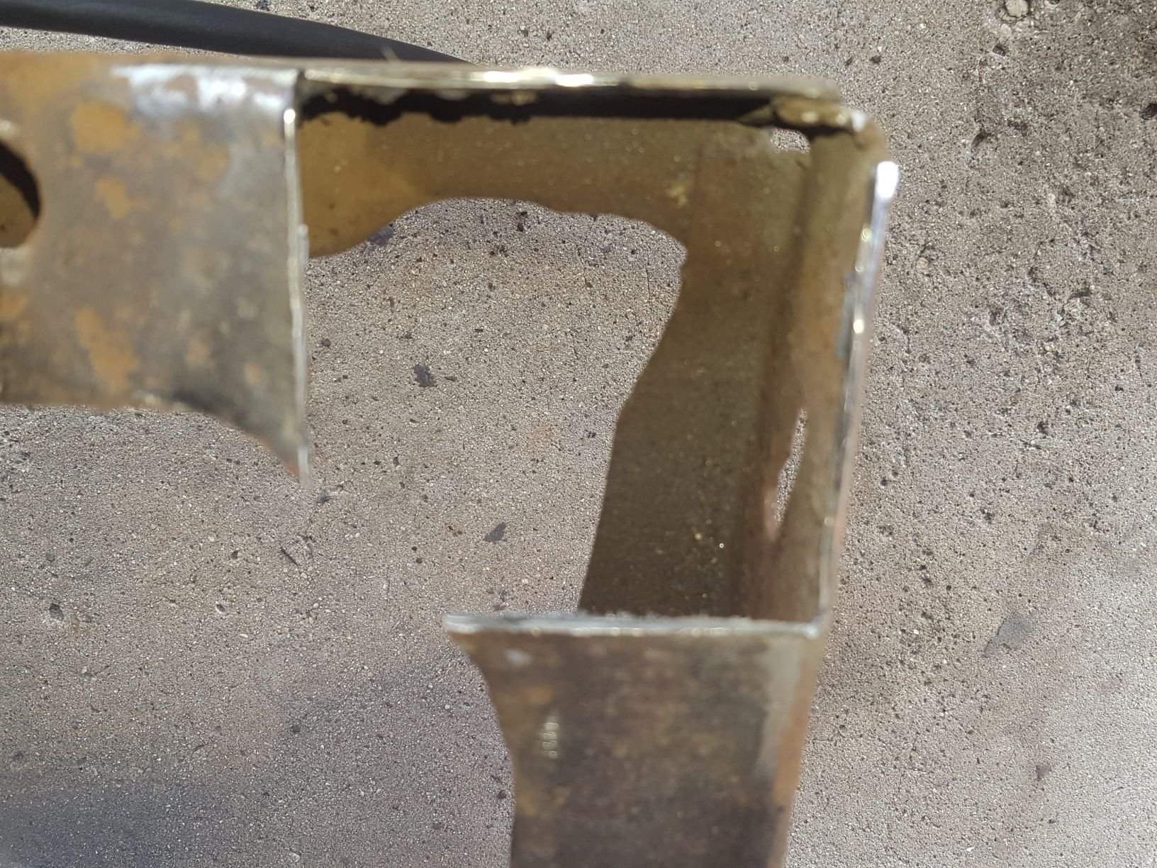

Do you mean like this/ Worked for me on my 67 Cutlass.

Here are a few pictures before and after, For comparison

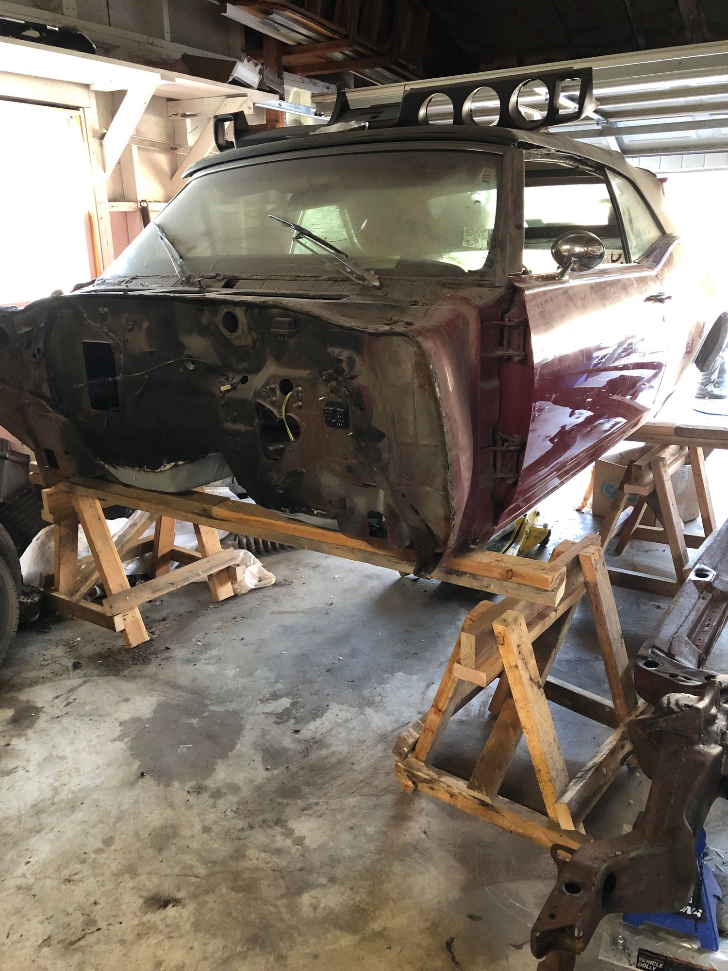

Well I’m into it
Old Apr 28, 2021 | 10:10 AM
Chatt's Avatar
Joined: Aug 2020
Posts: 83
From: Lawrence, Ks
See anything I need to focus on ?
Just that mess on the floor...

Heh Heh Heh!!!! After I took pictures I realized what a mess I was working above. I'll be better when I get started on the right side. Learning a lot about grinding and spot weld removing

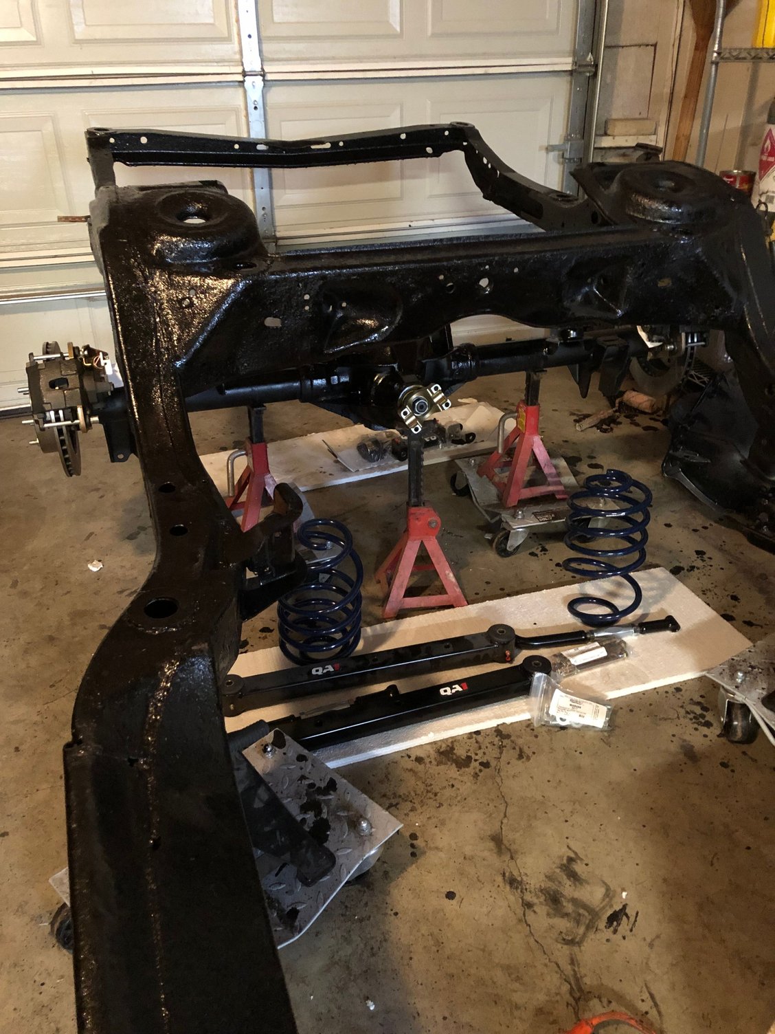

end of year progress
Whew!!!!

Still at it!
Frame all painted, diff. gears and axles installed, CPP disc brakes on. Now me and QA1 get to play!
