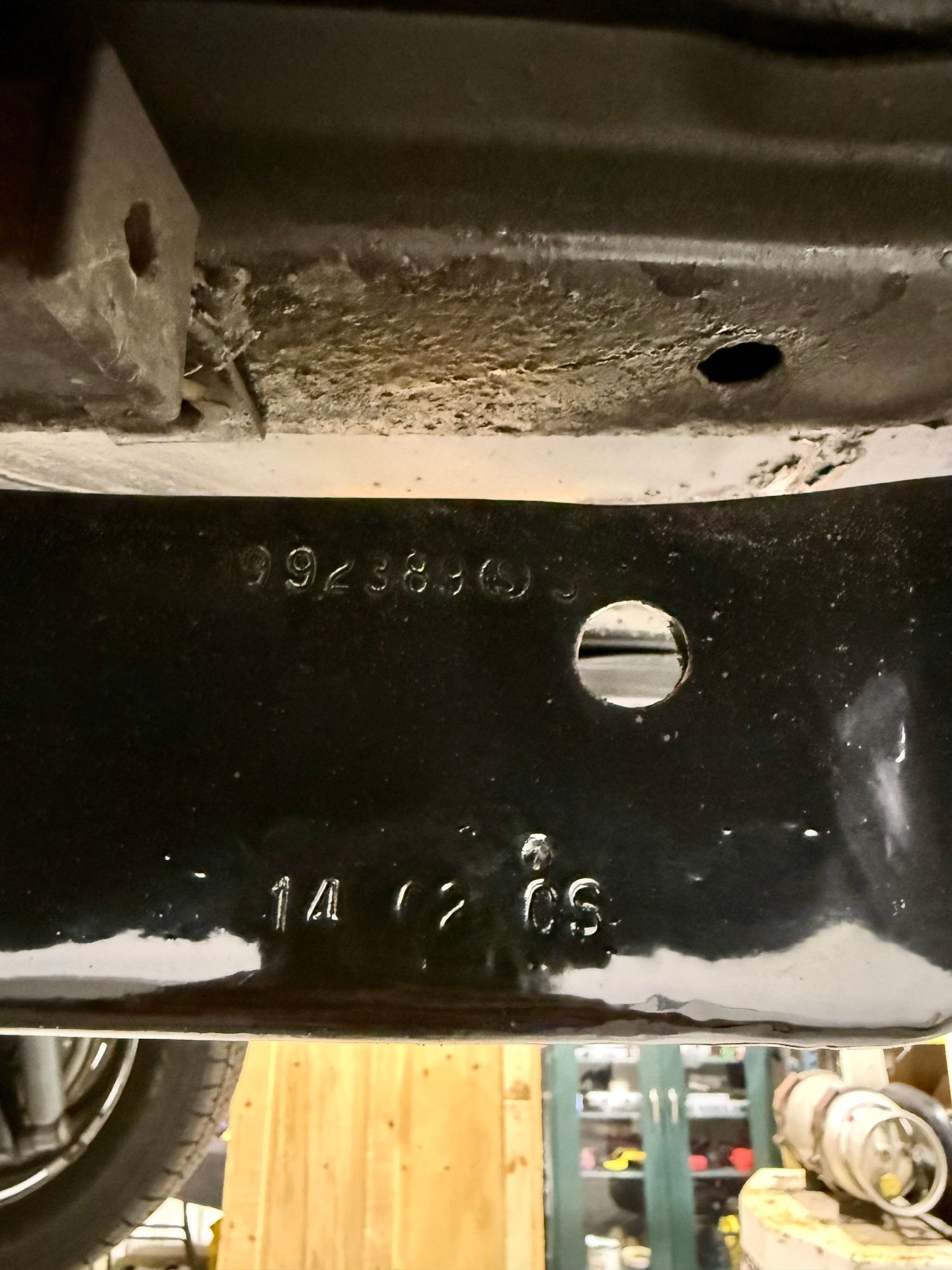

Good morning all. First time poster as I am trying to do some research on a potential 71 442 convertible purchase.
can anyone decode these frame numbers? Could this be correct for this car?
hard to read but the numbers look like this?
3992389. “S in a circle”. J
14 02 CS

They look like frame part numbers and manufacturer codes.

Here is a thread that may help: https://classicoldsmobile.com/forums...decode-155463/

See this post on v8buick.com by Duane: Actually "3992389" is the convertible frame number for all 1971 convertibles regardless of engine size.
