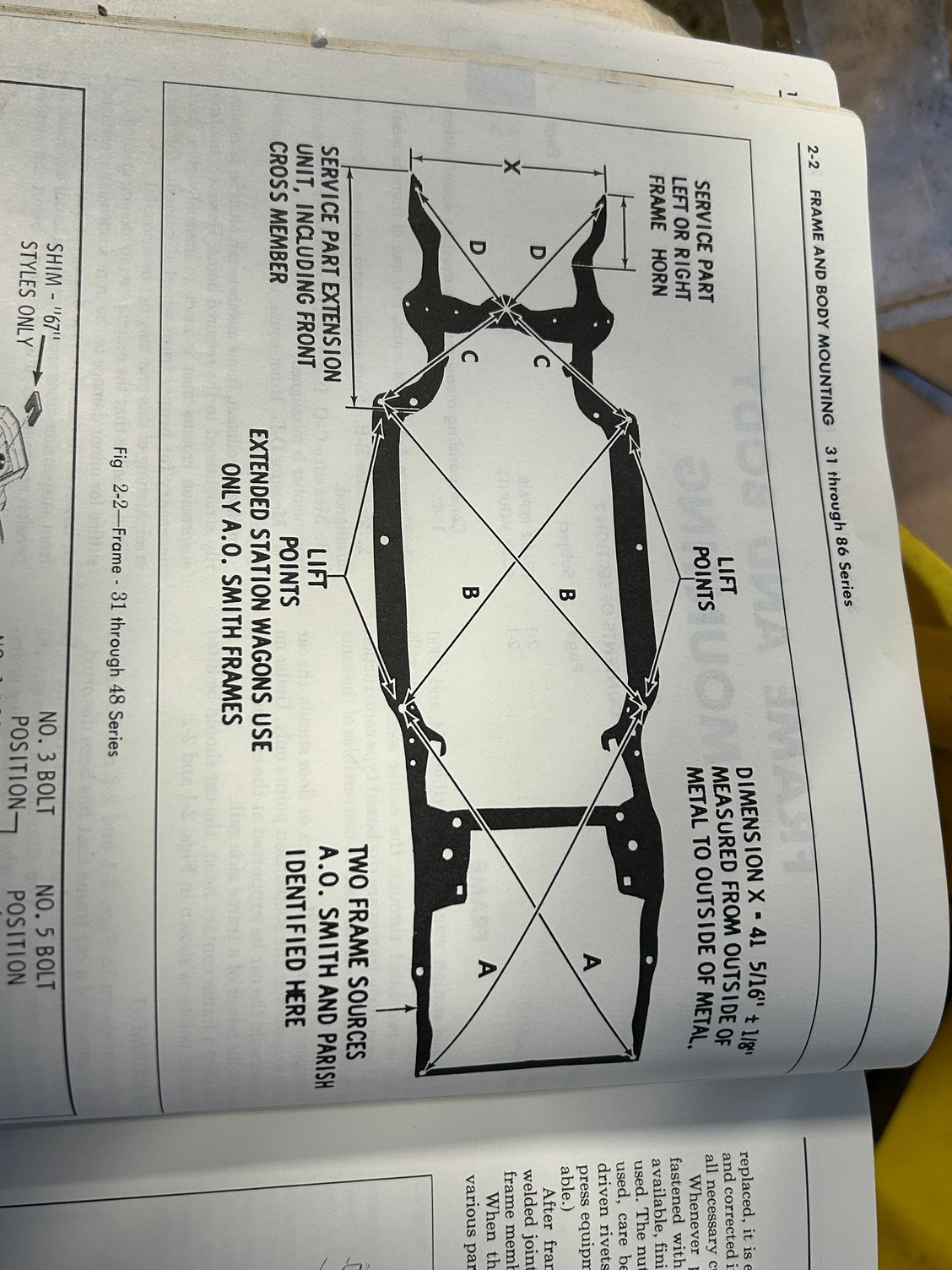

The only info I found is in the 68 Chassis Service Manual. It gives you the front horn spacing but everything else says to measure cross dimensions and they have to be equal.

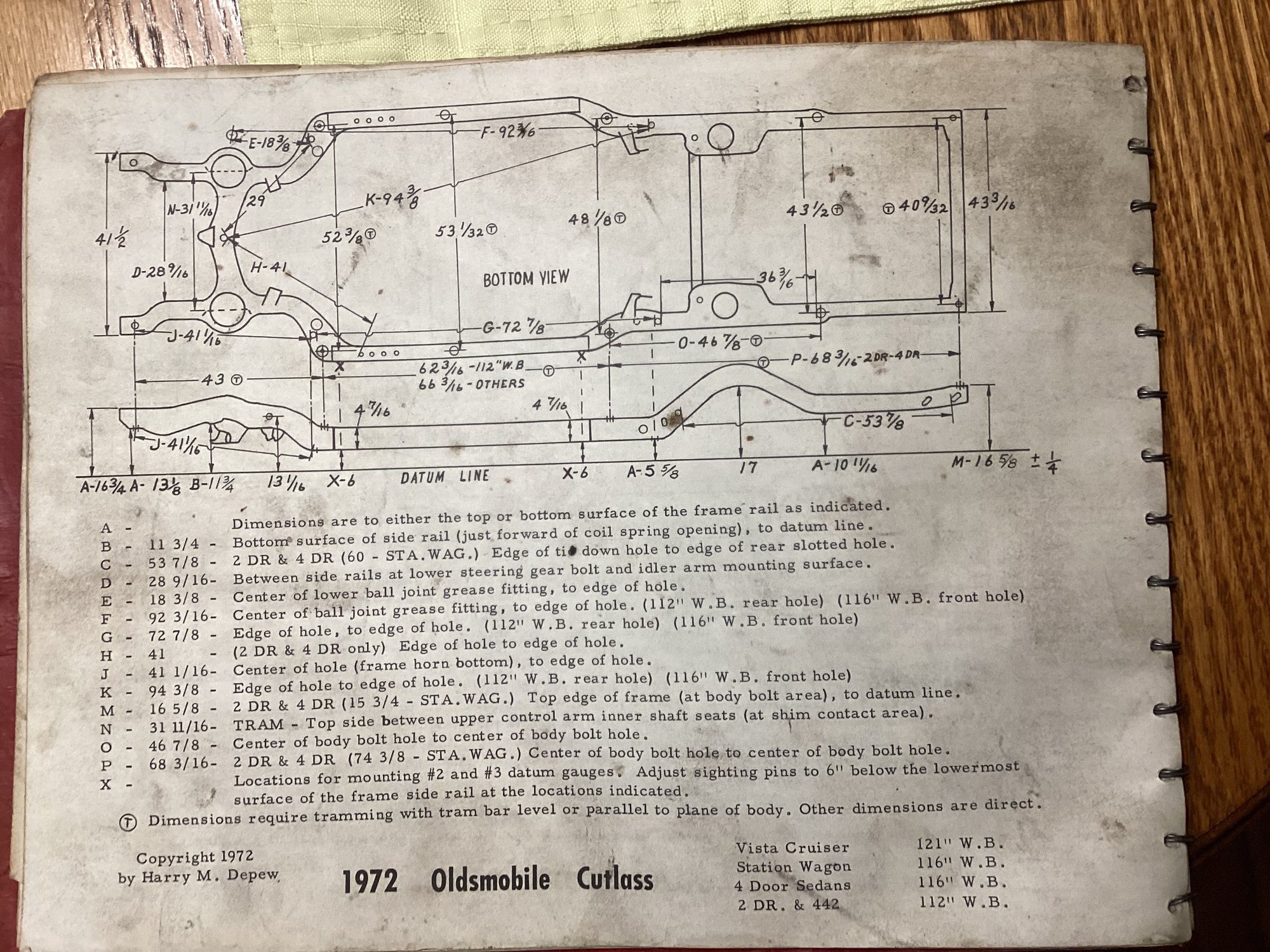

I Grabbed this off the internet about 10 years ago: used it to straighten the frame of my '72 442 convertible, seemed to be correct.
