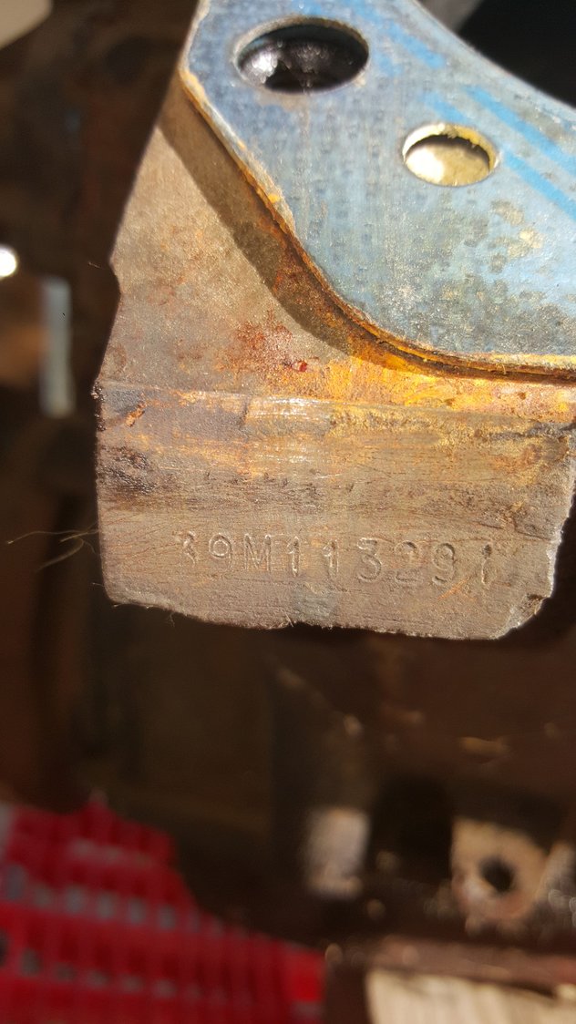

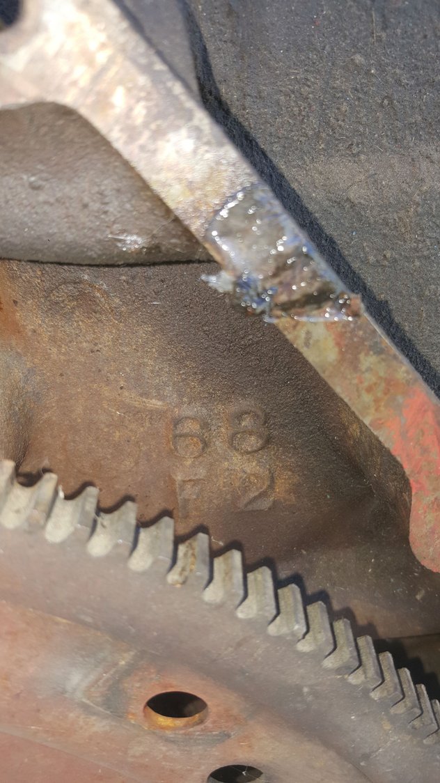

Originally Posted by 72xw30
Look at the pictures on their website, particularily the one with the VIN stamping on the block.....why does it start with a "79M" It should start with a 39M, with the 3 meaning Olds division.
It also has a 455 F block NOT a 400 G block in it - restamped for sure!!
Cheers
Its an olds 455 but would like to no more if u can help is it a rare block
