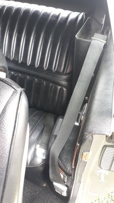

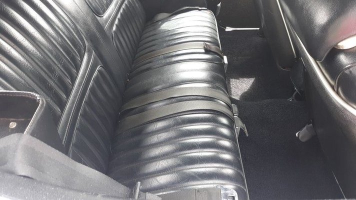

That sure looks like a weird shoulder belt mounting (or exit) location.
They are mounted correctly.
Old May 28, 2021 | 12:16 PM
Posts: 15,409
This is what I was meaning:
The shoulder belts in question that are coming over the top of the lift cylinder panel:
How they are mounted and should exit between the door panel and the top cylinder panel:
https://classicoldsmobile.com/forums...cation-137972/
Assembly Manual:
