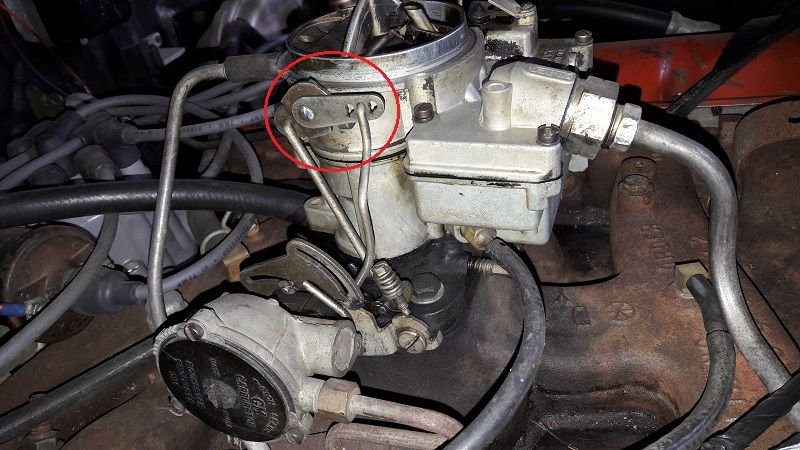

The car is already at my place and is waiting for a suitable time for inspection (brake cylinder replacement, carburetor adjustment, spark plugs, etc. :-)
finally home
Photo 2021 (in US)
incorrectly assembled choke rods (must be repaired)
It may be assembled correctly. Here's pictures from the 1966 service manual.
And the 2GC adjustment chart. Sorry it's sideways- the first two tries it posted upside down🙄
on my next 1966 Olds 88, the top rocker is correct .. correct from service manual
This is correct "tang" .. I don't know what the reverse installation can cause
