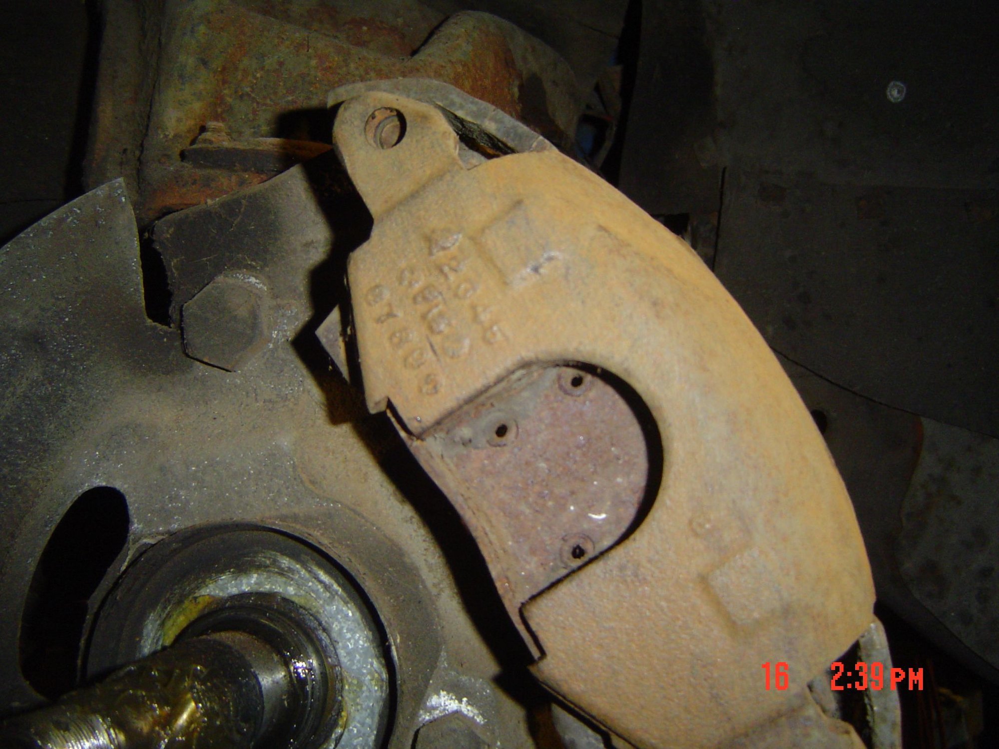

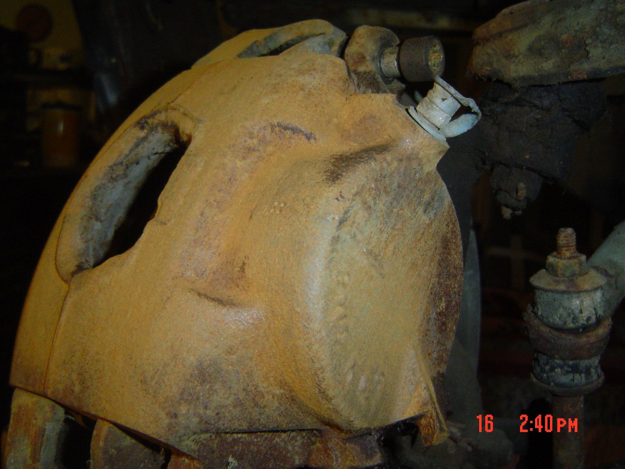

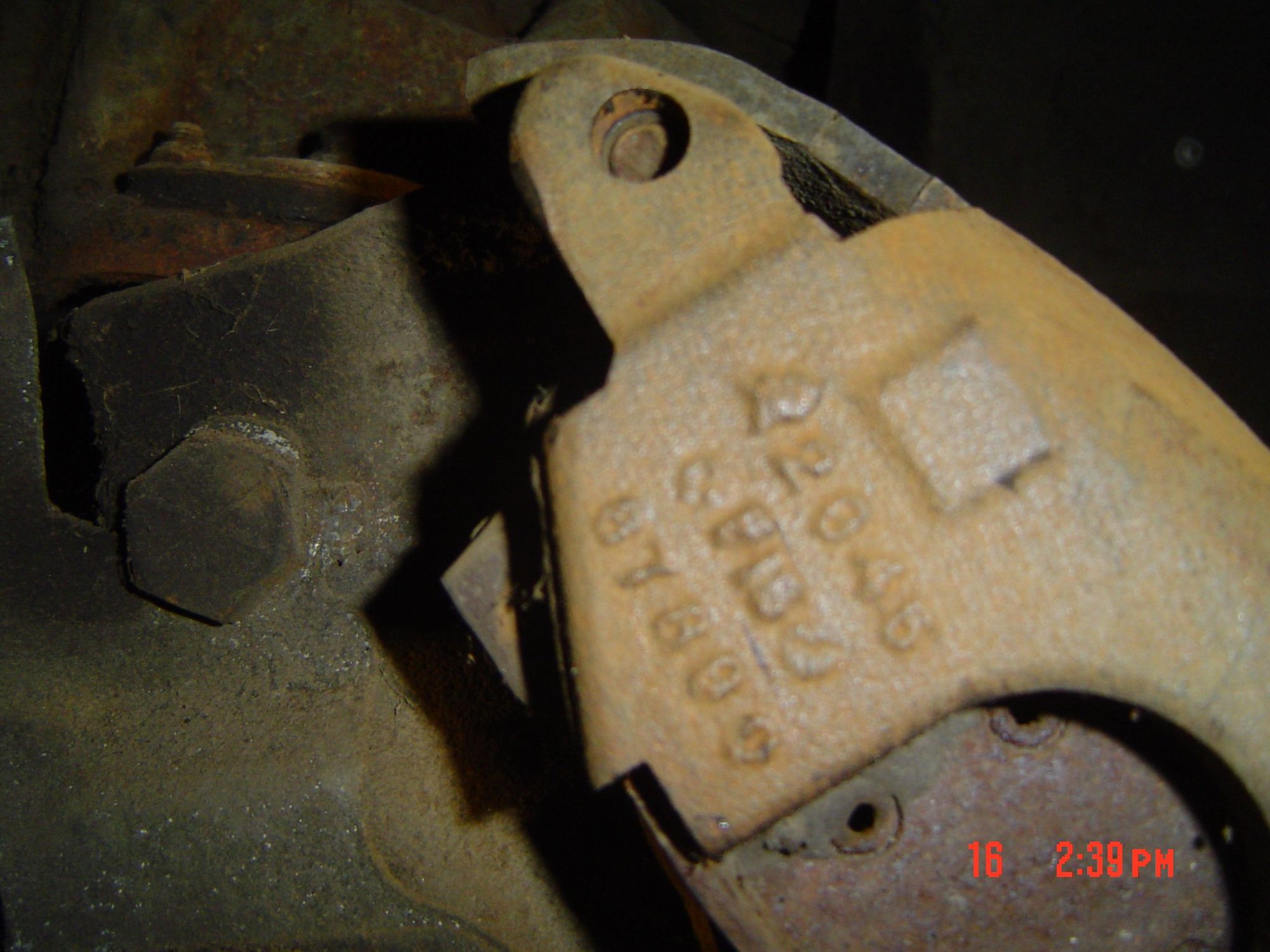

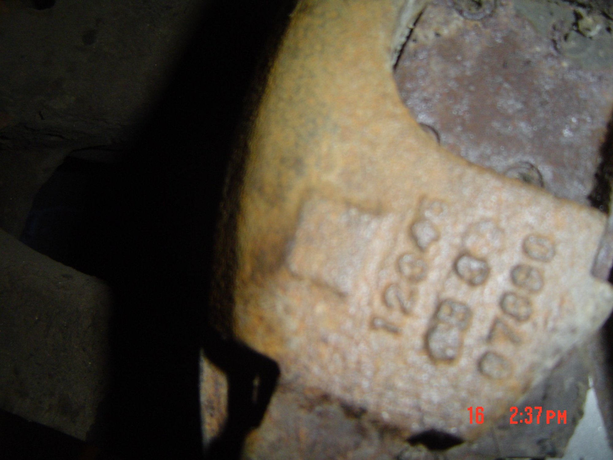

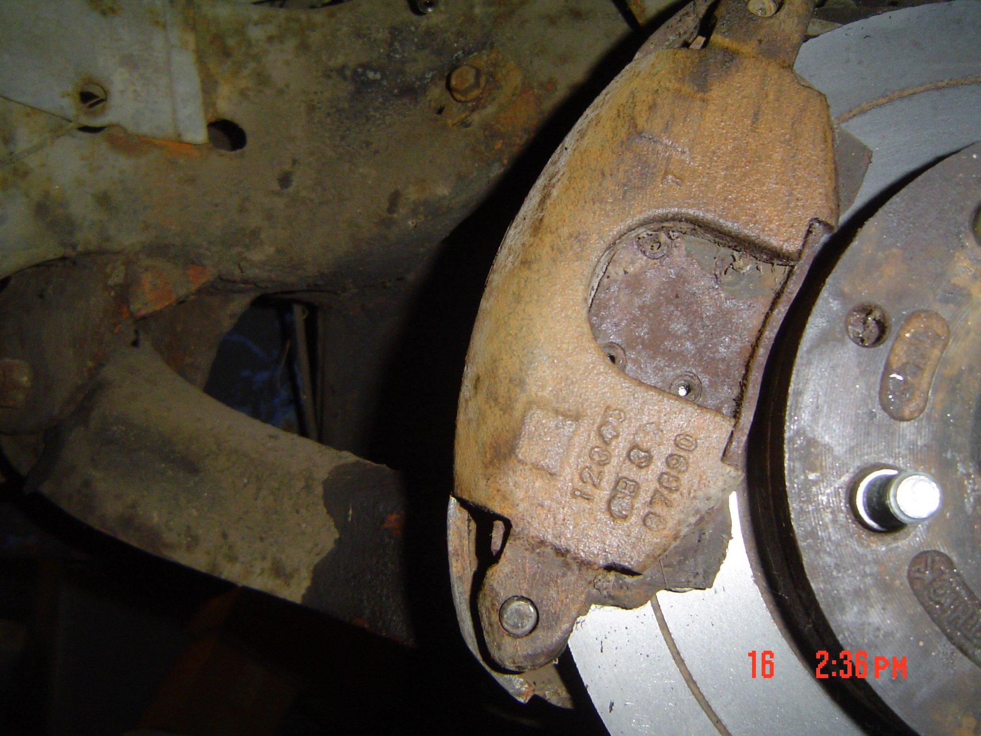

the brakes on my 67 442 are hanging up (can not turn tire) does any one know what these are from or what ones I should use?

Those are the 1969-72 single piston calipers. Also used in just about every aftermarket conversion kit.
