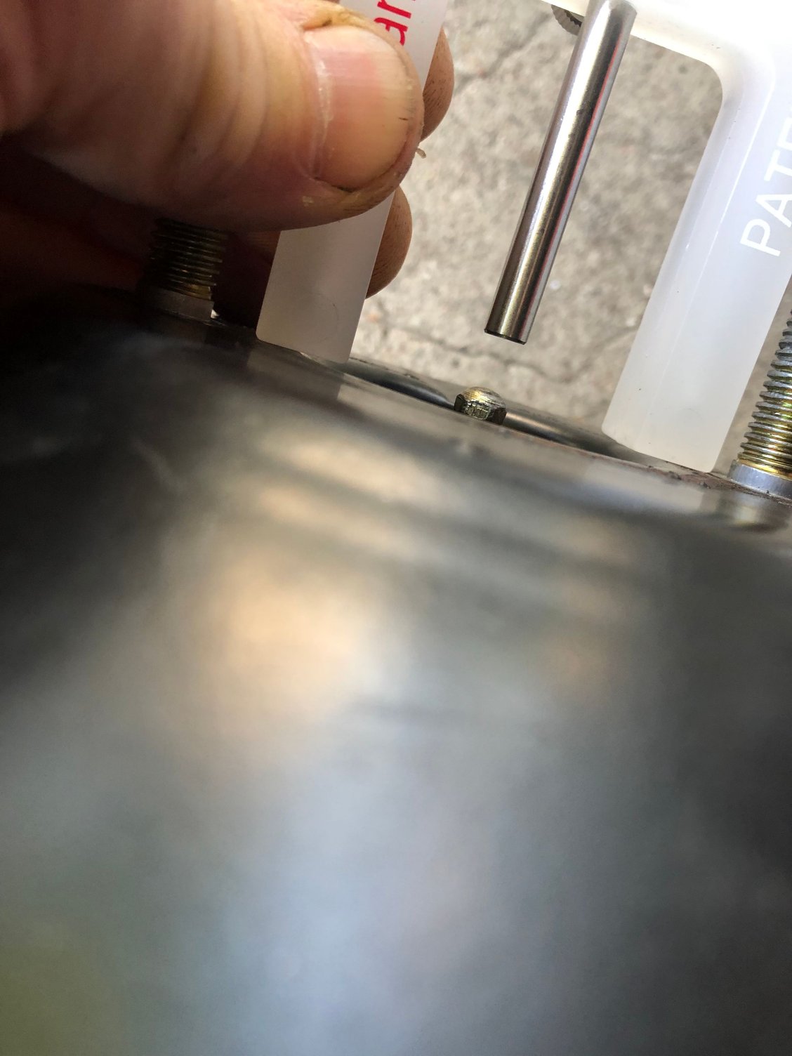

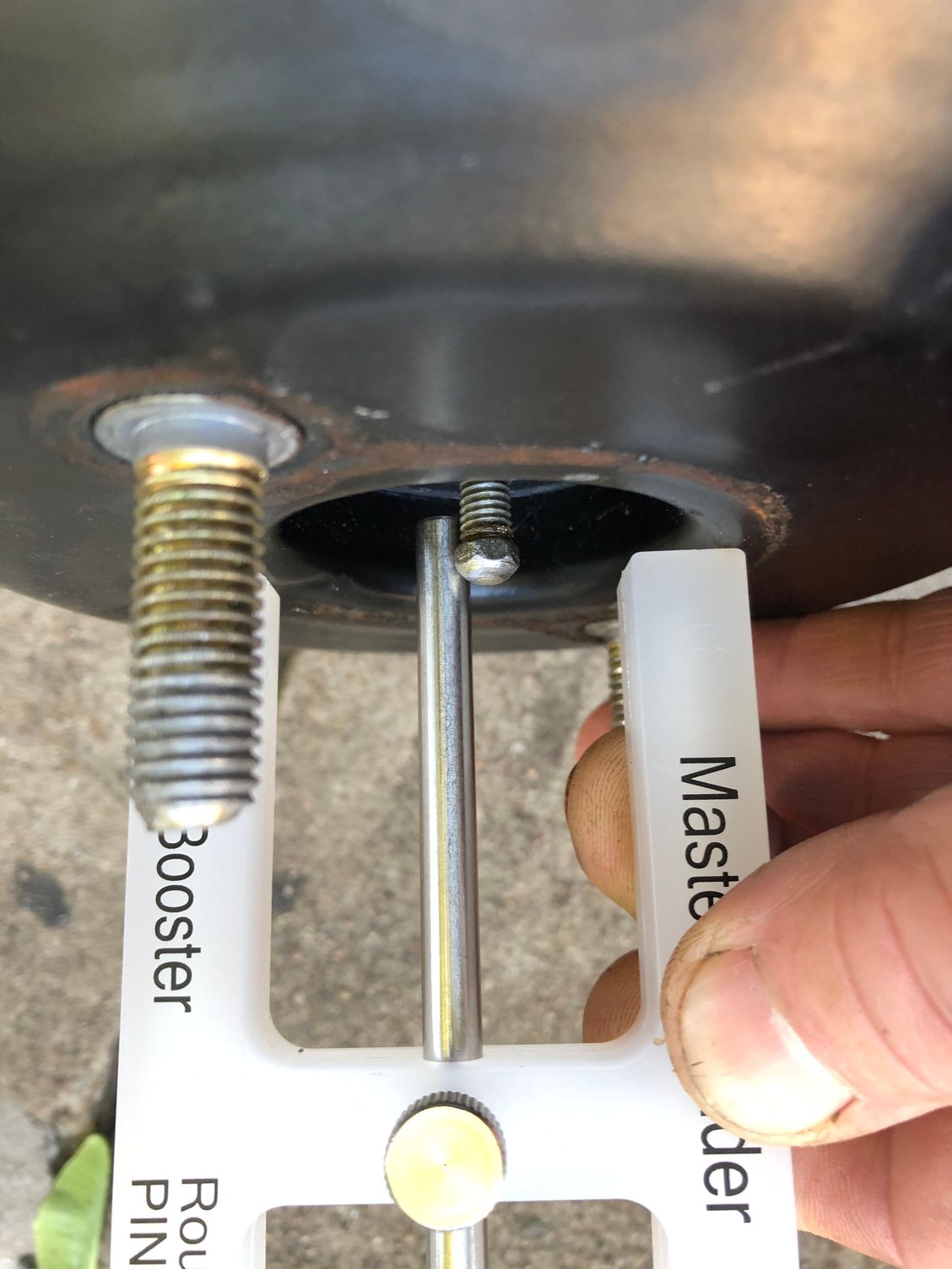

I replaced MC with 72 Cutlass application part. I replaced combo valve with a new PV2 I had laying around. MC fought me bench bleeding but eventually was acceptable. Fluid distribution remained as above, but always substandard, low volume. MC pushrod from booster had a huge gap(with bullet in piston), with the new MC it is now gapped at .020”, there is a small amount (~.100”) of free play inside the car with pedal at rest on upper stop.

Bullet was in the 69 style MC w/ deep piston recess. Here is the gap it was “operating” on relative to the MC piston depth, it’s so far off I figured I better clarify that it wasn’t measured without the bullet spacer. From what I can gather, 020” is preferred gap. 69 MC was rusty on outside and I didn’t trust the innards so I replaced it with something known to me that I could trust.
The 72 style MC (shallow piston) had a completely different and opposite LACK of gap! Corrected adjustable rod to .020” gap and things got better but not good.
