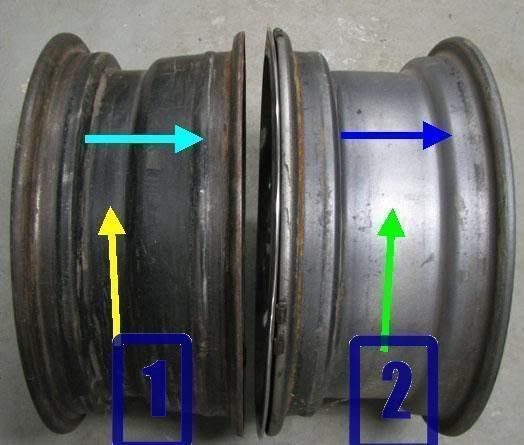

Keep in mind that there are TWO kinds of 14" wheels, those that clear disc brake calipers and those that only work with drums. The original wheels on all 1966 Cutlii are the drum-only wheels. Nearly every repro SuperStock wheel will clear STOCK GM calipers and rotors.
In this photo, the disc brake wheel (#1) is on the left, drum-only (#2) on the right. Inboard it to the right for both wheels. Note the difference in the shaping of the center drop portion of the rim as shown by the yellow and green arrows.
