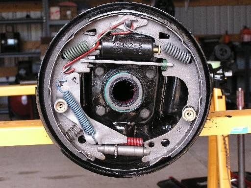

This image from Supercars Unlimited shows there is no gap between the bearing and flange, and lock ring and bearing.

Fun71::: thanks for the info. That’s the best picture of the brake springs I have seen thanks for the replies The bearings barley fit through the holes when I dis assembled it and I’ve got two coats front and back of por15 on the backing plates. I think I’ll test fit them and maybe remove some of that paint

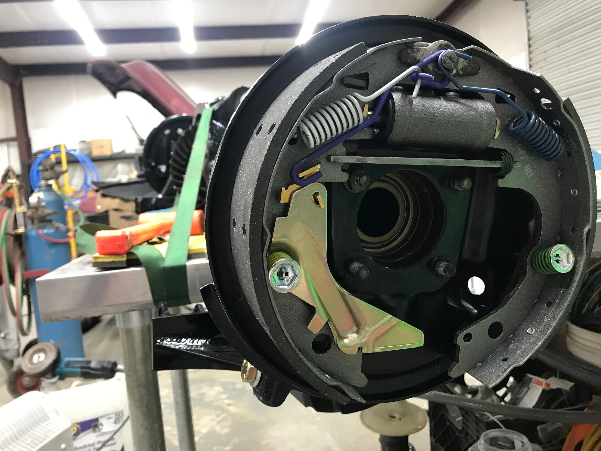

Thanks for all the help. Learned a lot yesterday. Had to modify my press… moved the support to the side and made a matching one… all to get enough room for the axle to fit
used a grind and chisel and got the old bearings off. I soaked the backer plates in chem dip and then pressed the new
bearings and lock rings on. So. I’ve got a new set of bearings ordered to do it again and include the backer plates.

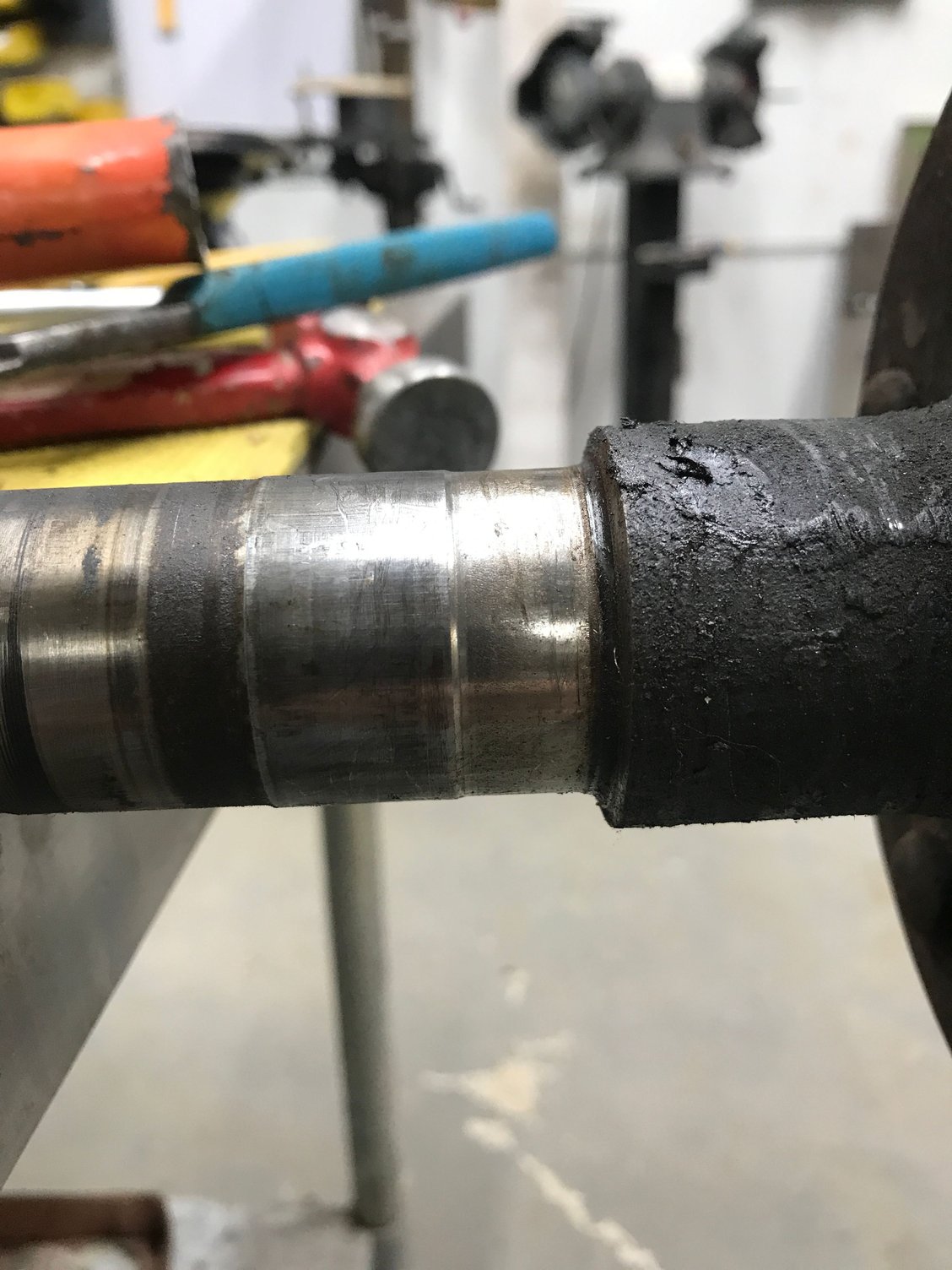

on one side I did notice the bearing mating surface was burned off a little The new bearing will not spin by hand on the axle but the axle is about 1/64 smaller diameter than it should be. I can take better measurements when it take it back apart
should I look for a replacement axle. Or run it and just keep an eye on it?

If the previous bearing spun in the shaft, the new one probably will, too. You could try some bearing and shaft LocTite as that stuff is specifically designed to lock the bearing on the shaft. I’ve never used it so I can’t say how it would work.
Old Oct 31, 2021 | 03:02 PM
Posts: 42,475
You need the area built up and machined down or a new axle shaft, any other attempt without a lathe will produce a vibration

Thanks for the replies. I’ll look for a shaft and call around to machine shops as well
the bearing surface on the axle is measuring from 1.3585” up to 1.3835. The lock ring surface is coming in at 1.3790 to 1.3890
