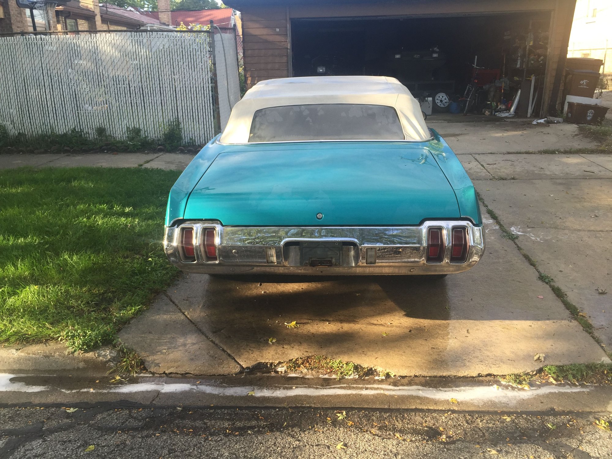

Old Oct 20, 2015 | 03:21 PM
Bikerman883's Avatar
Joined: Oct 2015
Posts: 11
Old Oct 20, 2015 | 04:00 PM
mrolds69's Avatar
Posts: 1,907
From: Toytown, MA
Ok...that looks like an inexpensive top and an amateur installation. Inexpensive because no glass curtain. I've seen worse. Might be fixable if you remove the trim stick and re-staple it tighter. That has to be done a few times, it looks like somebody gave up on it. The bigger problem seems like the back curtain or whole top is not centered...like if you look from the trunk lock straight up the back window, it looks off, could be an optical illusion. Maybe just the right side at the bottom came loose.
Old Oct 20, 2015 | 04:05 PM
m371961's Avatar
Joined: Mar 2012
Posts: 2,163
From: Sistersville, WV
With my minimal vert top experience, (but recent) the only way I see to tighten that up would be to remove trim sticks, pull staples and pull back curtain and main top down a quarter to half inch and restaple. Not for the faint at heart. Or take to a top shop. Once it is stapled to the rear bow top it must be tightened at each end by unstapling and re-streching. To remove slack between front and middle bow it would have to be re-done at front header.
