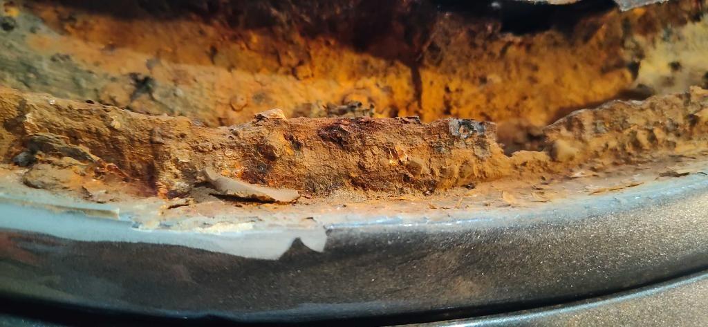

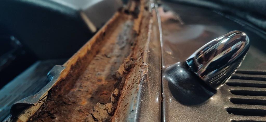

So working on my ‘63 f85 to get it air/water tight and after removing the windshield found some rust problems in the bottom windshield track.
Im not exactly sure what it’s supposed to look like so not clear on how bad it is. The car had been painted before I got it but is still a solid 7.5/10 so I don’t want and more importantly can’t afford a full repaint.
Anyone have suggestions on repairs, estimated costs if a shop does it or anything else for this situation? Anyone have pics of a clean intact channel so I can compare to?

Some of the expert body guys will probably speak up. I think the best thing would be to try and find some rust free sheet metal from a dry climate. The Buick Special and Pontiac Tempest may have the same sheet metal. That is some ugly stuff but you should be able to get by without a complete repaint. Good luck with the repairs. You are not the first person to face this.

There is no easy fix for this, only welding in new metal. The Y-body cars used both gasket-retained and bonded-in windshields, and the pinchweld is different, so if you get metal from a donor car, be sure it's the right one.

Not a difficult fix, IF you have the right tools. Back when I was getting started, I had a 67 Lemans with a completely rotted out rear window channel. Buying a shrinker stretcher, along with a sheet metal brake, is what you need to do this fix. If you're not going to do this work later on, maybe see if you can borrow one, else you'll need someone to do the repair for you. And, yes, it will need to be welded in.

This is good advice. Buy the HF shrinker/stretcher kit. You can make that channel easily with a piece of 18 gauge metal.

I know your looking at it with all that crud on it, I would get a wire wheel and clean that crud off and see how bad it really is, to be honest I’m only looking at the picture , See if you really need to replace the whole lower channel, then can you weld? And do you have a welder? Chopolds gave good advice on Shrinker and stretcher and a brake this will allow you to make portions of the lower channel , you can make a template from heavy paper or some old file folders , trace the shape , or get a contour gauge from lowes or Home Depot , this is if you want to try and fix it yourself , either way better to clean it first to see exactly what needs to be done . It could even be done a piece at a time do the seat then the side but this is a lot of work but doable in my opinion.

x 2..if you make a template and take your time you can do it.. is it going to be restoration perfect? Probably not but get rust out, weld in new metal, windshield covers it up. As JP said most body shops don’t have fabricators, just parts replacers.

Thanks guys. The car is currently at my friends house who has the garage space as mine is full of a bike lift and too dam many harley projects to fit the car in. He's more knowledgeable on hot rod building/repair than I am so it makes the most sense. Ill get over there and knock all the rust/crud off and see how far it goes back and see what all is needed.
Definitely not a resto project, but want to fix it to last and the hardest part is the car was already painted and the color has almost a goldish pearl to it so not an easy color match. This means trying to save the paint as much as possible.

Clean all of the rust out to clean shiney metal
Use short fiber glass body filler.
No sparks no cutting no welding.
Check drains on corners if any
You can do this yourself with minimum expense and tools

The half-fast repair will work fine - until it doesn't...
