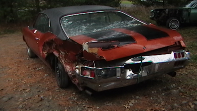

I bought this car from up your way in Northeast Ohio. Do you think I can fix it with McD bags and Bondo

You better use great stuff on that one

You're gonna need the premium gold bondo and cardboard for that one.

better get a big hammer

Originally Posted by dharlett
Allen,
Notice how the door line is still perfect and the rear glass didn't even break. Let's see a new car take a shot like this!
