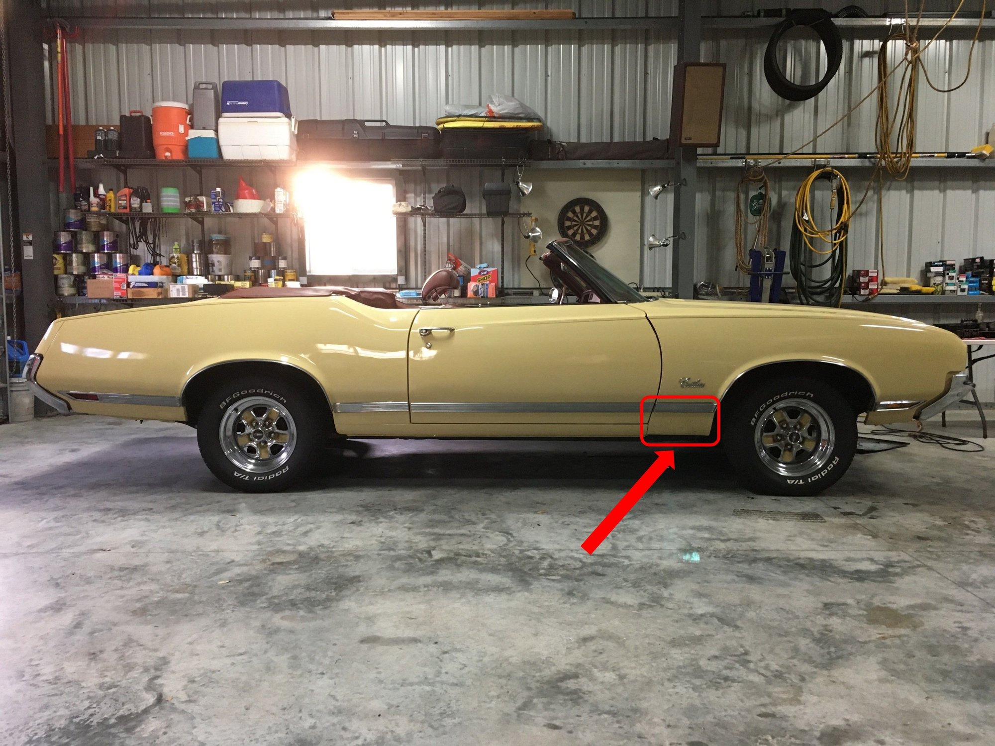

Name Of This Panel - Please
I can't recall the name of this small sheet metal panel (where water, leaves & debris accumulate). Mine is beginning to blister & needs replacement. Thanks for assisting. 1971 Cutlass Supreme
Old Mar 30, 2023 | 09:08 AM
Posts: 42,475
The repair part is "front fender patch panel, rear".
Old Mar 30, 2023 | 09:10 AM
Posts: 25,789
Roger that. Thank you, Eric.
Old Mar 31, 2023 | 07:23 AM
Posts: 50,768
That panel is named "front fender". If you are asking about aftermarket patch panels, that's a different question. Be aware that there are to versions of that patch panel on the market, the original thin repro and a much higher quality version with crisper stamping and the same metal gauge as OEM. The latter is usually priced about 50% higher than the former, and well worth the extra cost. Also note that the brace behind that area is not reproduced but usually rusts out for the same reason.
Old Mar 31, 2023 | 09:54 AM
Posts: 25,789
The “panel” identified in my image by enclosure w/in the red outlined round corner box is indeed the “patch panel” I am after - NOT the entire front fender. I was aware the brace may very well need replacement, as well. Thanks for mentioning the quality of the sheet metal, that is great info as I hate that thin skin junk.

That part of the fender is usually called the "heal".

"Heal" is what you do when you repair the rust in the "heel".

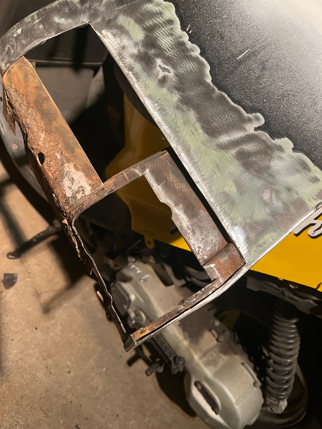

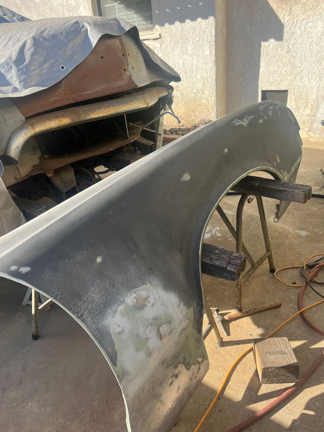

Front Fender Patch and Brace Repair
Norm:
There can be a significant amount of rust hiding between the outer skin of the fender and the inner brace. My fenders needed the patch panels, same as yours, but I decided to separate the fender from the brace when making this repair and I'm very glad I did as the condition of the metal surprised me. To remove the rust I soaked the brace in Evaporust followed by a serious wire-wheeling, a coat of rust-conversion primer and several generous coats of Rustoleum industrial spray paint. Fortunately the brace was still pretty solid; I didn't have to make any sheetmetal patches, but made several plug welds to fill pin holes in the metal. This is not for the faint of heart and makes alignment of the patch more difficult but I sleep better at night knowing I didn't leave this cancerous time bomb in my car.
Here's a few pics below, you can see more details in my restoration thread at:
https://classicoldsmobile.com/forums...e-57404/page5/
___________
Rodney
Backside of the fender
The inner brace
Restored brace
