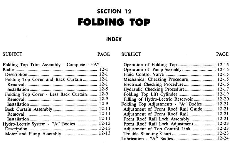

Posts: 25,789
As Kenneth mentioned, there's an entire huge section of the folding top installation/assembly/lubrication in the Fisher Body Service Manual. I own one for the 1971. You really need this manual.
Old Jul 25, 2024 | 09:06 PM
Posts: 25,789
Probably find most of them on eBay - check around for condition and shipping. Not too expensive really and a wealth of information.
1972 Fisher Body Service Manual
Old Jul 25, 2024 | 09:27 PM
Posts: 25,789
1971 Fisher Body Service Manual Folding Top Section
