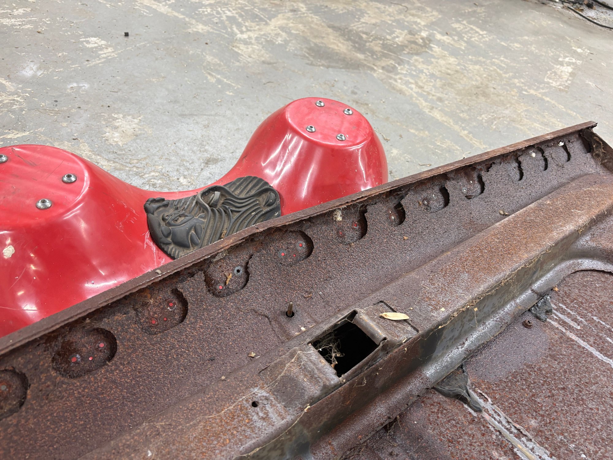

Unfortunately you are correct. Well in my case some of the pins on the letters were just rusted away. Also the bottom of my hood is way worse than I thought. I’m going to look for a round knock-out and see if anyone makes a oval one id so I could try to remake this inner piece
i dont know. I’ll need to come up with something
I got all of the rest of the trim off this morning and the “eyebrows” over the headlights were both cracked in half.
The plastic wedges
worked perfectly on the side moulding pieces.

I mean other than “that” the hood is in good shape. I really don’t want to try to find one.
