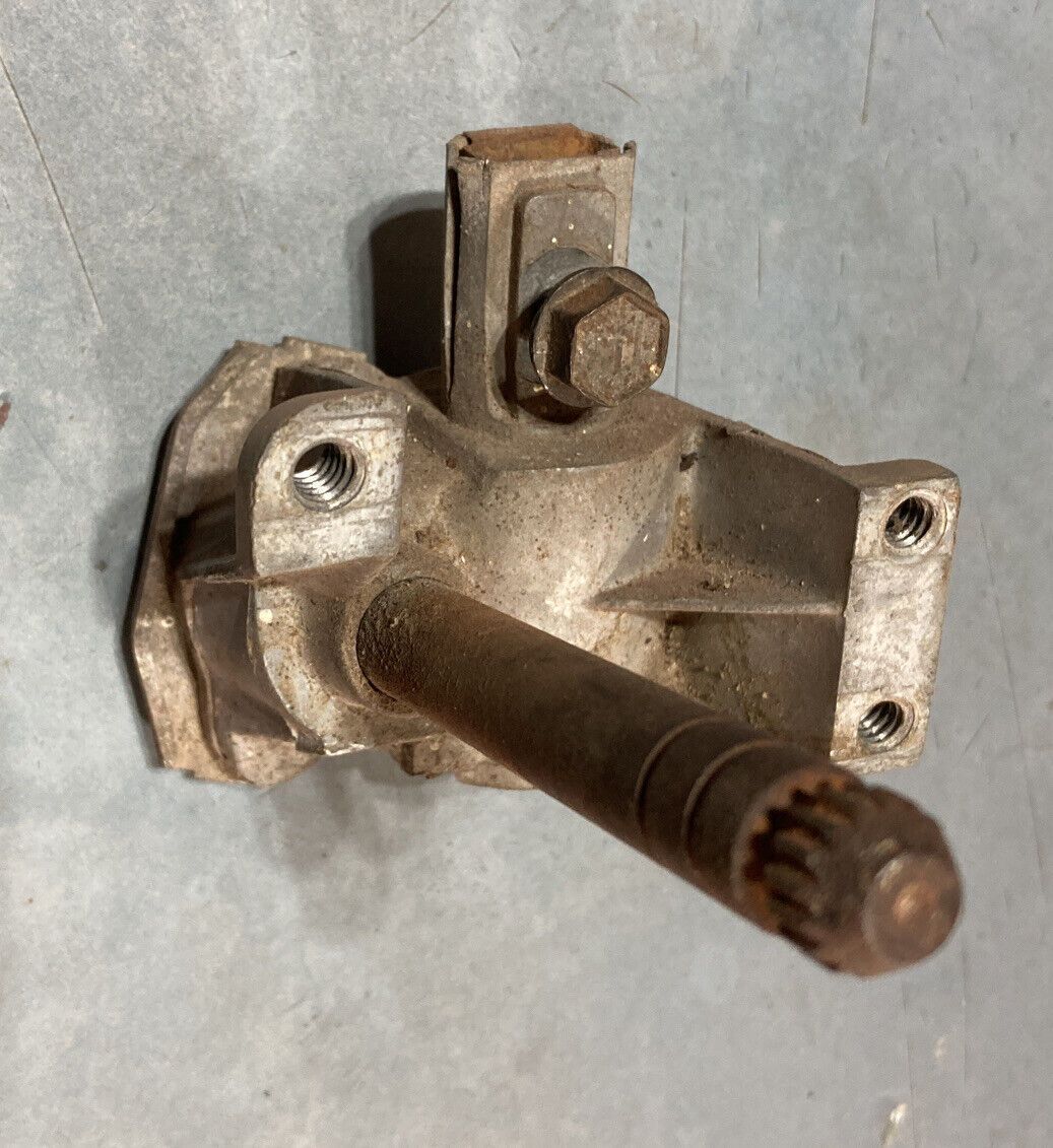

Unfortunately, there is no adjustment on the vent window. Either it closes or it doesn't. Ensure the pivot points are lubricated and the rubber isn't so hard that it is preventing the glass from closing. Assuming both are good, my money is on a bad vent window regulator. The body is just pot metal, and if you had to force the windows open, there's a good chance the regulator broke. Unfortunately you won't know this for sure until you remove the inner door panel and pull the regulator mechanism out of the door. First place I'd look is the sleeve that slides over the shaft on the vent window. Second place is the gear.

Sorry I missed that. This tells me the regulator has a problem. It could be something as simple as the bolt that clamps the sleeve to the shaft has loosened up, but odds are it's something broken or stripped.

In the A-bodies, are the 3 mounting bolts in slots like the big cars? Or do they mount in holes with no adjustability?
One of my window adjusting steps in big cars (Starfire & 98) is to loosen the regulator mounting bolts for the vent window regulator to allow adjustment of the entire vent window assembly.
I just got done adjusting windows on my big cars and took it as kind of a win that my vent window regulator bolt position in the slots was more or less in the middle of the mounting slot.

Sometimes you pull the regulator and reset (aka hammer back down) the rivets to hold tighter against the body assembly of the regulator, but consider it a “getting lucky” scenario.
This many years later, cleaning, degreasing and regreasing the regulator is probably smart. Part of what makes these not work is long dried out lithium grease.
You may be on the hunt for a new regulator, but not to worry GM made many many from the at least 1965 on up.

Chris, it's been a while since I looked at one, but I'd put money on the holes being oversize to allow for tolerances. Usually you mate the regulator to the window shaft first, then bolt down the three mounting bolts. Having said that, I can't really see how moving the regulator in the plane of the inner door skin will take out rotational slop in the gear drive or coupling.
