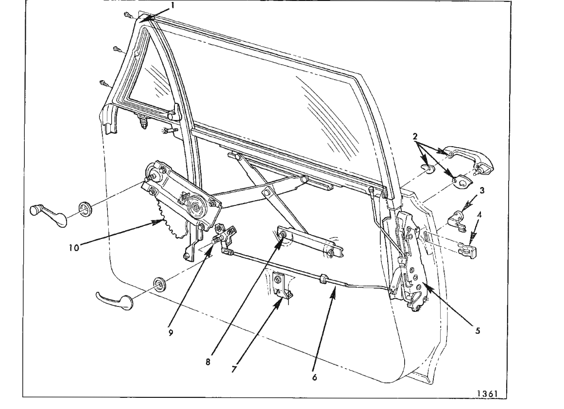

Here are two pages out of the body manual, first is a post door , second is a hardtop.
What parts are you trying to use?

Post vs Hardtop
Sorry to tell you that nothing between the two different doors interchange. Vent window, glass and rear track and regulator are all different.
