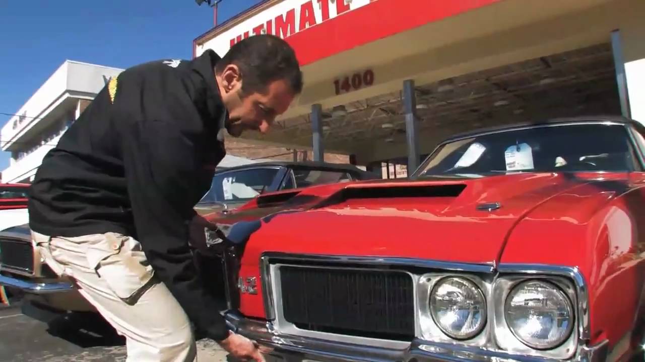

I found some pictures online that show more of a flat bottom. Maybe it should look more like these?

Yes, should be pretty flat there.
