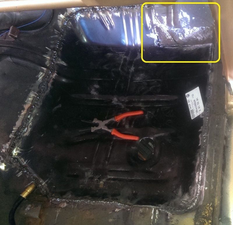

You probably already know this, but I'll mention it just in case. You have your passenger side laid out in a basic square as I did when I started cutting on mine.
However the upper right corner going to the floor board to the toe board you are going to run into the body mount out on the cowl. That is why I changed the cut to go around that part. You can see the notch I cut out of the pannel in the first picture to miss the body mount.

watch out for the double thickness material right up front , i see in your chalk outline youve gone right over it. I did the same only w a body saw fortunetly i realised my error after a few seconds of why isnt this cutting
i think its where the body mount attaches to the body shell

I used a cutoff wheel and a spot weld cutter. That was before i had a plasma cutter, i would probably use it now if doing it again. That square outline is a body mount brace lower firewall and under that corner, a spot weld cutter will get it off, but theres an area on the bottom thats not accessible to weld it so it has to be welded inside the car in that area. I actually welded mine all inside and on the botton that was accessible, but i have my body on a rotisserie. Then ground it smooth just to be sure i had a solid weld. HOWEVER do not use the plasma cutter in the outlined area as it is a body mount brace for that corner of the body. Again its on the lower firewall and wraps under the body.

Mad man with a body saw. Oops, I guess I didn't want to cut that. I'll go around it. Oops, I need to go a little further to go around it .
Also in that corner there are two rubber fuel line pieces that connect the steal lines. They may not take to kindly to a lot of plasma sparks and hot metal.
