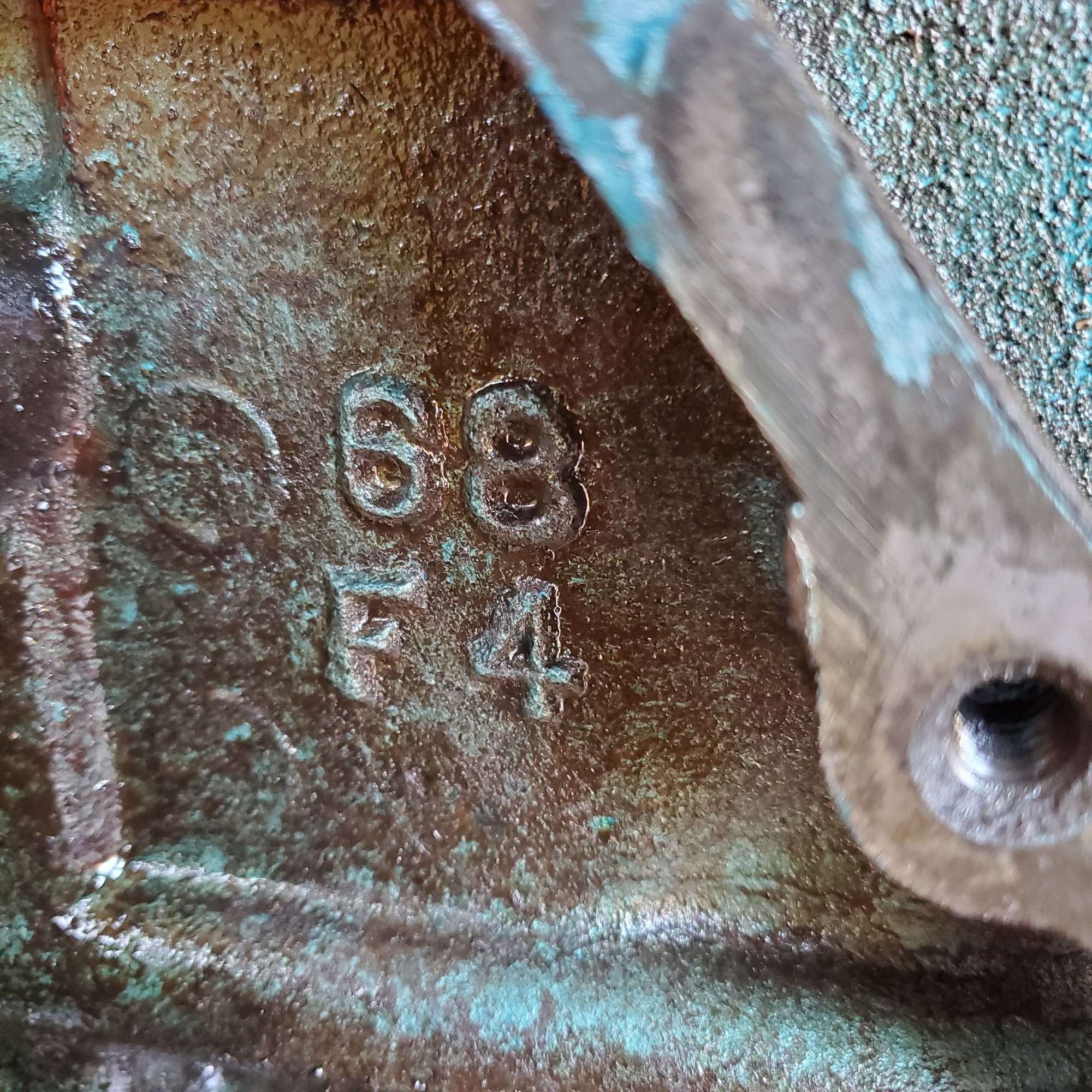

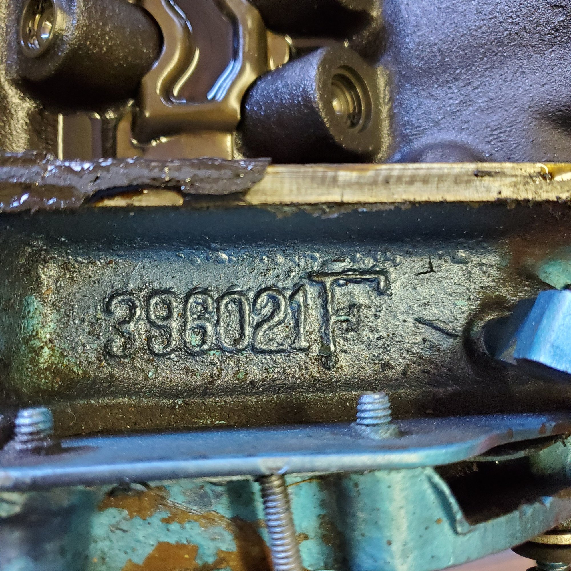

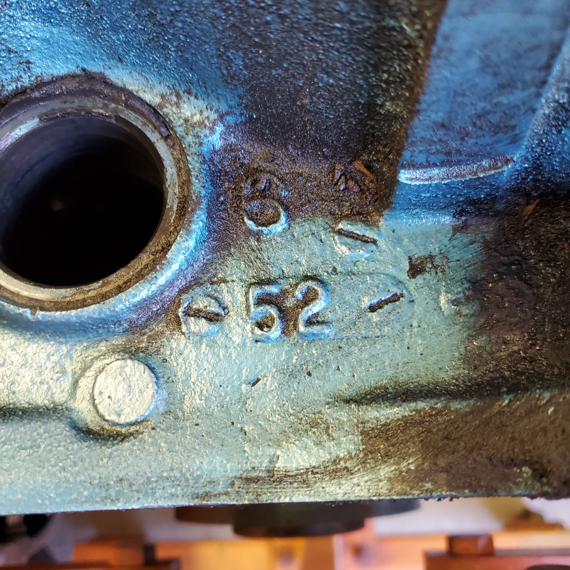

Getting ready to build this 455 - what year block could it be? It has nothing stamped on the small driver side pad. Has the Serief F on front, 68 and f4 on rear, 52 and 6 at the dizzy.
Old Oct 28, 2023 | 12:58 PM
Posts: 25,789
A significant amount of knowledge can be garnered performing a simple search (upper right hand corner of page) of the term 396021

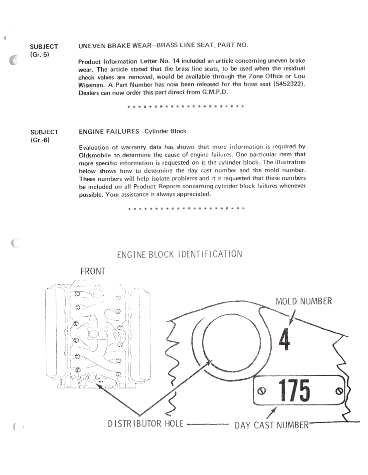

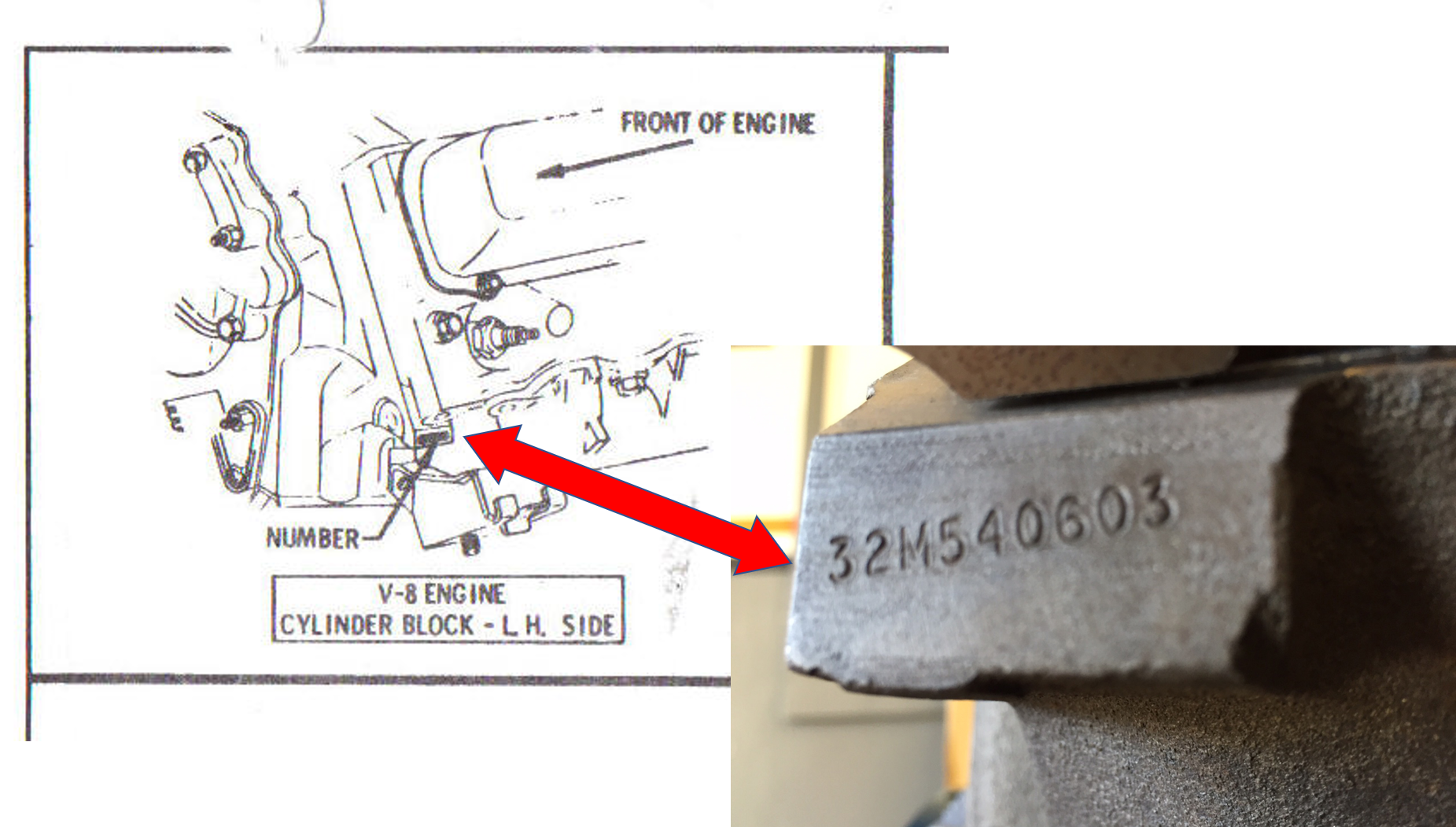

There is no way to tell from the photos you posted. The ONLY way to determine the model year of an Olds block is from the VIN derivative stamp. The second character is the model year. In the example in the photo, the "2" means 1972 model year.

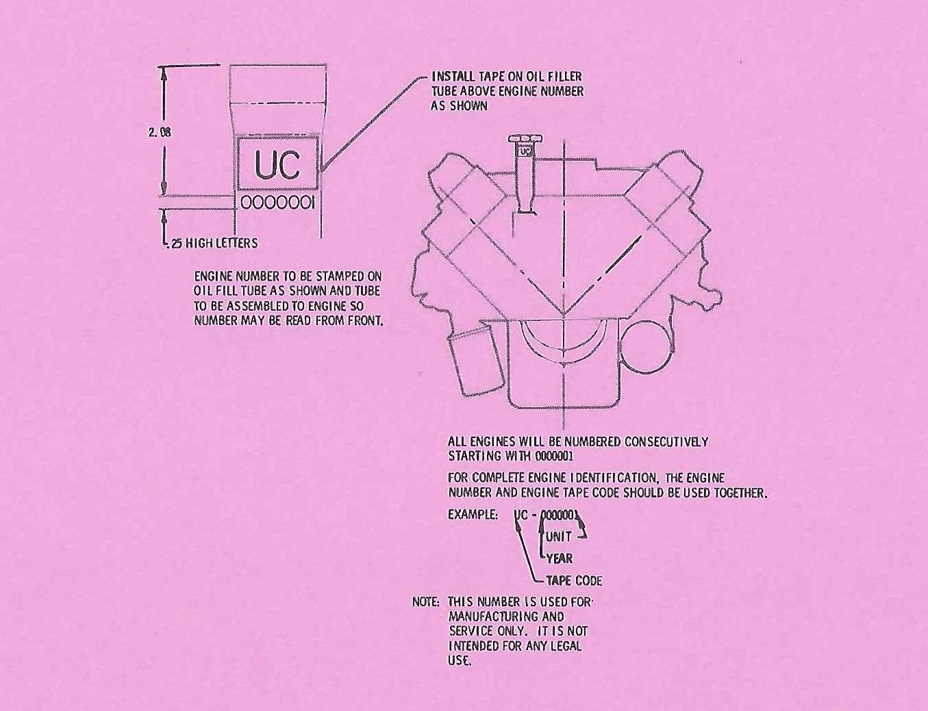

Does it have an engine unit number on the oil fill tube?
Old Oct 28, 2023 | 07:17 PM
Posts: 50,768
All that proves is the year of the oil fill tube

No decal on the filler tube.
Yes, the decal would be long gone. If it's there it would be a number physically stamped into the oil tube.

Posts: 50,768
I read on here somewhere that the 6 on the back means 1972? 5 would be 71, 4 a 70, etc. Is that true?
No. That large digit is a mold number, not the year. Now, there is SOME correlation between mold number and year, but not always. I have too many blocks where the VIN derivative stamp contradicts that "year of casting" myth.

Posts: 25,789
I'd be hard pressed mistaken to believe there is no VIN derivative stamp on the engine block pad. It's hard to see, sneaks under the ALT next to cylinder #1. You may need sandpaper or a wire brush to remove paint/crud.

It has been milled or ground off
Old Nov 2, 2023 | 04:32 PM
Posts: 25,789
If the pad is blank the block could be a service replacement (under warranty perhaps) installed by a mechanic too lazy to stamp the block when he installed it in the car.

So is it possible for a 6 mold number to be a 70 block?
Old Nov 5, 2023 | 09:06 AM
Posts: 25,789
Sorry, I don't understand the question. What is a 6 mold number? Where would this 6 mold number be located?
Old Nov 5, 2023 | 09:41 AM
PaulWinn's Avatar
Joined: Dec 2013
Posts: 218
The number next to the distributor hole

Old Nov 5, 2023 | 05:33 PM
Posts: 50,768
Scroll up and read post #8
Old Nov 5, 2023 | 05:49 PM
Posts: 25,789
Ah Ha. Gotcha. Thanks, Joe.
