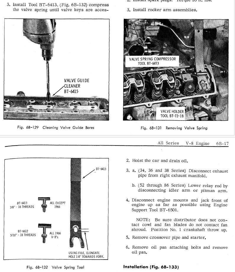

Taking on a somewhat intimidating job this fall on my '66 Toronado (I'll be replacing the valve seals) and I'm looking for any advice you guys could offer. Pitfalls, common issues, etc you run into and how you solved them.
I've never done this job before but I'm up for the challenge, although I'd still love your input. A couple of years ago I had to replace the valve cover gaskets because they were leaking oil like crazy and the engine made a ton of smoke when running. While I had the covers off I noticed bits of the valve seals sitting on top of the heads so they're obviously deteriorating. I didn't replace them at the time but I think now will be the right time as I'm definitely burning a bit of oil and the end of the driving season is soon upon me here.
I've got the CSM, which actually doesn't exactly tell you how to do the seals with the head on the car, but I think I can piece things together. I have a spring compressor tool that I think should work (see my picture below), and I have a new set of the Fel-Pro SS 70393 valve stem seals to throw in. I've also got a tool that can supply compressed air to the cylinder to keep the valves seated. So far I'm set up for success, I think. I won't be replacing the springs at this time. The engine only has 80k on it and was never run hard.
My questions so far (I know, I'm sorry I have lots):
Looking at the CSM, there appears to be no adjustment of the rocker arms? Do I have that right? Just put some assembly lube on the pivots and torque to 35 ft lbs? Do you guys like to do these things in the firing order or just go 1-3-5-7, 2-4-6-8?
Best practice would be to roll the engine over to TDC on the cylinder your working on and add compressed air to hold the valves closed right? If it's not bang on TDC, is there any problem with that? If the valve somehow does fall down, you're taking the head off aren't you?
The keepers, are they typically stuck? Any tricks on breaking them free? How about the seals? I've heard they can be very difficult to get over the valve stem sometimes......any tricks for that (maybe hot water?)?

That's the tool to use.
Just do the valve guide seals by the firing order 1, 8, 4, 3, 6, 5, 7, 2 when each cylinder is at TDC. You can watch the lifters and pushrods and stop close enough to TDC.
If you aren't married to using an air attachment you can use a length of nylon rope. Feed it into the cylinder and then rock the engine back so the rope is compressed against the valves. This will keep them from falling into the cylinder.

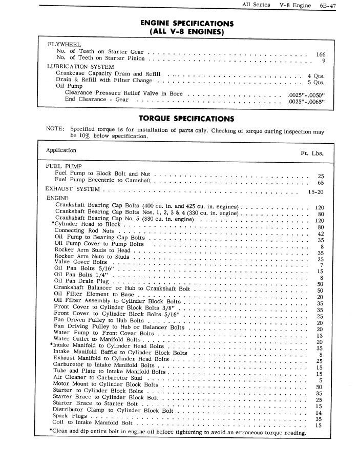

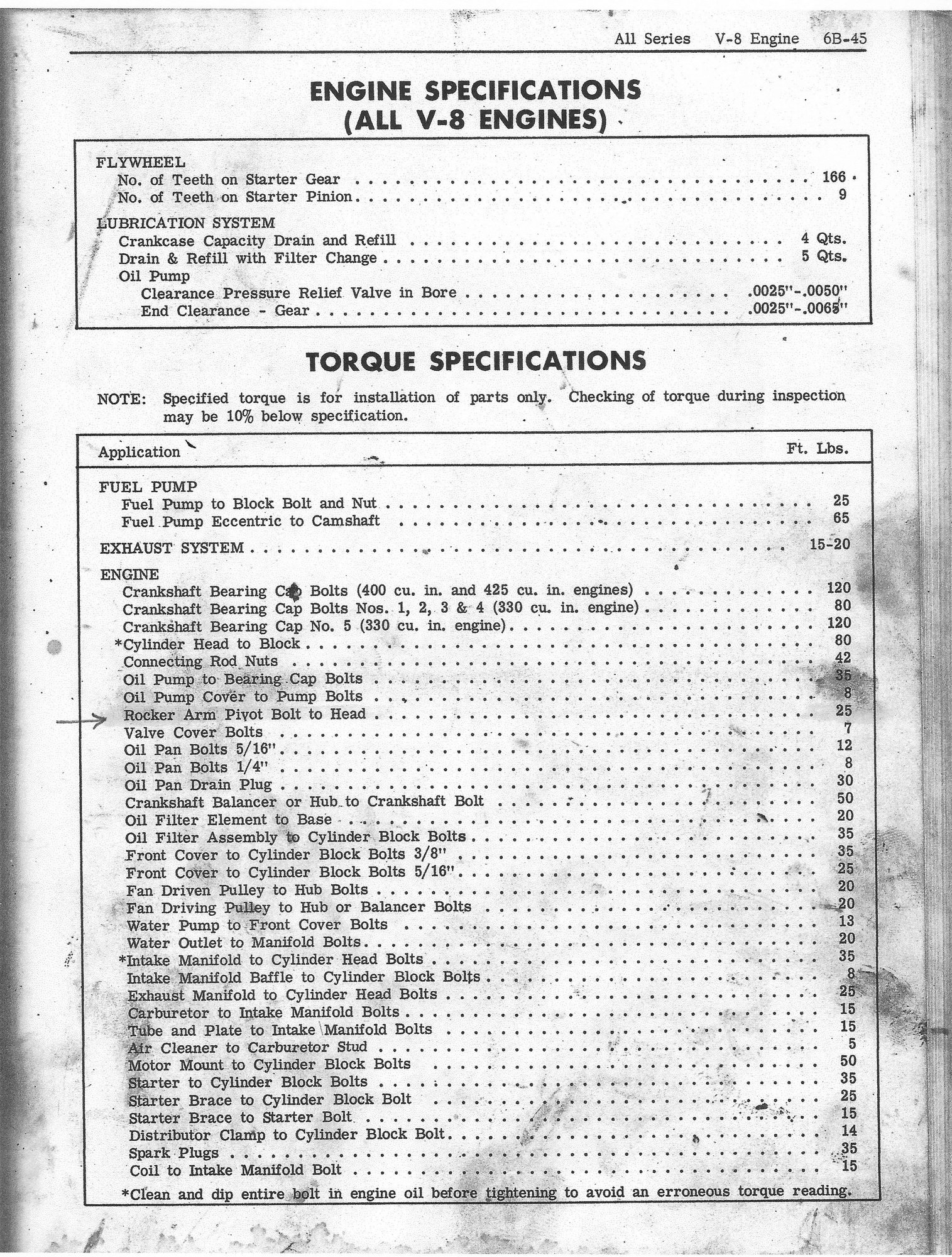

25 ft/lbs torque on those rocker bridge bolts; 35 is for the 1965 "A"casting cylinder head studs. The hard plastic replacement valve stem seals are very difficult to get started over the end of the valve stem. I have always done this with the heads off and on a bench. Just push the seal all the way down on the valve stem, it will find its final location once you start the motor. You may find the valve spring retainers stuck tight to the valve stem locks, a little tap on the retainer from a plastic or hard rubber mallet or hammer will jar them loose.
Right you are! Thanks for picking up on that mistake. The manual is very confusing in this section shown below. What bolts are they referring to in Installation Step 1 I wonder?

Added some more to my previous post for you. The torque specs listed above are actually for the "A" heads with studs. The studs, listed as bolts in step 1, torque to 35 and the nuts, listed as hardened flanged bolts in step 4, torque to 20. For your "B" heads with the one piece bridge, those flanged head bolts should be torqued to 25 ft/lbs as I stated in previous post. Best to do the rocker arm removal and installation with both valves in the closed position, i.e. TDC compression.
I don't doubt you but do you have a manual reference for that? The '66 CSM doesn't mention 25 ft/lbs on the V8 engine rockers anywhere that I have seen. I may just be missing it.

I just want to add that the tool you have will be pretty useless on an Olds engine because there are no real rocker arm studs. You will have to rig up a bolt that might work. its a little more expensive but this type of tool will work better:
https://shop.advanceautoparts.com/p/...483&adtype=pla
Another hint. After 60 years the valve locks tend to get stuck in the retainers pretty good. After you take the rocker arms off take a small ball pein hammer and smack each retainer on one corner to **** it sideways. That will break the locks loose and make it a lot easier to compress the spring. Hers is a pic of where to hit.

That's really good advice. I will keep this in mind for sure. The manual shows the tool has a bolt that helps you compress the springs. I guess I could rig up something similar, welding some threaded rod together.......or try the spring compressor you show.

The main problem with the tool you have is that it almost makes it a two person operation because you have to hold pressure on the spring while you try to get the keepers out. With the tool I showed its a lot easier by yourself. Get a small magnet too. That makes it easy to grab the keepers. If you have an automotive machine shop near by see if they will sell you set of new keepers. They are very cheap and I always replace them. I buy them in boxes of 500.

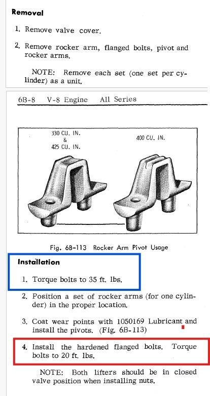

I don't have the 1966 CSM; the torque info I supplied comes from the engine torque chart in the last pages of the V8 engine section of the 1967 CSM. You can verify that the flange head bolts specified for the 1966 V8 engine is the same part number as that specified for later V8 engines thus torque value is the same. Scan of page attached.
__________________
1966 Oldsmobile Toronado DeluxeLast edited by ourkid2000; Oct 29, 2025 at 12:57 PM.
Thanks so much! Looks like you and I found yet another problem in the 1966 CSM as it doesn't show the TQ specs for the Toronado rocker arm pivot bolts. Before anyone says to check the Toro Engine section, I did. There's no TQ values listed for those parts, only specifications. According to the '66 CSM, all V8's had rocker arm studs.

Double checked, same PN for '66 to '73 rocker arm pivot bolts so TQ value for '67 should be the same for '66.

Regarding the errors you have found in the 1966 CSM, they most probably are just left overs from the previous year CSM that weren't caught prior to publication. There should be dealer service bulletins generated to address them. I'm sure at least one of our members would have a copy.
Old Nov 2, 2025 | 09:35 AM
  #38
ourkid2000's Avatar
Posts: 1,219
From: Nova Scotia, Canada
Well would you look at that......sheesh, unreal. Good call! Not a TSB, it's in the June 1966 Service Guild:
