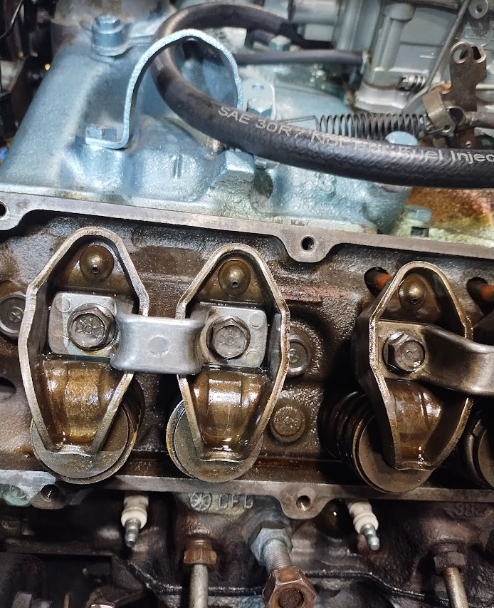

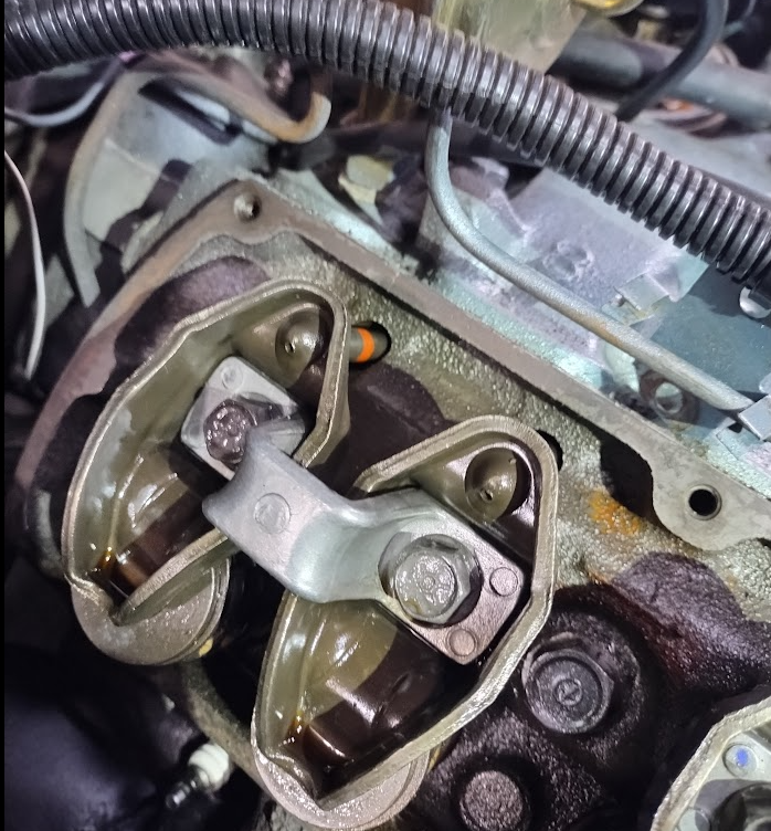

80,000 miles on the engine and extremely clean under the valve covers ( I think anyway). See my pics below that I took before I put the valve covers back on.

Clean and at 80K, my position is to plan on replacing the chain and gear set but I wouldn't hesitate to drive it; however, it would be best not to run it extra hard. If the engine was 10 years old with 80K it would be a different story but the concern now is the age of the nylon teeth on the cam gear causing them to break off.
Old Mar 7, 2026 | 06:18 PM
Posts: 15,395
Interesting to see the A.I.R. tubes in the heads for what I guess is the California emissions system. Not something I am familiar with.
Oh man, they're such a pain in the ***. I had to remove the exhaust manifolds recently and those buggers made it so much harder, especially on the passenger side where there's less clearance. The front of the engine, on the driver's side, is just full of pipes, checkvalves, and hoses for that system. I'd really like to get rid of it.

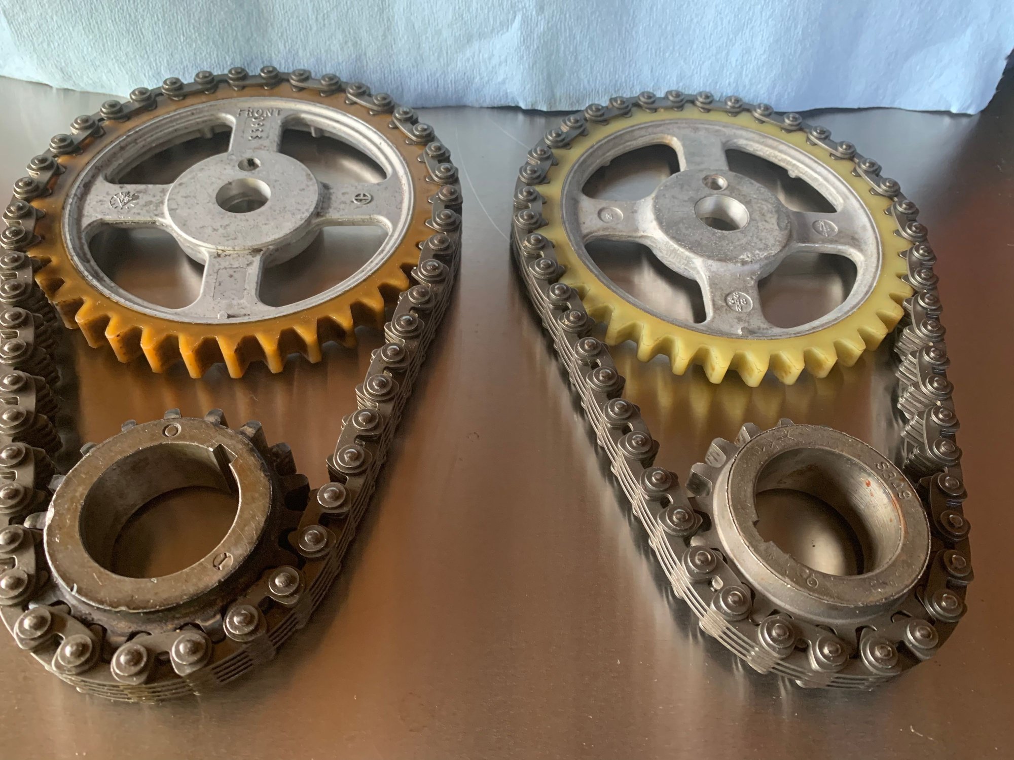

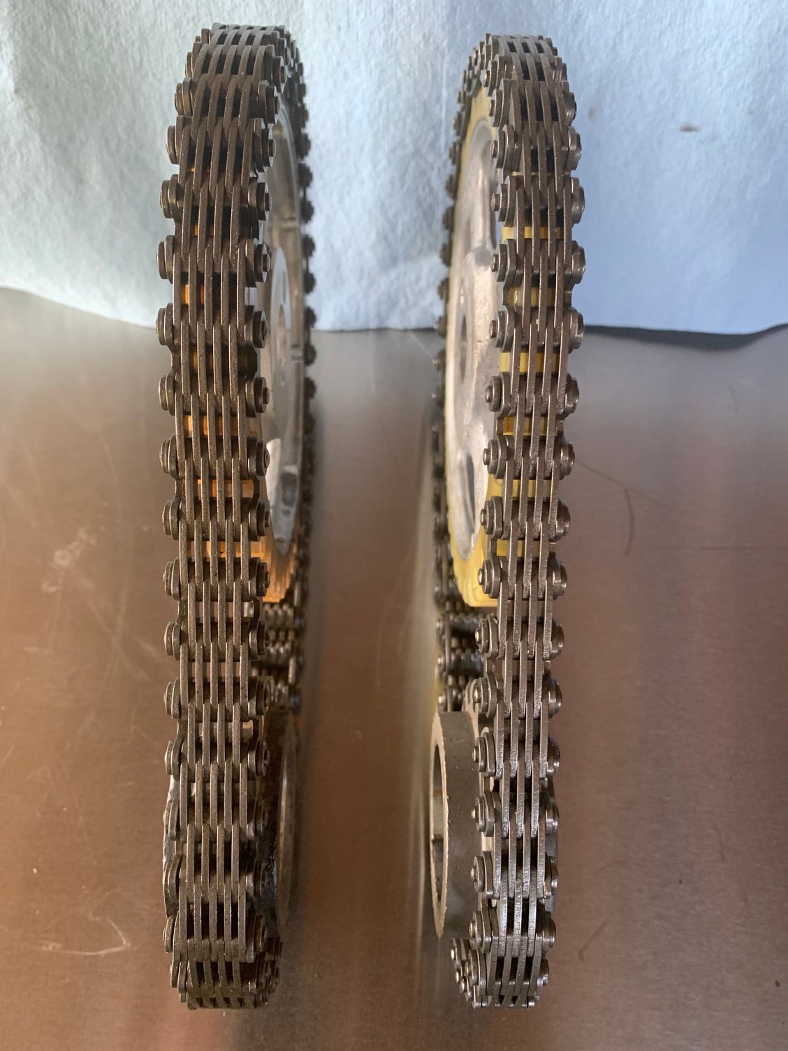

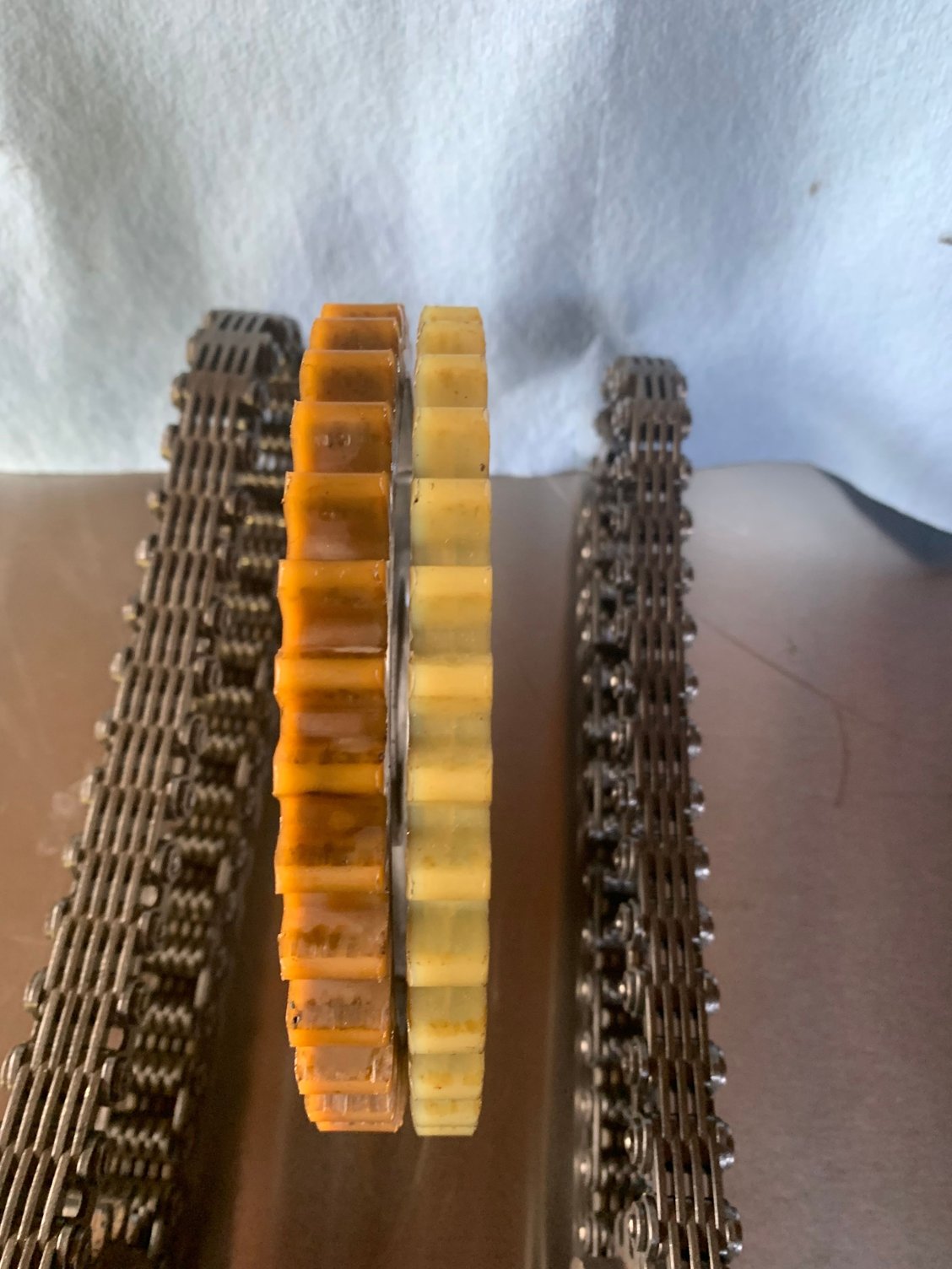

I’ve only ever found the wide sets on Toronados. they were never apart either. Here toro on left and the normal on right
Old May 12, 2026 | 11:45 AM
ourkid2000's Avatar
Posts: 1,280
From: Nova Scotia, Canada
The Tornado got the extra wide timing gear/chain set.
That would be cool but they're supposed to be the same as the other Big Blocks. Maybe they're all bigger in that group? Never know though, lots of weird differences in the Toronado world. Maybe I'm missing something.
