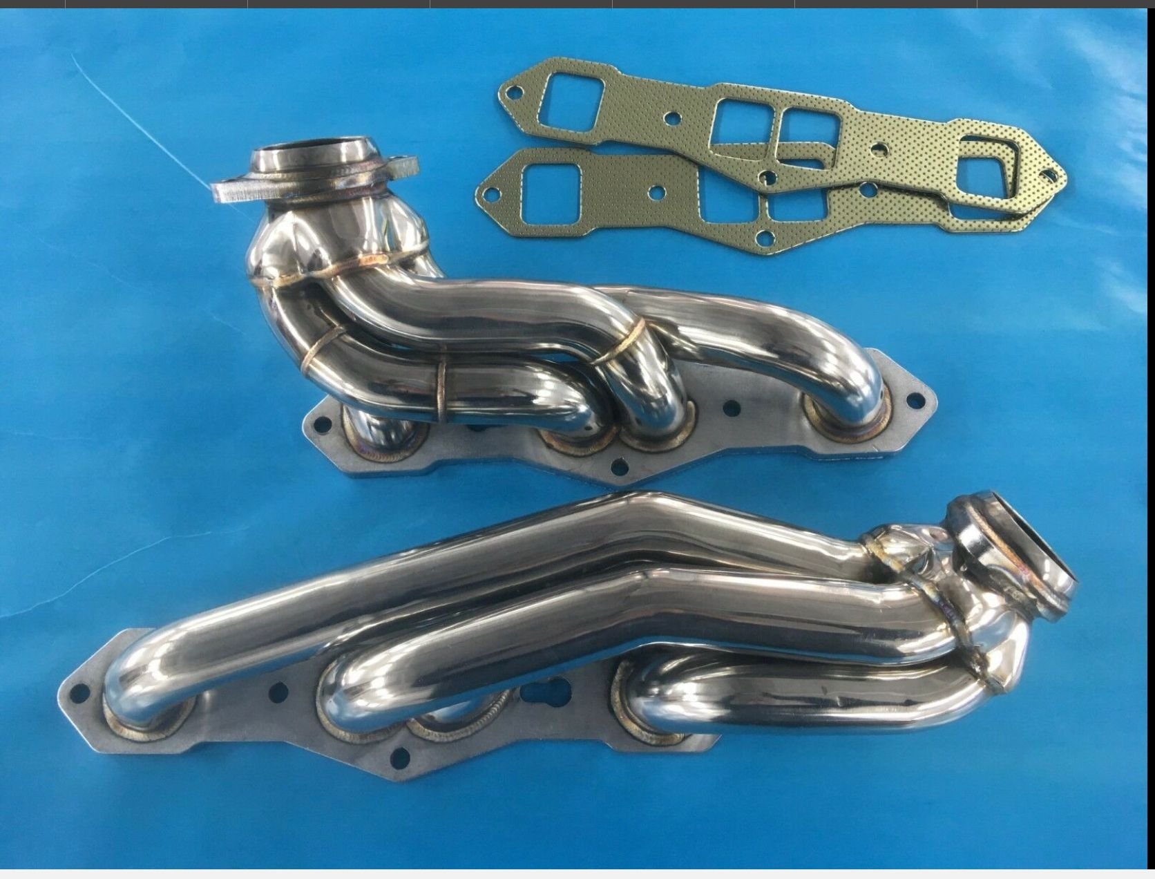

Has anybody used these? They are expensive but are impressive looking. That is some of the best welding I have ever seen.
Sorry I could not get the image any bigger. Here is the link.
https://www.ebay.com/itm/38449649061...53.m2763.l2648

Here you go Glenn
i have them and im very happy with them .The price has gone up considerably since i bought mine a coupe years ago

Thanks guys. I am wondering how much HP I would pickup on my stock 75 Hurst Olds. It currently has true duals on it now with stock manifolds. The right manifold has a slight leak now and is missing the middle bolt in the manifold. I doubt I will spend this much but these headers are really attractive.
The manifolds are well made, easy to install ,and look good but I don’t think you will feel much of a difference in hp.

Thanks Jeff. For the money and work required I think I will stick with what I have.
