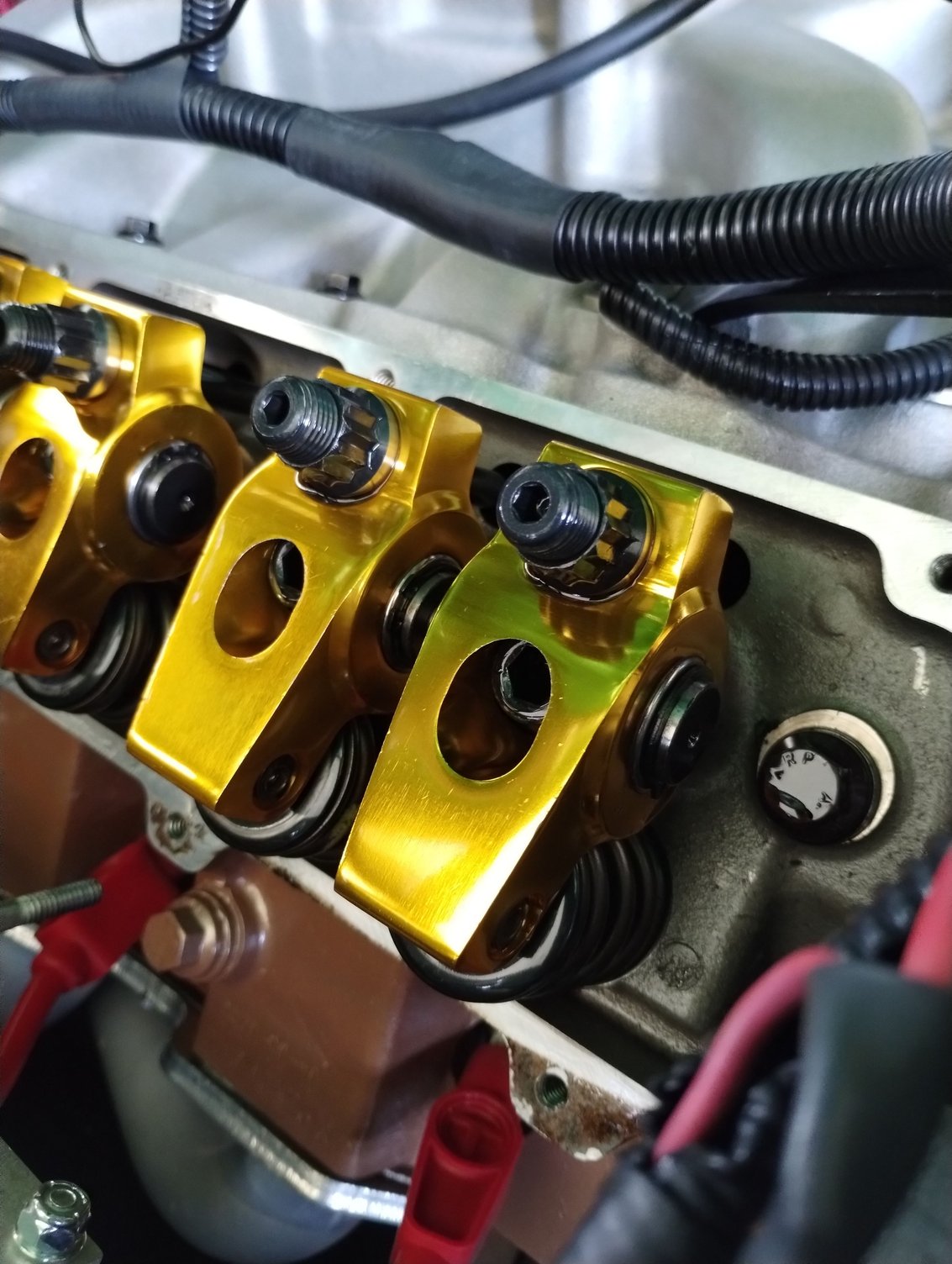

Have a question regarding getting enough oil to my top end with these rocker arms. I'm not sure if it's my specific combo but I checked my pushrod length seems to be correct. The adjustment screw on the top of the rocker arm only goes in this far when adjusted correctly I'm not sure the oil is getting to the oiling hole in the rocker arm as it needs to be. Car seems to run good but I do have that sewing machine sound around 1500 to 1700 RPM. I'm really not sure what it is about my setup that makes the adjustment screw only go in as far. Engine is an e-block with 921 lifters and speedmaster aluminum heads.

Looks like you’re at the end of the adjusting nut travel. It needs to be in the middle of the travel for best oiling. Just an fyi.

The slot with the oil hole in the adjustment screw is in the rocker arm .I'm just not sure if it's enough. Oil still comes out of the top of the rocker somewhat but I didn't know if it was enough. Pushrods are 9.7 long and seem to be the correct length given the marks on the valve tips. Everything is adjusted to 0 lash plus 3/4 turn.

The geometry in this rocker doesn’t change with pushrod length. You need shorter pushrods to bring the locknut down.

If I use shorter pushrods won't it move the rocker to far up the valve tips? Also how much shorter would you recommend I go. I originally checked with adjustable pushrod and 9.7 left the following marks on the picture posted.

No, the shaft mount dictates geometry on these.
I’d go at least .050, maybe even .100. Try one and see if the adj nut ends up more in the center of its travel.

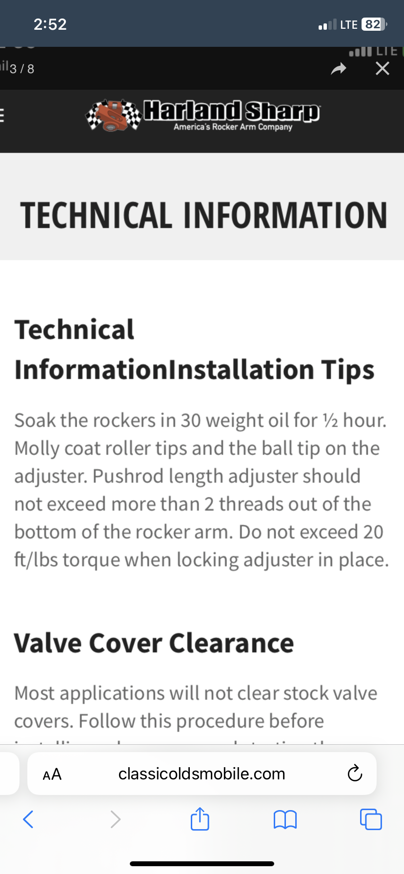

absolutely not. no way should the adjuster be halfway down it’s travel. it should be 1 to 1.5 turns down from full up. …2 turns down is the max on this style of adjuster.
your fyi is bs

The last set I used had the best oil hole alignment with the adjuster about in the middle.
It’s a simple observation to check one way or another.
then you screwed something up. I posted the correct way to adjust rockers with the adjuster at the pushrod cup. All manufacturers are 1 to 1.5 turns of down from full up including lash or lifter preload, Speedmaster says the same.
the way you say to do it could expose the feed channel and block oil to the rocker. not only that, when the adjuster is that far down, it means the P. Rod is to short, that does affect lift over the nose of the lobe and creates a bad angle at the cup/rod tip
I can post as many manufacturers links to the correct way to set the adjuster as you need..speedmaster, T&D, Harland Sharp ..which these are a copy of and others.
to the original poster. do it the right way.

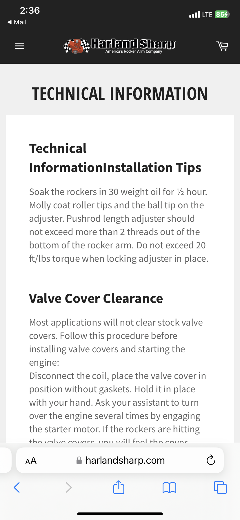

I just got off the phone with Mike@ Harland Sharp. It seems we're both right, or wrong on the HS's at least. Yes they RECOMMEND 1.5 turns or so from full out. BUT if you turn them in even as much as 3 or 4 turns, no harm done. Just so long as you have full engagement of the locknut they're fine. I'll bet SM is the same way.
In fact HS also makes another rocker with a slightly different adjuster that actually requires them being in more towards the bottom of the travel. Go figure.
As far as pushrod angularity goes, you know it's more critical on a shorter pushrod, like a small block. When you're using a pushrod that's already 9.500 or so like on a big block, another .050 or .100 won't effect it nearly as much.
Finally wideband, I stand on my previous statements regarding the same. Find one person that regrets purchasing and/or using one. Maybe then I'll change my hard sell approach. But I still don't call people idiots or say 'they don't want to learn" like you do, repeatedly.

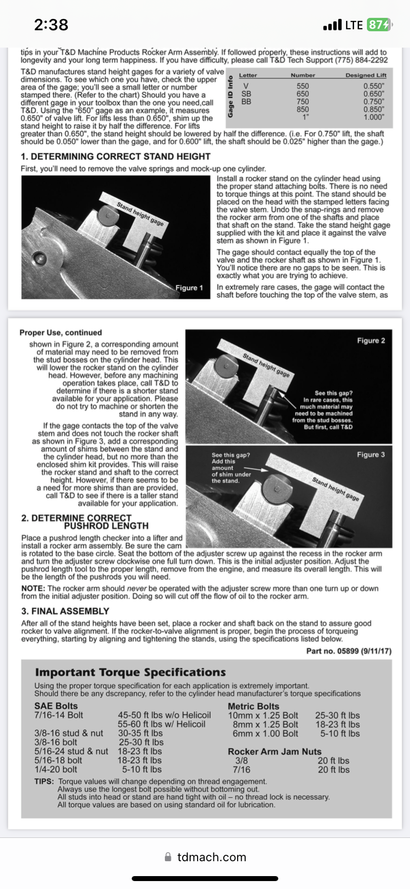

no again..Harland says 2 out max. same with everyone else. read what I said again about where length makes a difference…it’s near max lift, over the nose..that’s where the angle gets goofy, lift suffers when the adjuster cup is to far out.
if you’ve ever check with a dial indicator, you would know that. here, learn something. Harland specs , T&D and PRW which is speedmasters .

No, Harland says 2 or MORE, right from their tech guy.
Just because it’s not in print, doesn’t mean you can’t do it, or vice versa.

it is in print…look at the first pic I posted. that’s from them..2 max dufus…1 is best.
get help.😂😂😂😂. keep digging that hole. you’re a clown show

Should NOT exceed more than 2 turns out.

Yep, 2 turns out of the bottom is more than mine ended up at. So maybe it wasn’t exactly halfway, but I’ll bet it was close. That adjuster has a lot of travel.
They also say no more than 340# open pressure on their 50026a rocker setup. Call them and ask what they’ll really take, by guys doing it everyday.
Again, I’ll defer to my way, calling and asking tech directly, you do yours, simple.

you obviously don’t know Mark..he’s the negativity king here. he just hates it when someone points out his awful advice. he could have just stopped ,, but he didn’t. he continued to challenge me …even when I provided the correct information,,he kept it up. then he plays victim
here’s some more negativity to chew on. this is why the manufacturers say don’t go beyond 2 turns and ideally 1 to 1 1/2 is correct. If you go halfway like Mark said, the oil feed channel in the adjuster will be out of it’s alignment with the oil feed supply hole
to the fulcrum bearing…it will be starved of oil .
this is a T&D rocker I have here. You can see the channel in the threads and the internal oil feed hole in the body by the toothpick. the bottom pic is the adjuster at 1 turn out. If you go way past 2 turns down, like halfway, the feed hole will be blocked by the threads.

Dale, call Mike at Harland Sharp. According to him we’re both right, on the HS stuff. I won’t speak for anything else.

I just wanted to let everybody know that I did indeed need a shorter push rod. The magic number for me was 9.6 in long. I adjusted all my valves and fired the car up with the valve covers off and I now have plenty of oil coming out of the rockers. I really do like these rockers they are an awesome setup and yes they are 7/16. I don't believe they make them in a 1.7 ratio, that would be pretty nice though. Thanks for all your help.
no Mark, I don’t need to call anyone to confirm anything. this isn’t complicated…three times now you’ve changed your mind and response, from “you have to be halfway down”, to “two or MORE” to then desperately trying to agree with me which you didn’t
my initial response is correct…and inline with all rocker manufacturers adjustments on this style adjuster because the cup shouldn’t be screwed way out of the lifter body for a reason..
not only will it mess up the feed hole alignment, it will screw up the over the nose ratio/lift because then cup is way lower than it’s suppose to be…that does change the rocker ratio when nearing max lift/over the nose

no.. all of these style adjusters need to be adjusted from full up..then 1.5 to 1.75 out…including lash or preload…never go beyond 2
that’s it.
then measure your p rod length at that setting. There is no bickering.
I’ve posted the adjustment procedure from three..I can post ten more if you want..it’s all the same
