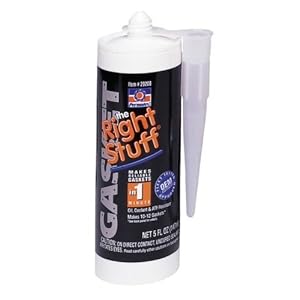

Cut off the ports of the old turkey tray gasket to use as an oil shield. Buy composite gaskets. I used these on mine: Mr G# 4695G
http://www.jegs.com/i/Mr.+Gasket/720/4695G/10002/-1
Forget the rubber seals. Dimple the end rails like ah64pilot showed. Lay a bead of the "right stuff".
If you mask off the front edge of the block and manifold, you can smooth off the squeeze out and make a nice bead.

I never use the frount and rear gasket on an aluminum intake." The right stuff" is the hot lick. Lay it out 1/4 inch thick and sit the intake straight down on it. Never dimpled it either, but that might be a good idea if using the rubber gaskets.
No gasket, just an o-ring, but I don't know size. Match up the old one, or reuse if it is not torn.
