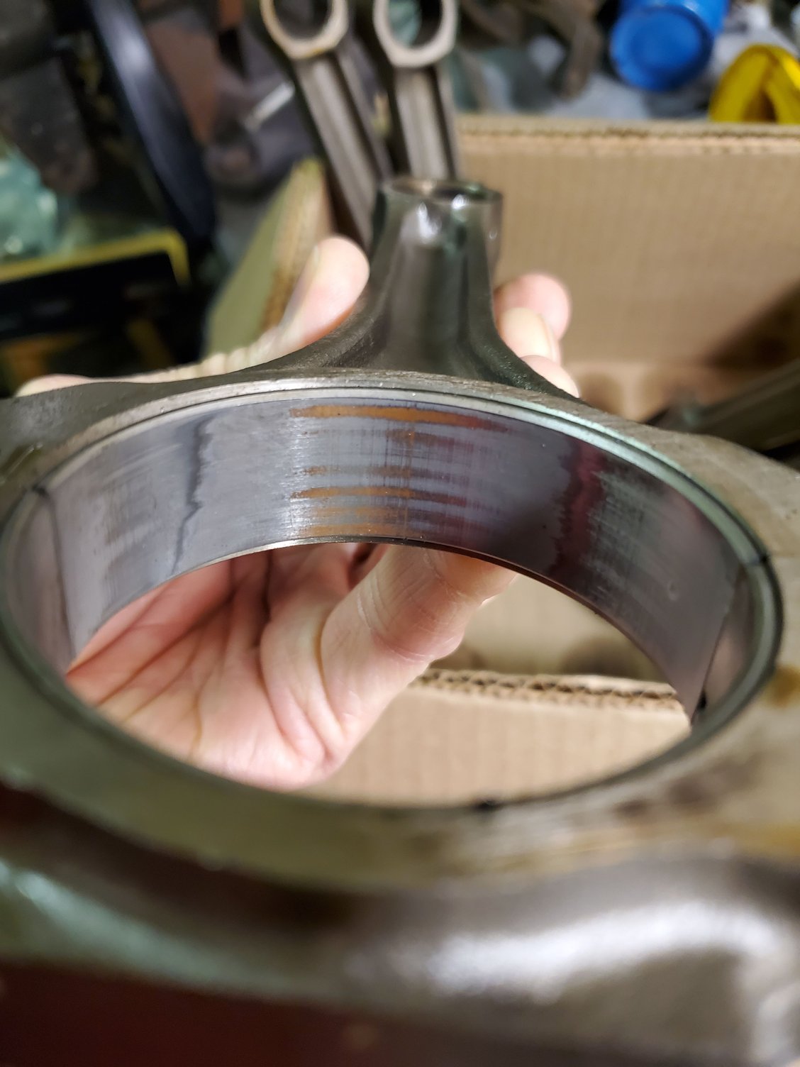

Something tells me the crank was not rebalanced on the previous build. I don't see any drilled holes that look fresh on crank or flexplate. And my rod bearings looked hammered.
All 8 look like this on the top.

If it’s balanced on the light side, it tends to beat the wrist pins and bearings out of it, kinda like your picture. Have it rebalanced. It may not have been done correctly in the first place. If it’s not done now, you could be making it even worse.

If you rod bearings are worn on the top side like that it can also be detonation. In my opinion balance issues are going to show up more in the main bearings than the rods.
