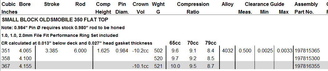

If you go .030 over you can use the Mahle 350 4.155 pistons (.030 over stock 4.125 bore) This will give you floating pins and require the rods be honed for the .984 pin.
Running these pistons/pins drops a total of 4.5 lbs over the stock 425 pistons.

Joe looks like the MAHLE product uses a larger pin .984. Wonder why. I see factory 350 and 425 share same same pin size .980.

Mark can answer that question for you.

And the Mahle pistons come with .984(Mopar) pins because is it allows the shop to hone the rods for the exact right fit, whether it be for a floater or press.
