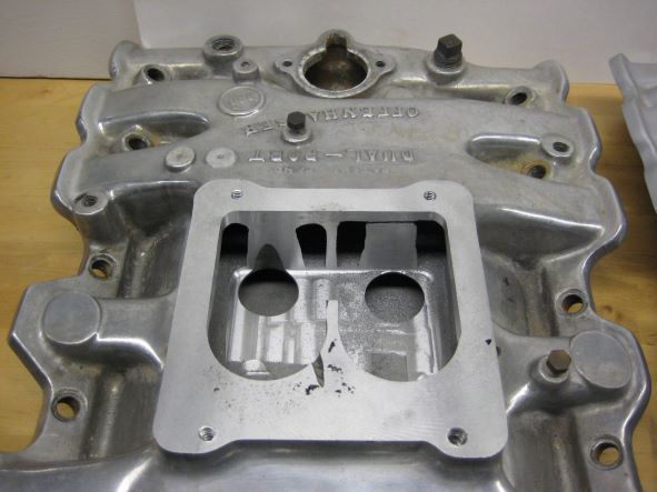

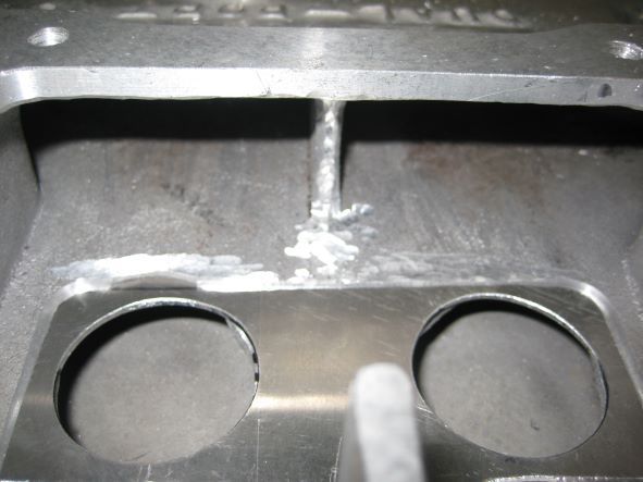

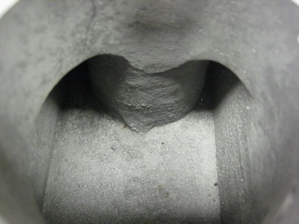

I do run a highly modified Offy Dual Port intake to get better street manners out of 468 Olds, but I modified the hell out of the intake to get rid of the restriction to the front secondaries because I didn't want to sacrifice mid to high rpm performance. I called the old retired Offy engineer (since passed) who designed it and talked with him about the restricted secondaries and how it might be fixed. He said they had plans to make a "race version" that changed the way they routed the front secondary runners but things didn't work out.
Here are a few shots of how I modified an Offy Dual Port to get rid of the restrictive secondaries. I put way too much time and money into it and wouldn't recommend it unless you like to make aluminum chips. Never got it to a dyno but seems to do the job. Tamed down the idle and cruise on a big cam and improved low end torque versus the Performer on it before. No noticeable loss in high RPM performance up to my TH400s 5100 rpm shift point.
Spread bore Offy Dual Port before mods
Restricted secondary runner to #1 and #3 on the spread bore, restriction is worse on the square bore version.
Cut top down and mill out the primaries and remove secondary plenum divider wall between the primaries to open up flow area.
Restriction to front secondaries greatly reduced by creating open plenum for secondaries, no longer split left to right.
Used thin wall tubing for full inside diameter primary downlegs. Cast primaries were 1/4" thick before. Cut new top plate to match.
