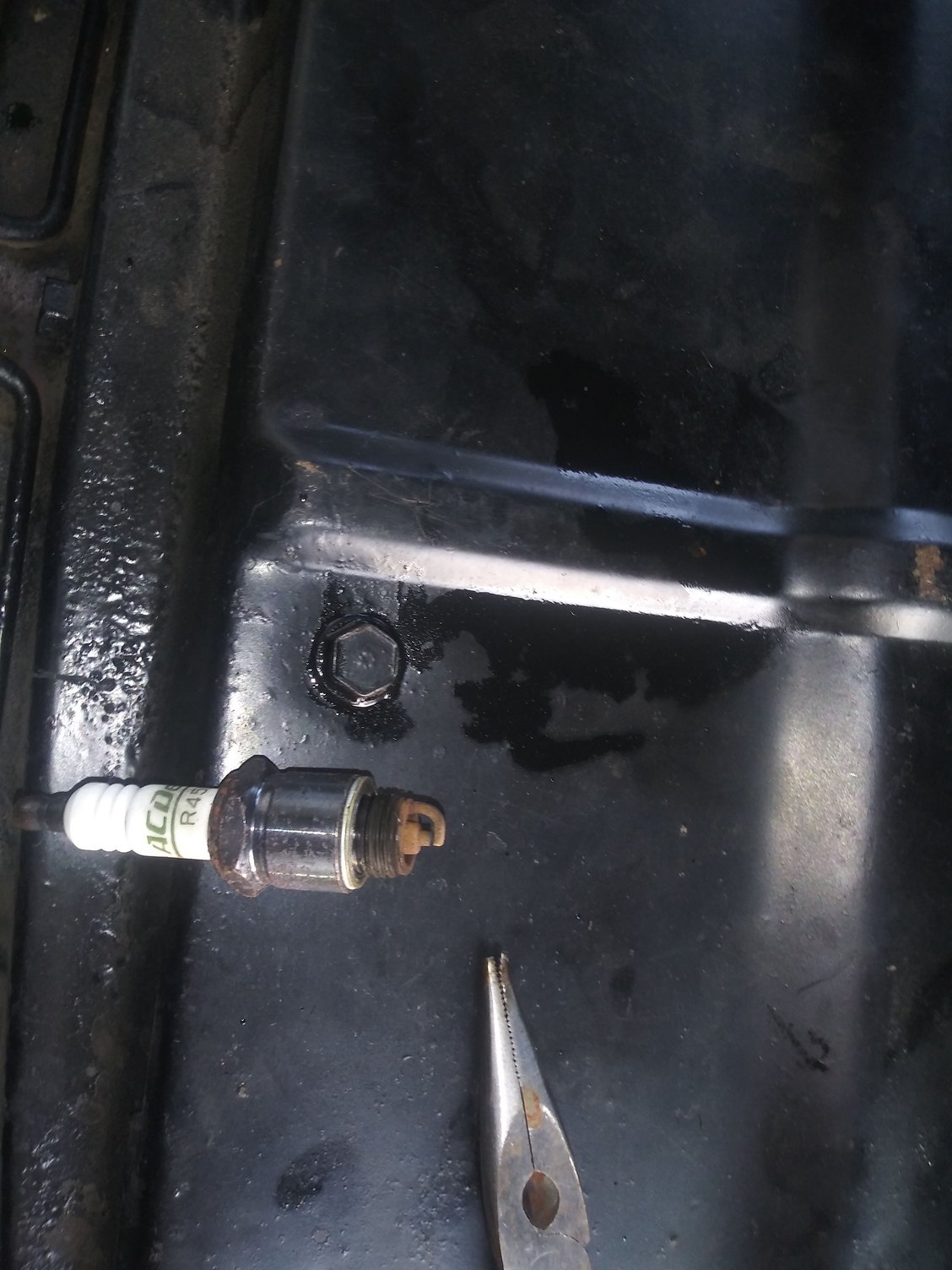

I took my cutlass out last night and when I got home it seemed to be smoking a lot, but it was dark and couldn't really tell. Today when I got home I checked the oil and didn't see anything out of the ordinary. I checked the coolant and it was down a half gallon and it usually doesn't go through coolant. I topped it off and started the car. I noticed it had a uneven sound when I was cranking it over-loss of compression in one or more cylinders? It was smoking, white smoke but not really unusual when cold. I took it around the block and when I got back it was smoking pretty bad. At first it was the drivers side only, but started to smoke out of both sides and was idling rough. There is a bit of smoke coming off the header on the drivers side, but I couldn't tell from where.
One of the plugs.
I didn't hear any unusual noise, so I'm hoping nothing in the bottom end. I checked the drivers side spark plugs and there wasn't any oil or unusual deposits. I'm thinking it's either a cracked head or blown head gasket, but the oil was not milky. The tailpipes are wet, but not oily. Any idea what might be wrong?

I would not run it anymore either. If you are getting enough water in the cylinders you take the chance of bending a rod. Also by the looks of that one plug you need to pull the head and clean and oil the cylinder wall asap so it doesn't get all pitted up.
yeah, I'm going to try to have it torn down ASAP.
