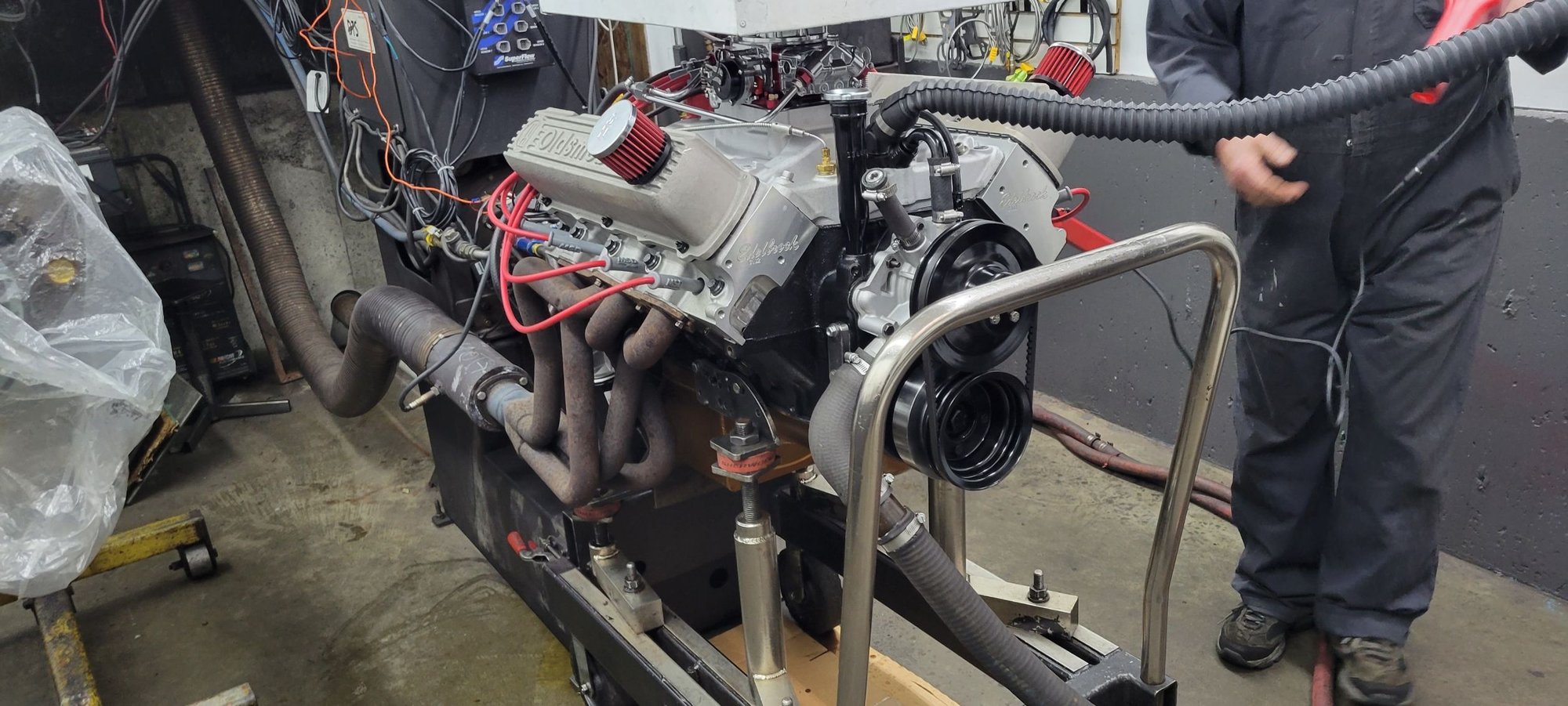

At long last we got my engine on the dyno and I got to hear and see it's thunder! Specs are below...just for fun, what kind of power do you think it made?
1969 455 bored .030 over using a stock CN crank running 10.1:1 compression.
CP Bullet Pistons
Scat H Beam Rods
Quick Fuel SS 850 Carb
Edelbrock Performer RPM Intake
MSD Ready to run distributor
Harland Sharp 1.6 Rocker Arms

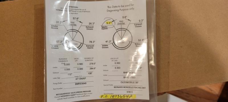

Hydraulic Roller Cam with 4/7 swap Intake .560/278.6 Exhaust .566/284.6
Edelbrock Heads (newest version) blueprinted by Bernard Mondello
It made it's best power at 32 degrees timing. Dropped a couple HP and torque at 34 degrees.
Dyno Pull:
Adjusting Timing (Inside the dyno room for pure engine rumble!):

We got 504 hp/570 ft lbs from it. I'm not sure where the "missing" 16 hp might be but I'm not worried about it...the numbers exceeded my expectations so I'm happy.
You'd have to ask Bernard what work he does to the heads. We talked about it but a lot of it went over my head so any attempt on my part to describe it would be misleading.

I talked to Chuck today and I asked what size headers he used, and he said 1 3/4" primary diameter, due to Dyno cart fitment when 1 7/8" diameter headers should have been used... That's worth 20 + HP with this combination!!!

Thanks, Bernard! I was going to suggest that could be part of it...the good ceramic coated headers are the same size but at this point I'm going to sacrifice the HP and run them until I can afford some ARH units.

Did anyone check true TDC with that balancer? I’ve seen some off as much as 6*.
Looks like a regular Performer, not an RPM? Or am i seeing things?
And i made the 520 I mentioned with 1 3/4 headers as well, blowing thru 2.5” pipes and mufflers. But it looks like a DTS Dyno. I’ve known those to be a bit conservative anyway. Plus I’m guessing Howard’s lifters as well?
Good job though.

Edelbrock Performer RPM Intake as stated?
This engine has an Edelbrock Performer intake manifold, not an Edelbrock Performer RPM air gap intake manifold...
The standard Performer, definitely doesn't perform as well as the Edelbrock RPM air gap manifold!
BTW. The engine sounds really good and solid... Chuck was very happy with it's performance!!!

You're right...not sure why I was thinking it was an RPM. Too much junk rattling around in my brain box these days :-D
So was I! Definitely surpassed my expectations and I'm thrilled with the outcome. Many thanks to Bernard for setting me up with the right parts and staying in contact with my builder throughout!
CP Bullet Pistons
Scat H Beam Rods
Dyno Pull:
https://www.youtube.com/watch?v=gYaCWEQZnWc
https://www.youtube.com/watch?v=5cqOm5pIlO4
