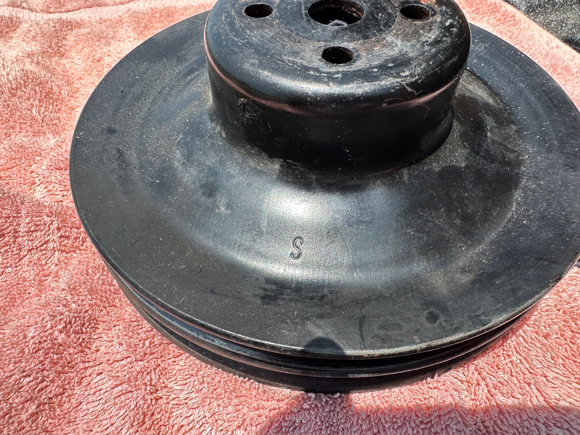

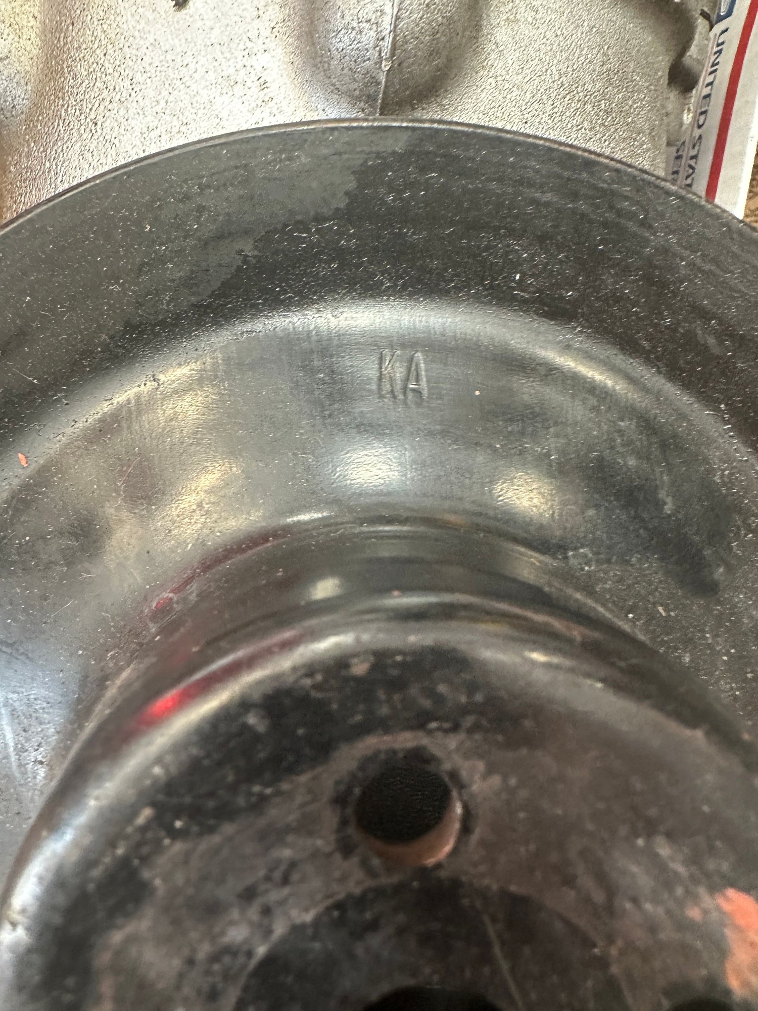

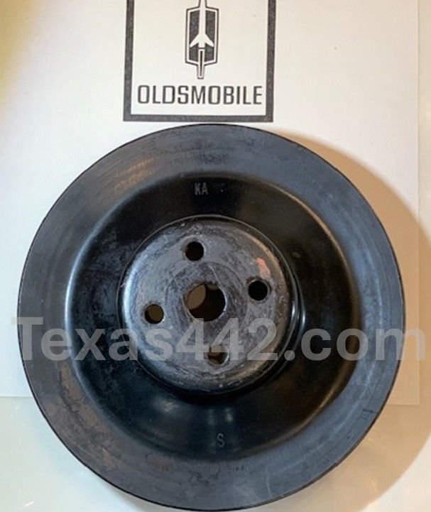

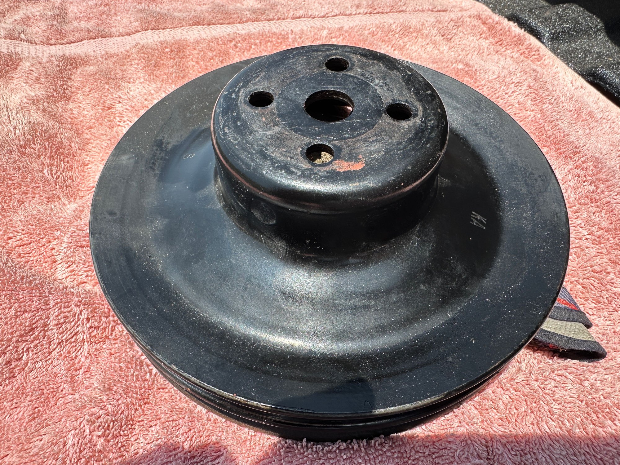

YES YES I know this thread is a million years old
I stumbled upon this “KA” water pump pulley. It also has S stamped in the bottom side. How can I tell if this pulley is real or re-stamped?

KA pulley
Hey Texas 442, that is the 68-9 W-30 water pump pulley. Do you still have it ?
Yes sir. I am sure they are everywhere also
