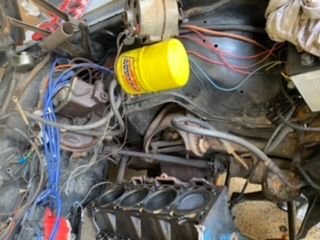

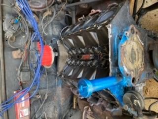

jm-25-28 cam work in this set up
i have a 455 60 over with a torker intake 750 holley c heads 4 speed 12 bolt pos 390 gears

You will have very little vacuum for power brakes.

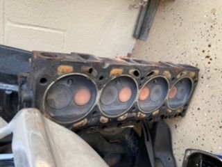

the cam in there is very aggressive comes on at 3000 and above i’ll post the cam # when i get it out the heads in pic are j heads i took off putting the c on with the jm-25-28 cam lifters and springs
