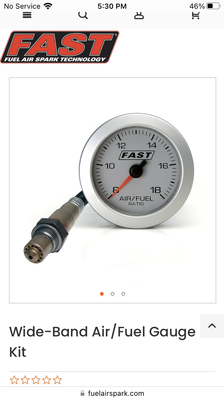

Old Oct 22, 2023 | 02:10 PM
CANADIANOLDS's Avatar
Joined: Sep 2013
Posts: 2,928
I have a FAST dual O2 wide band that has data logging/down loading, playback, max and min peaks , left&right individual or average, test/run file history and other features.
I do not use it for setting idle afr or RPM . The engine tells you what’s correct by gaining RPM.
I’m not impressed with the AEM. I recently helped a guy set up his carb with his AEM. What a pain in ****. No playback..nothing . The things flashing numbers so fast you can’t remember what’s what. During a full throttle run it was going crazy, we tried to record the read outs with our phones but that doesn’t work because it’s just a blur after.
the only thing the AEM was good for was a steady state RPM afr like cruising ..useless for figuring out afr when accelerating WOT throttle or part throttle through the rpm range..even with two people , one driving and another trying to watch the gauge.
im curious to know how you guys use that thing for anything other than steady state RPM?
Old Oct 22, 2023 | 02:46 PM
Ontario69Hurst's Avatar
Joined: Apr 2021
Posts: 37
Having a fast dual O2 sounds like the perfect tool. Not knowing that anything better was available I just worked with what I had. I mounted the gauge on the top surface of the steering wheel column for easy visibility.
As you mentioned steady cruise is the easiest mode to evaluate the appropriate primary rods.
WOT is harder but only because the initial AFR is brief and the AFR number climbs quickly, but catching a glimpse with the gauge mounted high is doable.
With the wideband I was able to select the correct rod/jet combo. Without it I would just be guessing, using spark plug color, gas mileage and whatever other indicators people use.
Old Oct 22, 2023 | 03:29 PM
Joined: Sep 2013
Posts: 2,928
if you’re using the most simplistic gauge out there..why not use analog ? At least it’s not flashing ten times between two full numbers at one decimal place .
this makes more sense than a rapidly flashing number with a decimal point you can’t even see if it’s too fast.
that AEM reminds me of when car companies switched to digital mph Speedo’s in the 80’s..everyone thought that was soo cool..for five minutes. They were crap..drove the driver crazy.
this basic analog makes more sense if you don’t care about play back or any other options.
Old Oct 22, 2023 | 03:32 PM
cutlassefi's Avatar
Posts: 8,487
From: Central Fl
I’ve used those too. But to me I don’t see a difference between digital numbers moving around quickly or a needle that looks spastic.
Just saying.

Drive it with the gauge for a few weeks and with a little patience, you’ll be delighted with how nicely you can make a qjet run. Those carbs were amazing for their day.
