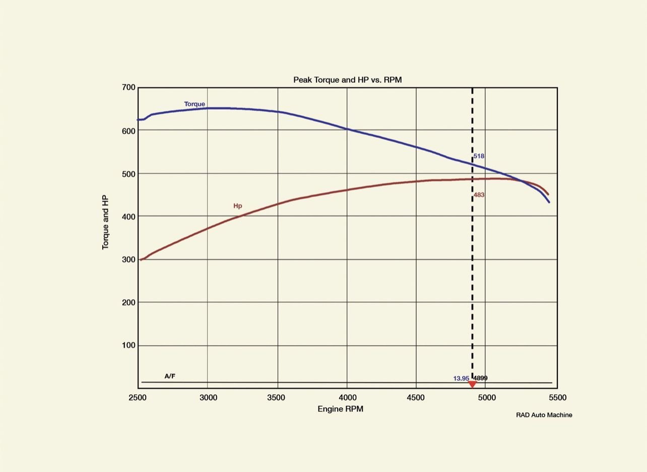

Nice build and torque...but kinda sad HP.
Thoughts?

Maybe I missed it in the article, but unless the engine is going in a big Olds 98 or other heavy car handicapped with 3.08 gears, I’d hope for much better than mid 12s!

My question is: What good is a engine that peaks @ 5000 RPM and starts dropping off like a rock at 5250 with under 450 TQ @ peak HP. I will never understand why people put a 4.500 stroke in those engines. Looks like the shop does decent work though. And BTW who knows what those dyno numbers mean with no test data, numbers could be conservative, although I don't think the power peaks are mis represented.
Can you please elaborate? From the graph it looks like TQ is over 500 at peak HP which they stated was 488 HP at 5000 RPM. The graph does appear to show HP peaking closer to 5200, but even there, the TQ looks to be well above 450. And since HP = TQ * RPM / 5252, at this crossover point, it still looks like they’re about 480.
What I don’t understand is why the HP starts dropping off around 5400 RPM. Are you seeing anything in the specifications other than the long stroke that would explain the drop off?
I think the long stroke aggravates the problem along with inadequate cylinder heads to feed that size of engine combined with a possibility cam has lobes that don't like to REV. Stopping the pull at 5500 RPM doesn't help determine whats going on there either.

Thanks! Your last point about stopping the pull at 5500 is interesting. To your point, something must be limiting the airflow or it is experiencing some kind of fueling problem.

I have a few questions...
1. why would you build an engine that needs to be more streetable and then use a 106 LSA? Bad idle quality, lower vacuum...
2. Why the hell does this engine drop off so fast and so low? The 4.5 stroke and 4.185 bore is NOT inherently a bad configuration at all.
My 496 pulls well beyond 6200(I shift well below that)
Is it low lift? Bad head flow?
-peter

250 CFM @ 28" = 500 HP on a street type build, at least thats what I see.

The head has no where near the cross sectional area it needs for 500 inches, so lets say it did have the cross sectional area maxed out (porting) which still isn't enough, then theres the valve size, this now becomes the choke point, ok so we put a bigger intake valve in there, actually how do we do that, theres a 4.185 bore, it won't fit, so making a Olds 455 with its 4.185 bore 500 inches IMO is a bad combination. I've always wanted to build a 425 my self, much more suited to production cylinder heads, and would certainly make more HP per inch. Question: Which combination has more TQ at the tire?
1. 500 HP @ 5700 RPM 580 TQ @ 4000 RPM with 1 to 1 final drive ratio and a 4.30 rear gear
2. 500 HP @ 5250 RPM 620 TQ @ 3500 RPM with 1 to 1 final drive ratio and a 3.73 rear gear

If your looking at peek numbers #1. What your not considering is the use of the engine. Peek numbers mean nothing. Now you just hit on a subject that you should expand on. Port designs. You can see in the published curve for the engine that the ports are too small or something in the valve train is wrong.

with 650 TQ that low it will have no problem moving the heavy boat it’s going in. The 236 int duration and .515” lift is why it’s signing off so early.. that’s really mild for 488 “
I’ll bet if they added 1.7 int rockers it would pick up 30+hp and TQ too.
