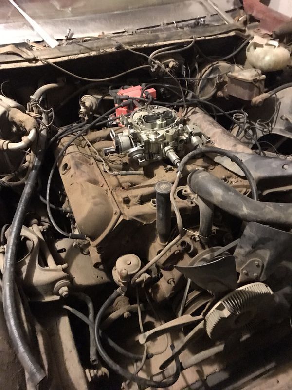

here they are on my 73 Fa 455

Not so sure that is a '73 if it matters. Can't see an EGR valve but the picture
​​​​isn't the best angle, the oil fill tube looks like an earlier breather style, no PCV valve, the fuel pump doesn't look correct and IIRC it should be blue in color.
Good luck!!!

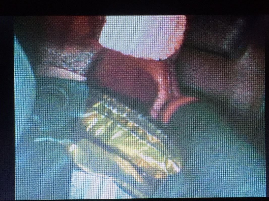

whatever Sugar Bear, I just thought id help if I could, Fa block and engine vin stamp is 33m345114- inspection camera pic

I am sorry but I have no idea what I am looking at in this photo
Good luck!!!
Well that could work in my favor. Waiting on casting photos from seller.
Good luck!!!
It also has HEI so that has been upgraded.
