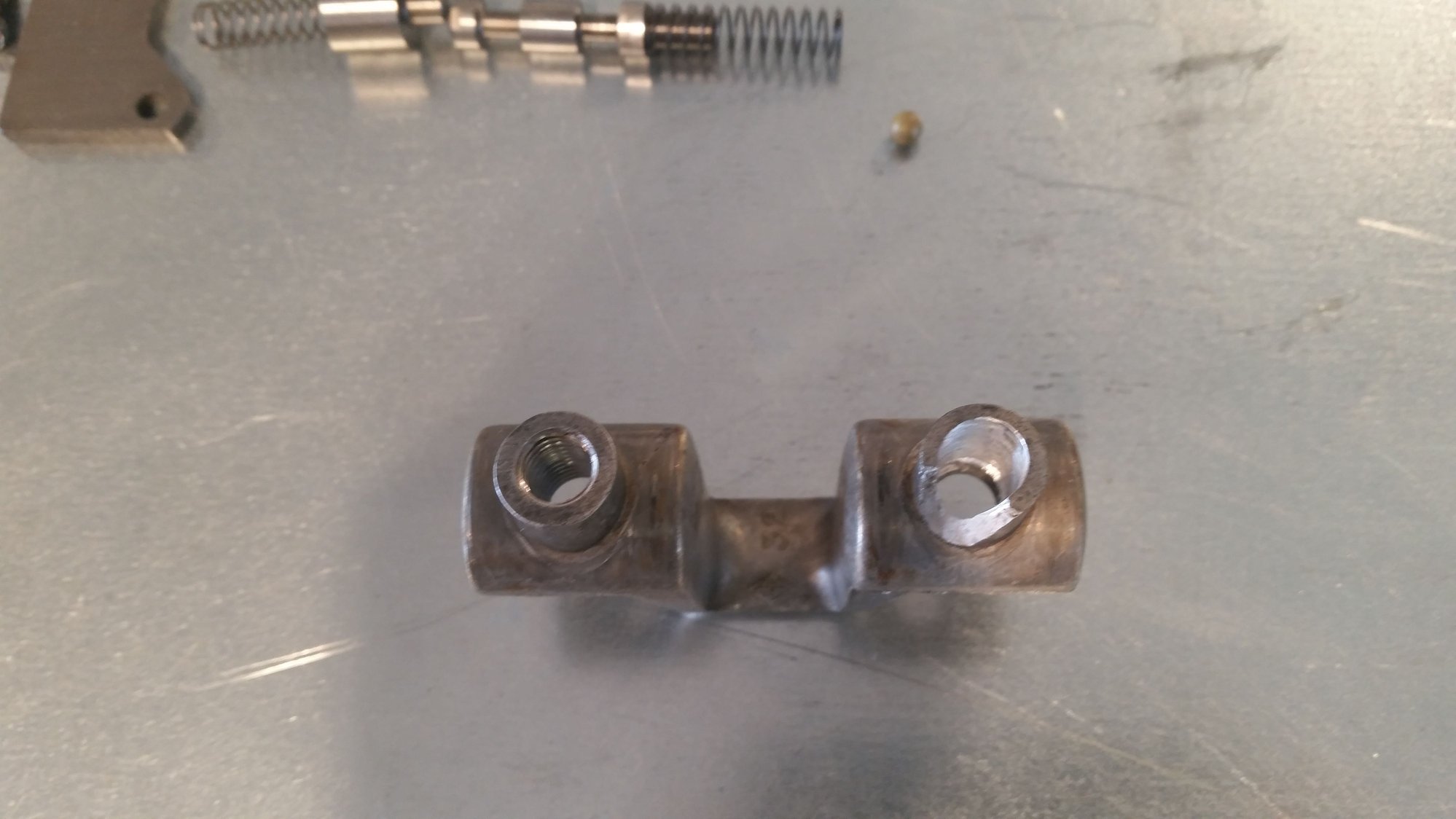

Old May 27, 2016 | 12:31 AM
STLCRZY's Avatar
Posts: 296
From: Germany
Drilling hole for 3/8" is not an option! Like 64 Rocket say not enough Material- (to be safe)!
But let me know if this is an option: 3/8 thread drilling in pedestal
