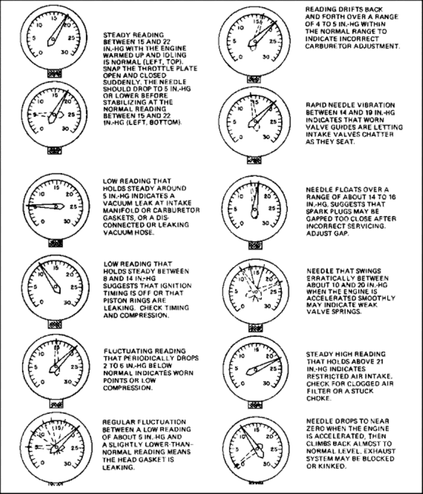

If you have access to a vacuum gage, connect it to a manifold vacuum port with engine at operating temperature, choke fully open, distributor vacuum line plugged, and watch the reading at idle.
Steady 17-20"Hg vacuum reading at idle is great. Cam specs can affect idle vacuum.
If the vacuum reads steady low, 12-15"Hg, good chance the timing chain has stretched causing valve operation to be off.
Steady low 15-17"Hg indicates an ignition timing problem. Adjust distributor timing for highest vacuum reading at idle, taking detonation into consideration.
Steady low below 10"Hg indicates a significant vacuum leak. Usually intake manifold or brake booster.
If vacuum gage is drifting or fluttering it often indicates burnt or sticky valves or a plug misfire. A smooth drift from low to high reading can indicate a carb or mixture problem.
If everything checks normal, reconnect the distributor vacuum advance and see what engine does. Possible the advance is coming in due to small fluctuations in vacuum and changing idle speed on you.
As you see a good vacuum gage is one of the most useful diagnostic tools you can own. It can help with ignition timing, idle mixture and troubleshooting why vacuum operated stuff doesn't work.

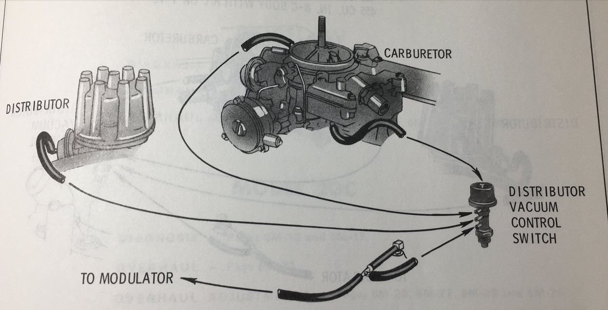

While explaining operation of the DTVS to a new user in another thread, occurred to me that if your car still has the DTVS it could be switching distributor vacuum advance between ported and manifold vacuum at idle. This would definitely change idle speed.
Someone else on here was having that issue because his coolant temp was running borderline of the point the valve switches from port to manifold vacuum, 235° or so. If you have a temp gage see if coolant temperature has any effect on when this happens.

Distributor Vacuum Control Switch = DVCS

At 195-200 DTVS shouldn't come into play but it's one of those things that helps to know what it does and how it works when you're chasing rabbits on an emissions controlled engine.
Distributor Thermal Vacuum Switch. It's at front passenger side of the intake in the coolant passage the thermostat rides in.
It will have 3 or 4 vacuum lines depending on year. Each port is marked what it goes to.
C for ported vacuum source on the carb
M for manifold vacuum source on intake
D for distributor vacuum advance
Around 235-240° it will switch distributor vacuum D port from C (ported vacuum from carb) to M (manifold vacuum) source. Idea behind this is if you're stuck in traffic or other extended idle period, manifold vacuum can advance the distributor to help cool the engine.
Some years have V for vent to the back of the carb air horn, right next to the choke hot air tube fresh air source. Don't think 72 had that but you don't have the factory carb so makes no difference.

Test results...
So here's what I got...when I tap directly into the manifold vacuum and disconnect (and cap) the distributor advance, it fluctuates between 10 and 17 Hg, and when I snap the throttle it pulls to a steady 20.
When I tap into the carb vacuum with the distributor advance disconnected from the carb and capped, this is what I get..
And, when I disconnect from the vacuum canister and connect the hose to the carb, this is what I get...
Thoughts?

Ported vacuum (distributor hose) looks great.
That rapid fluttering concerns me. That usually indicates worn valve guides, burnt/sticky valves or weak valve springs. How long since the heads were done?
Quick and easy check is pull the valve covers and make sure all the rocker arm bridges are tight. Then see if there's any loose motion between rocker arm and pushrod, and rocker arm and valve stem.
Past that you may be looking at head work.

Dave - You did well to post the vacuum gauge reading to a video to share. You have more than a small vacuum leak. Two things directly:
(1) You should see a steady needle (nearly always) if it were strictly related to a vacuum leak involving your vacuum hoses; and,
(2) You have a significantly lower than normal vacuum reading - below 10"Hg. You should see a minimum of 15"Hg if you had a mild to moderate cam, but the reading should be steady; and, optimally between 17"Hg - 21"Hg with a steady needle (always).
The fact you're below normal vacuum is one thing, but more importantly your needle is swinging violently while it should always read steady. Snapping the throttle should always lower the vacuum immediately to ~5"Hg but it should then return to a steady normal needle w/in the range of 15"Hg - 20"Hg. The fact yours returns to a much higher vacuum is peculiar. You stated it returns to a steady 20"Hg. You might post a video of you snapping the throttle. You have significant departure from a steady vacuum.

I would perform one additional test. With the vacuum gauge hooked up in the exact same configuration as in your video, slowly increase the acceleration until you reach roughly 2500RPM. The vacuum should decrease steadily to ~7"Hg and then return once you return to idle. I'd be more concerned/interested in knowing what the needle demonstrates as you increase acceleration (to ~2500RPM). Is it a wildly fluctuating needle which lowers to ~7"Hg (as indicated in you video) or is it a steady needle which lowers to ~7"Hg?
I'm betting (although you didn't ask me to bet) you need new valve springs.
Ok Norm, when I ran this test, here's what happened. As soon as I started increasing the throttle, vacuum went to 20, and stayed there all the way to 2500. As soon as let off, it went back to what was indicated in my video above.
Old Nov 20, 2021 | 04:51 AM
Dave - What does the needle demonstrate with regards to erratic swinging and steady? Was the needle erratically swinging as seen in your video at the beginning of this test? As you accelerated did the needle continue to swing erratically up through 2500 RPM and reach a "steady" needle at 20"Hg or did the needle remain erratic through that test? As you let off the RPMs did the needle remain erratic or did the need remain steady as the RPMs were decreased? When the test was over and back to idle, was the needle erratically swinging at the idle position again as demonstrated in your video?
As soon as I started to increase the throttle, the needle immediately went to 20 and stayed there until I backed off. It remained at a steady 20 with no erratic swinging or movement. Once I backed off, it went back to what you see in my video above.
Old Nov 20, 2021 | 05:38 AM
  #35
Posts: 25,789
The erratic swinging of the needle is perplexing/troubling - you shouldn't have any erratic swinging of the vacuum needle at idle, it should be steady. The fact you have no misfire throughout the engine operating range does not lend itself to weak/broken valve springs, but the fact the needle swings violently at idle still remains suspicious.
Based upon results of this last test - immediately climbs to 20"Hg upon acceleration and remains there throughout the acceleration range until you go back to idle with erratic vacuum needle swings at idle, I'd like to see if you can isolate (find) a steady vacuum needle reading at idle. It's possible you have a vacuum leak at idle in at least one vacuum hose at idle. If you're able to demonstrate a steady needle @ 20"Hg upon beginning that test and throughout the RPM range, it sounds like you're pulling great vacuum. I noted you stated you have no misfiring within any RPM range, so it isn't pointing to weak valve springs.
Two things I'd look for:
(1) Check and recheck each of your vacuum hoses for any hose which is loose and any hose you suspect demonstrates cracking/wear. I think you may simply be losing vacuum at idle with no effect once you begin to accelerate; and,
(2) Try the brake booster intake manifold vacuum port as your vacuum source port. That manifold port should be rock steady on the vacuum gauge. If you can't get a steady vacuum needle on that port, I'd once again review each of your vacuum hoses for integrity of cracks and loose fittings.
