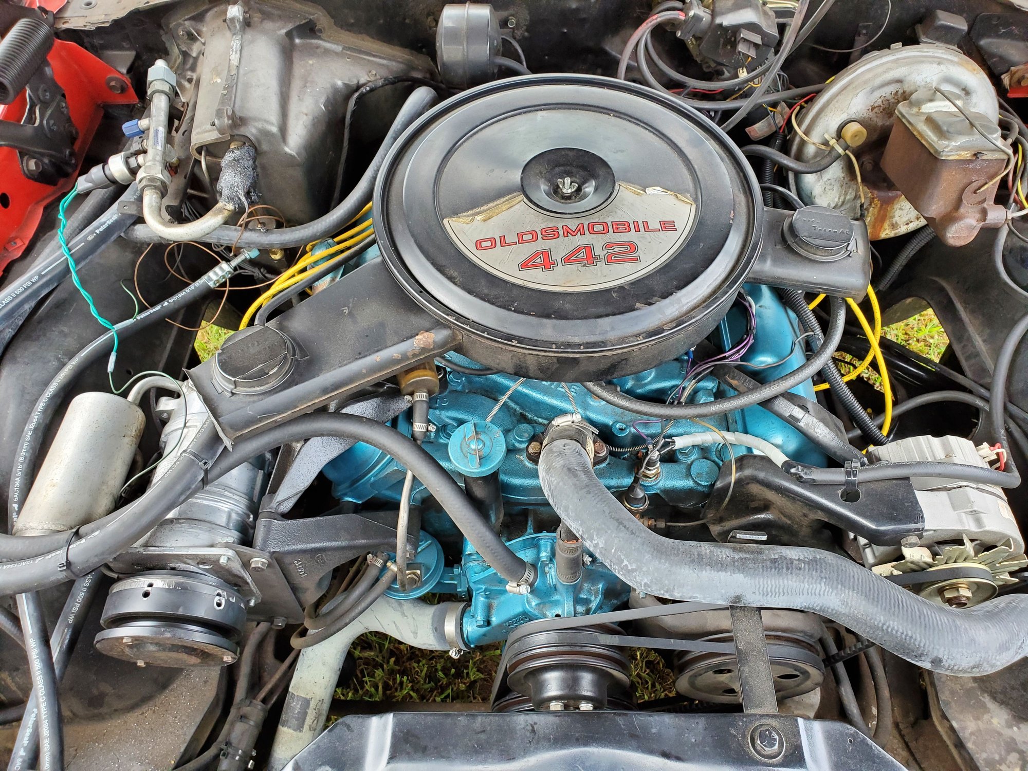

Ok we got the car home and here is what I found.

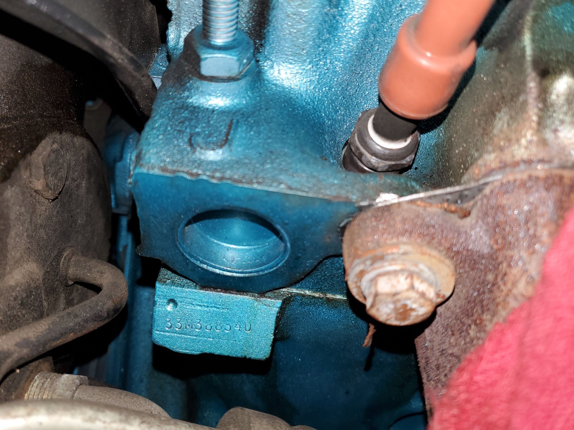

The casting number is 296021 Fa
There is a J on the drivers side cylinder head.
The block is stamped 33M388340 on the driver side.

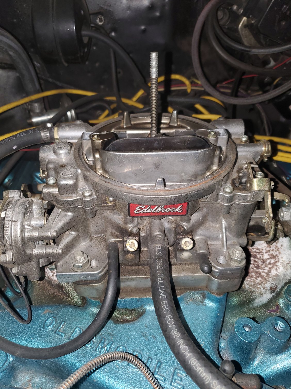

Carb is an Edelbrock with the numbers 1406 7242 stamped on the lower base plate. Does that tell what model carb it is or the CFM?

Does any of this shed any light as to the year model and HP of this engine?

Edelbrock with numbers stamped on lower left base. 1406 7242
Casting code 396021Fa
33M3888340 code stamped on drivers side with the letter J on the head

It's a 1973 block and likely 1973 heads (J heads were used on 455 engines from 1973-1976). Since the engine has been rebuilt and you don't have any information on the camshaft, pistons, head work, machining, etc, there is no way to even guess at how much power it makes.
