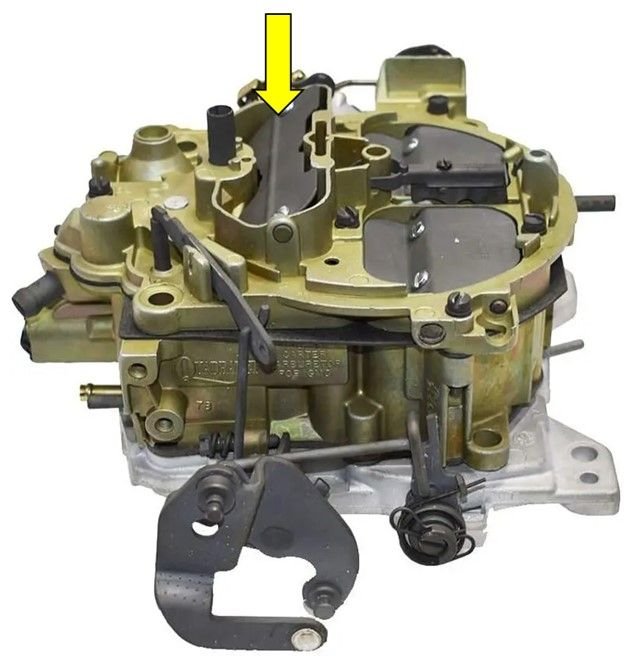

Originally Posted by W-27
...I do not know what the choke blade looks like or where it's located...
The yellow arrow in this picture points to the choke blade.
Follow Sugar Bear's trouble-shooting and let us know what blade position you see when the choke is warm.

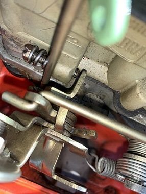

When engine is @ 1400 rpm is the linkage touching the idle speed screw as in the picture?
