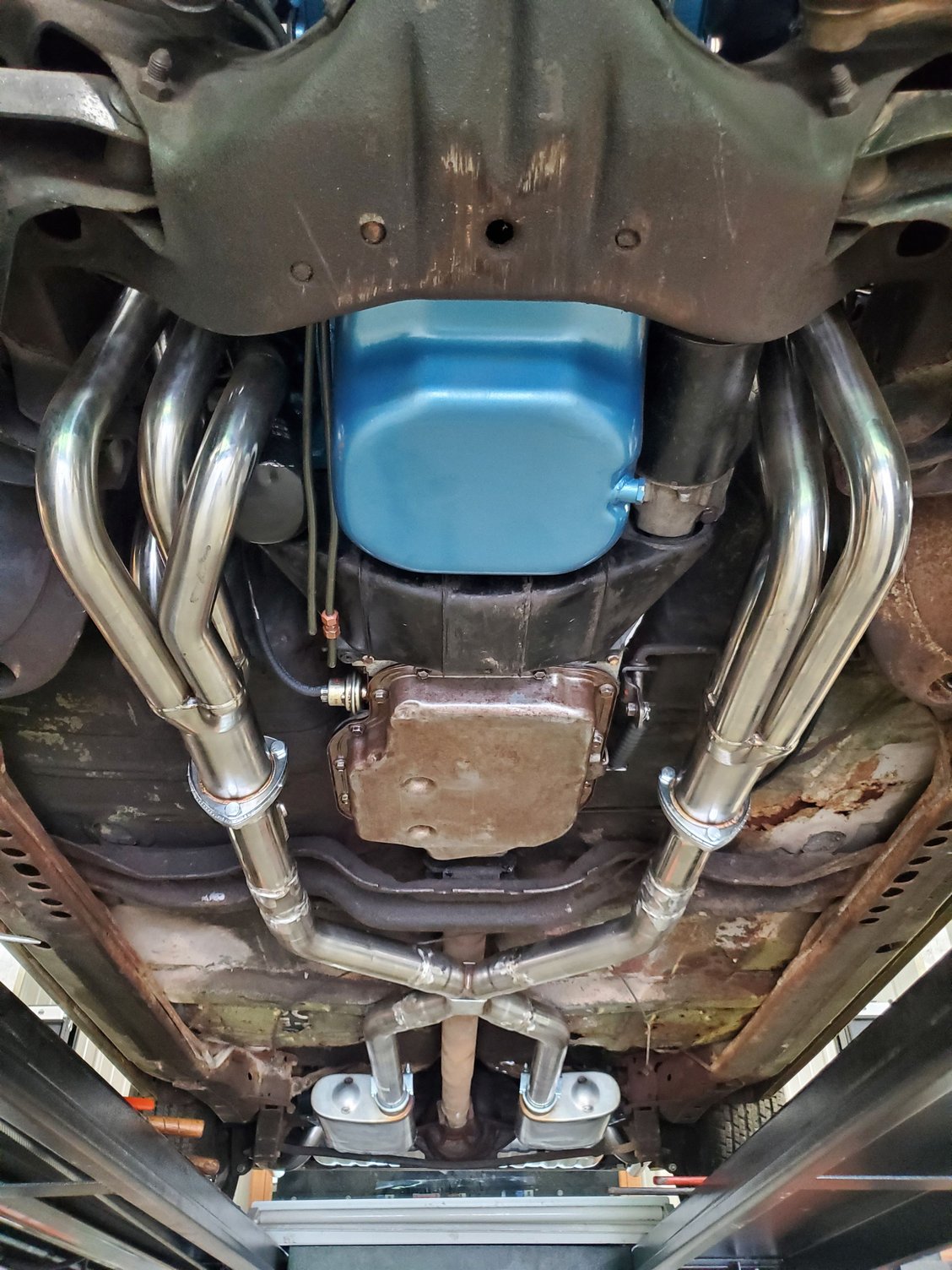

This is the seller and the headers I purchased back in August.
