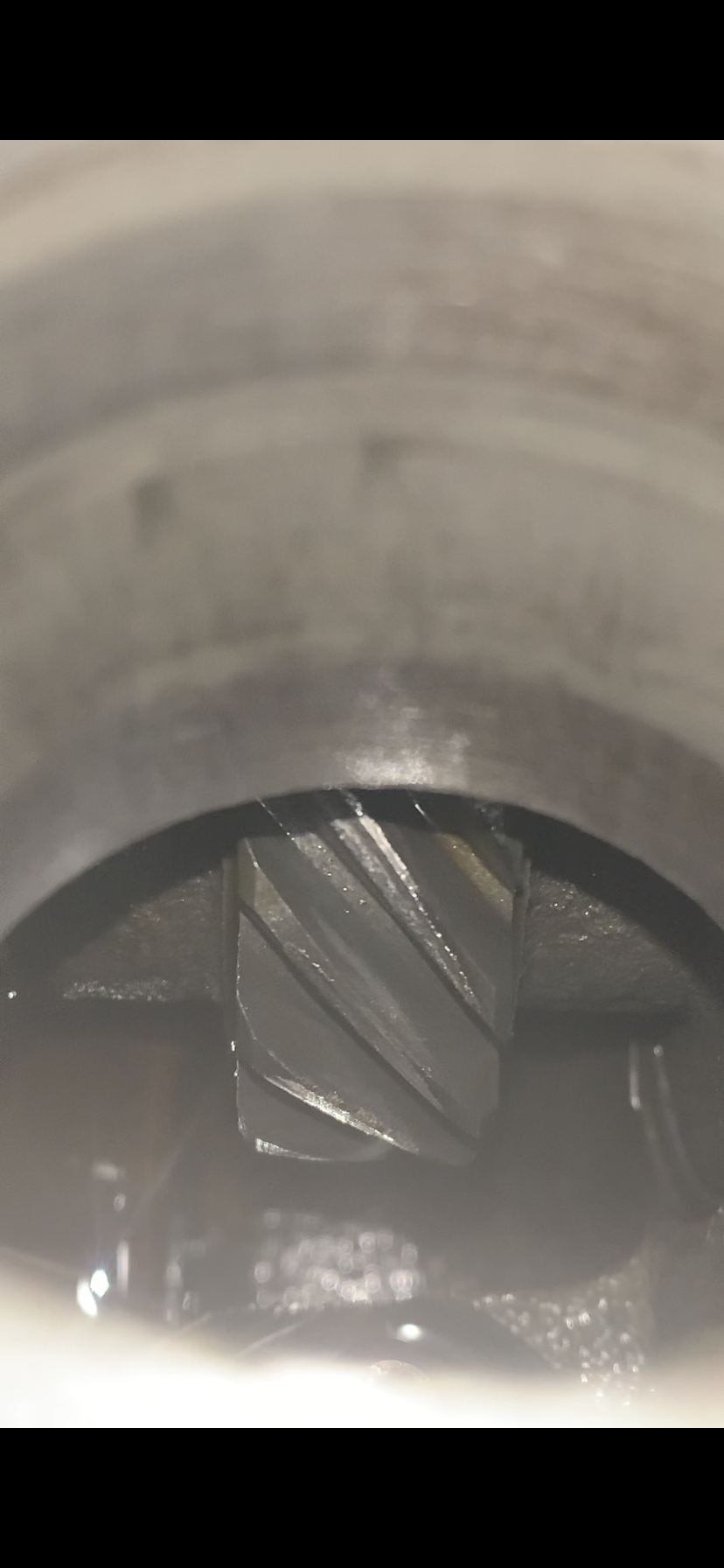

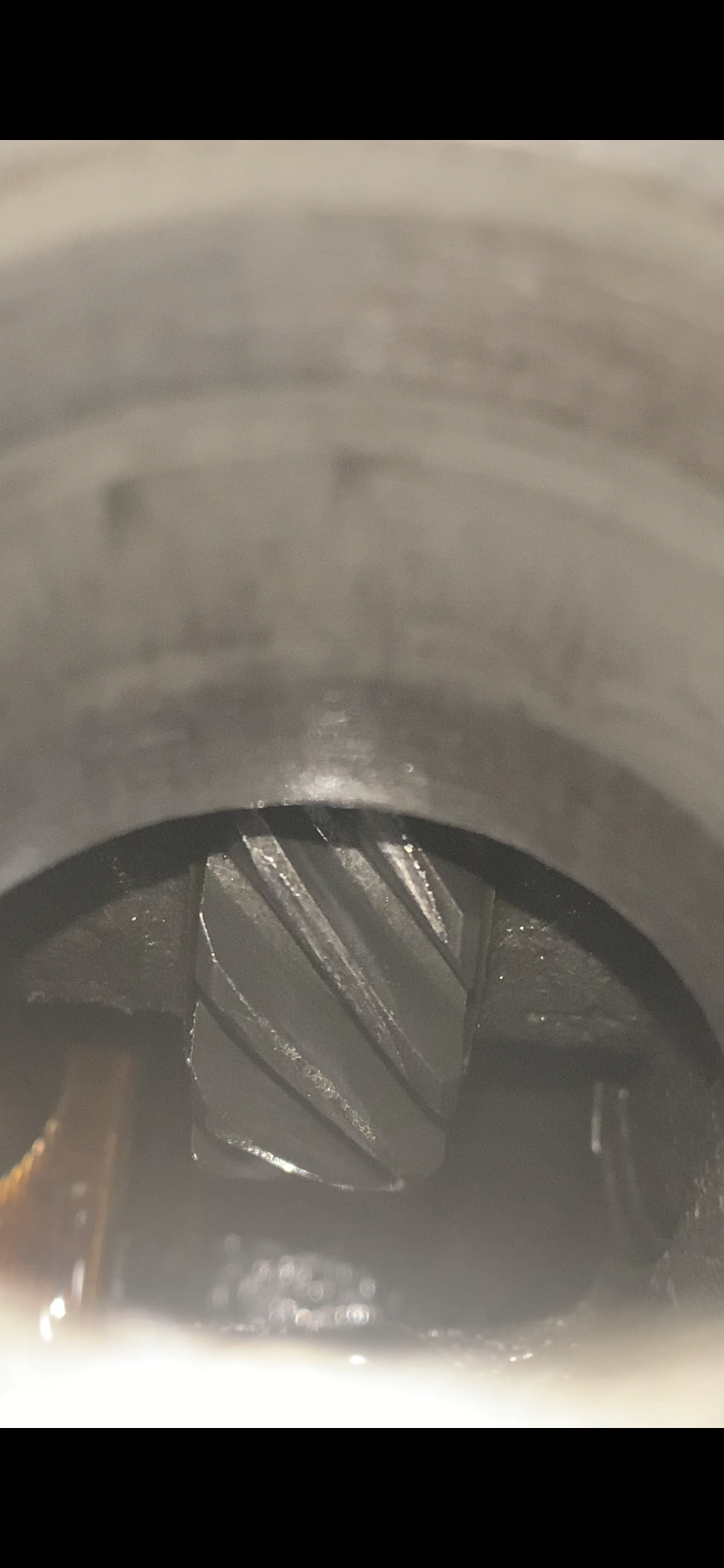

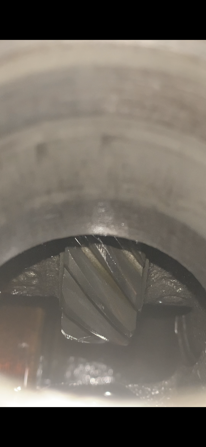

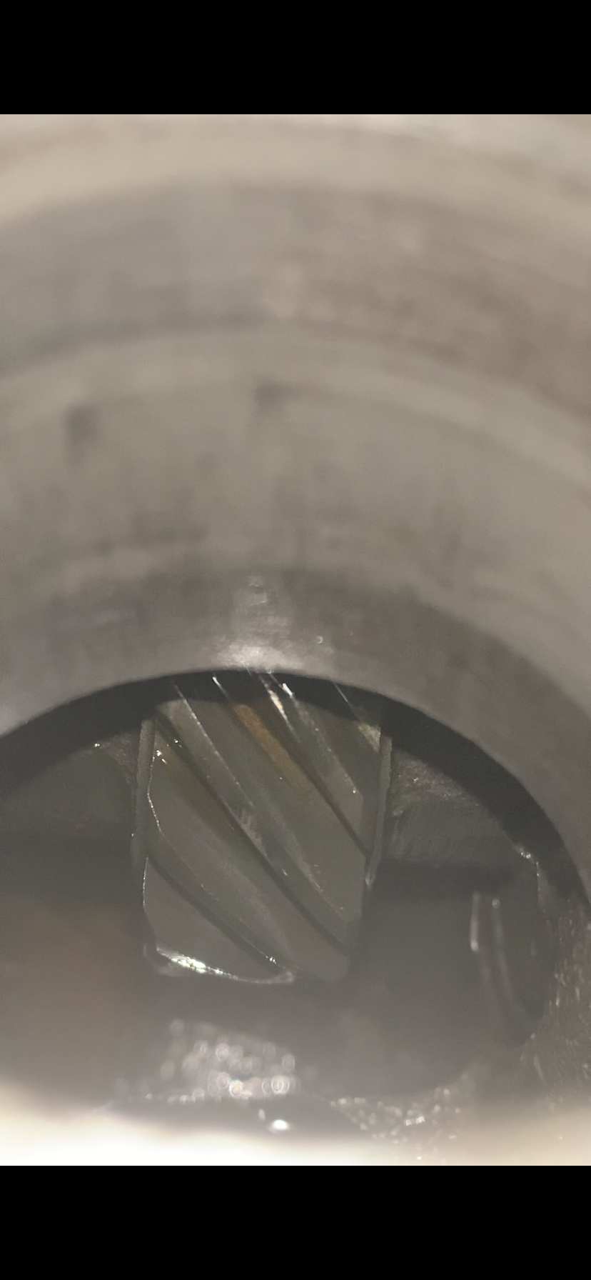

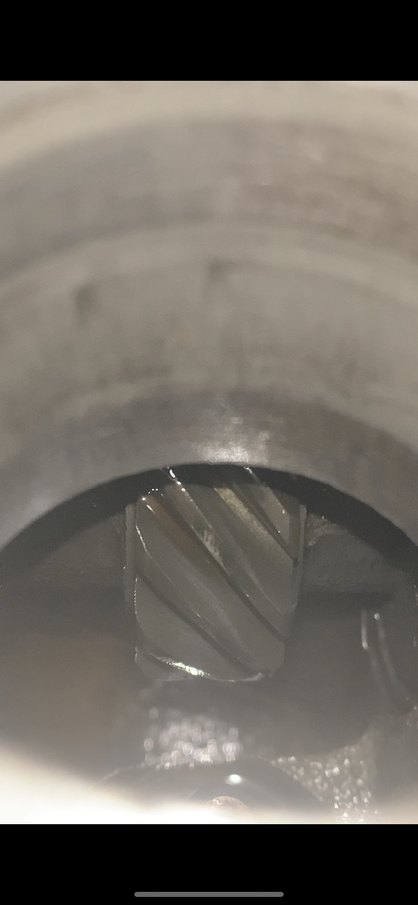

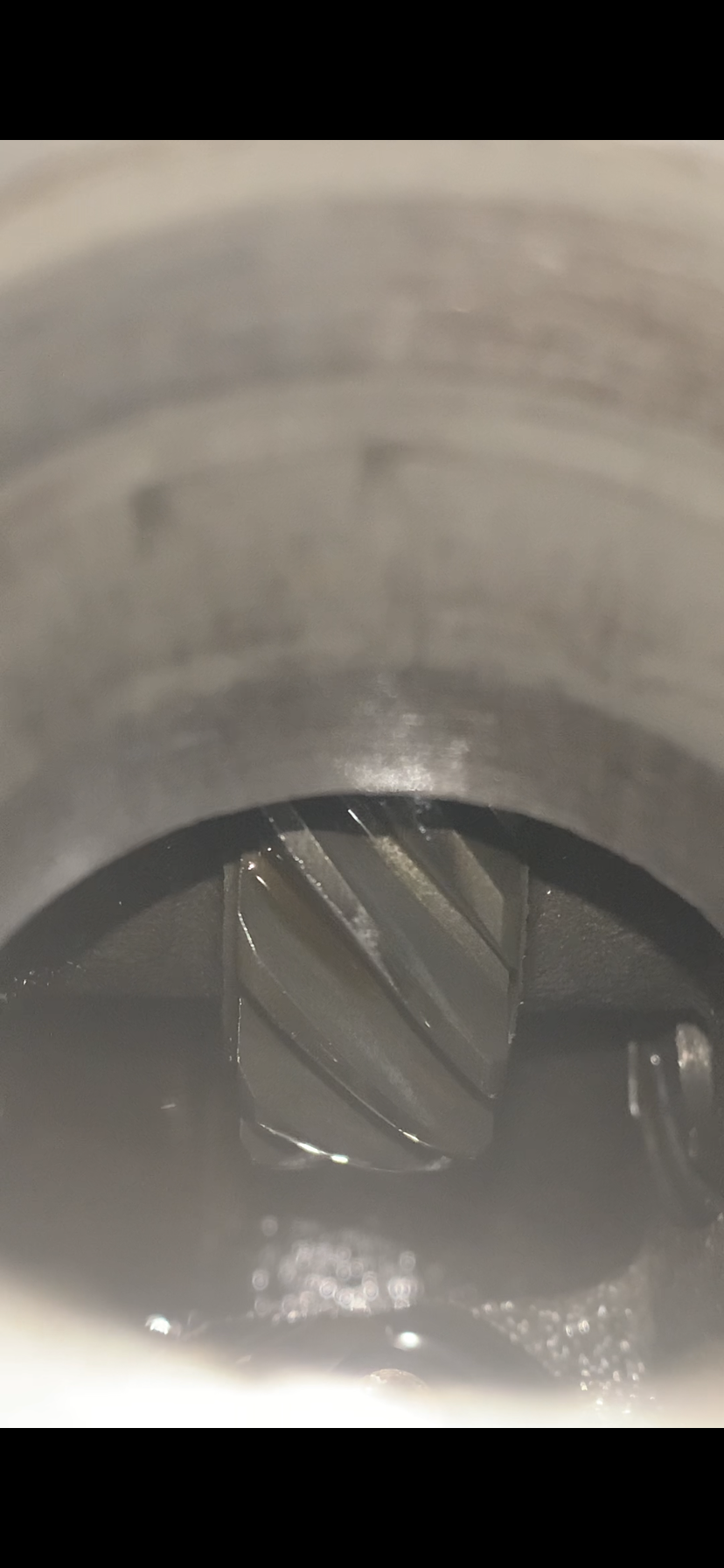

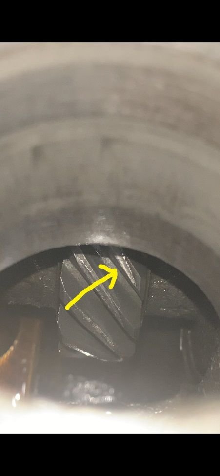

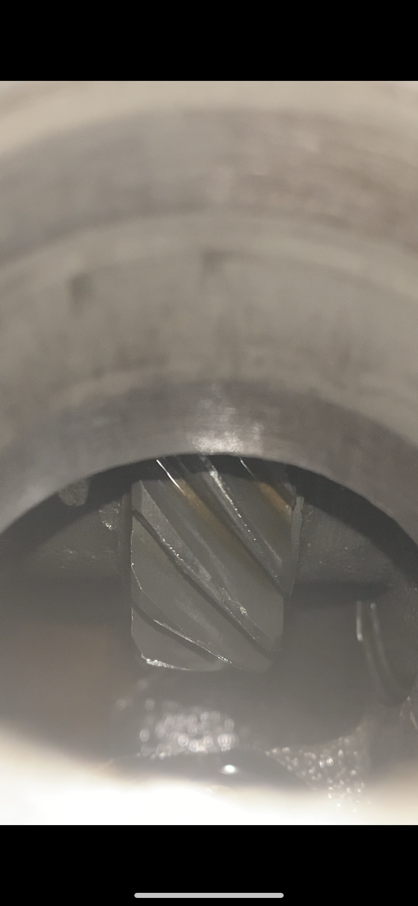

Here are stills of a video of the cam. All
the way around
Old Oct 8, 2023 | 02:55 PM
  #46
BillK's Avatar
Joined: Dec 2016
Posts: 1,970
This looks pretty chewed up to me ???
Old Oct 8, 2023 | 06:27 PM
  #47
rickw30's Avatar
Joined: Oct 2014
Posts: 3,013
That's ugly !

cs,
If that cam gear is as bad as it looks you are wasting your time putting any distributor gear on it. I think you need to get with your engine builder before proceeding any further.

is there some way to post a Video? The video is clearer and those shiny parts are not as shiny in the video. The flash makes them look worse in the screen captures.
Old Oct 12, 2023 | 09:02 AM
  #52
BillK's Avatar
Joined: Dec 2016
Posts: 1,970
I dont know if you can post a video. You could put it on you tube and then link it ? The spot I marked with the arrow looks like it has a raised edge on it. That was my concern.
Personally I think you need to have your engine builder look at it. Is he close to you ? Pay him to come and take a look at it for you. It is very hard to make decisions on stuff like this without the parts right in front of you to touch.

On your fourth crank I see that same spot I pointed out. It does not look good to me. Where are you at in Fl ? Maybe find someone else to come look at it in person for another opinion but I think that spot is what chewed your gear up. Are you anywhere near Mark ?
all your seeing is the backside of the gear.. you need a mirror to see the drive side good
