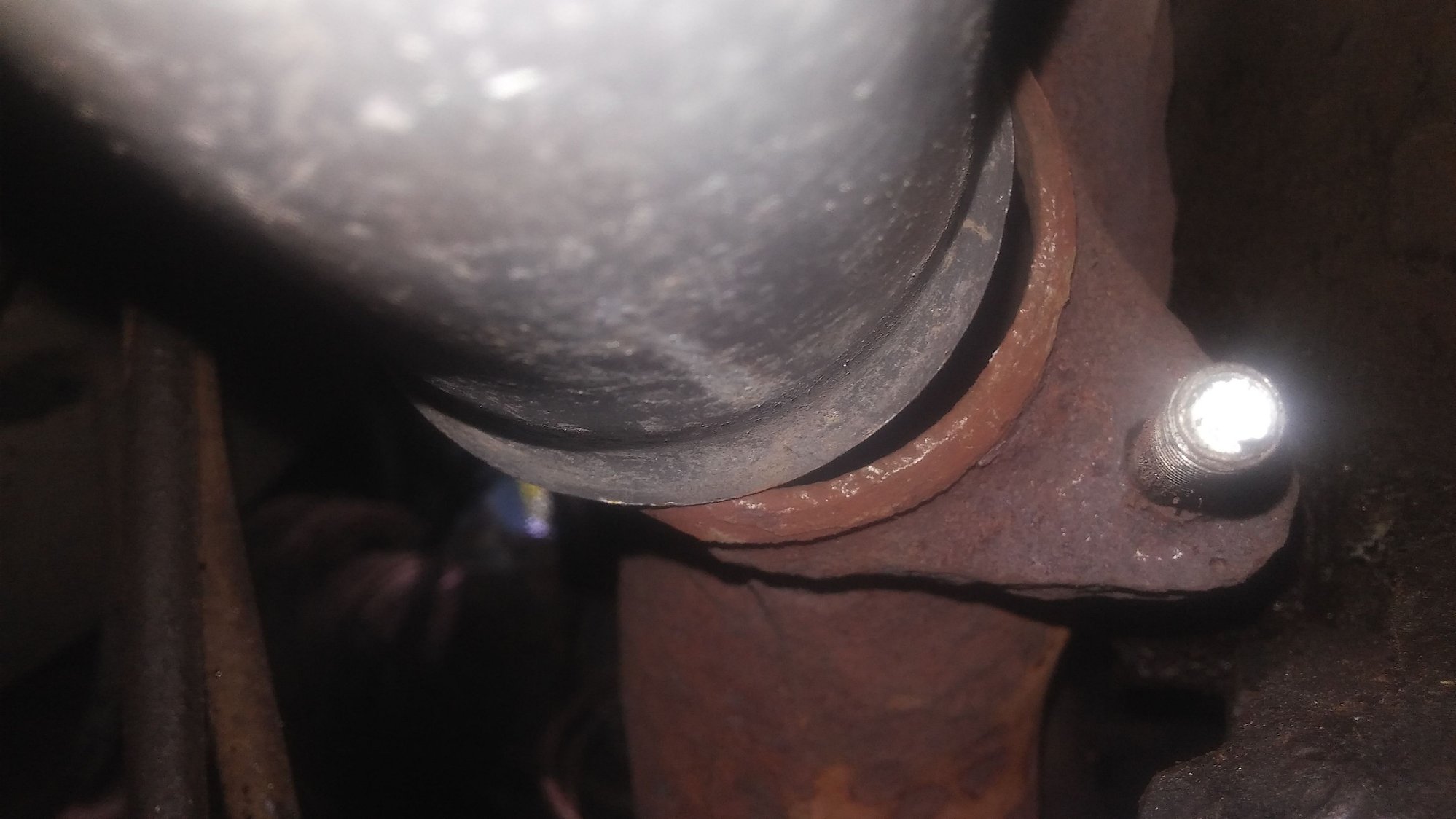

Ok..so I'm really disgusted with this whole exhaust gong show but i'll try and keep this clean. After finally recieving the crossover pipe that i got from ebay, it doesn't fit. I've been dealing with this for 6 weeks, had the original pipe on and off 4 different times, tried exhaust sealer, tape and it still leaks.
Here is how badly the new crossover DIDNT fit on passenger side after aligning it on drivers side. what the hell
Old Sep 18, 2016 | 02:04 PM
Posts: 15,395
Bring it to a muffler shop and let them deal with it.
Old Sep 18, 2016 | 04:47 PM
Posts: 42,475
Or... if you have a torch, you can heat the pipe and bend it over.
i agree,a muffler shop should be able to fit that pipe.the upward bend must be too much causing the pipe to be short. i have a good used driver's side dual exhaust manifold if interested.jc
Old Sep 19, 2016 | 08:42 AM
Posts: 50,770
From the looks of the pitting on the manifold taper seal, THAT'S your problem. No amount of screwing with the pipe will fix that.
pitting probably doesn't help but that's not the side that had the exhaust leak, it was the drivers side.

And what does that flange look like?

I put one on my Vista Cruiser and it didn't fit either. (about like your picture) I had to heat it up and bend it some but has been good since.
