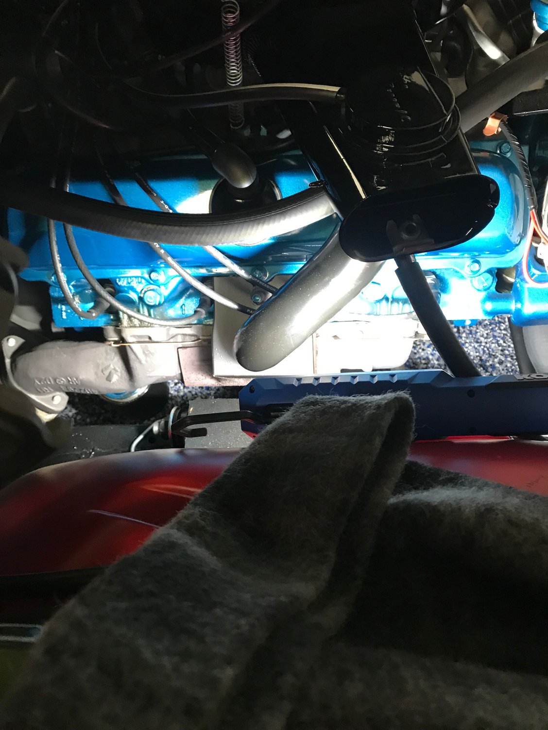

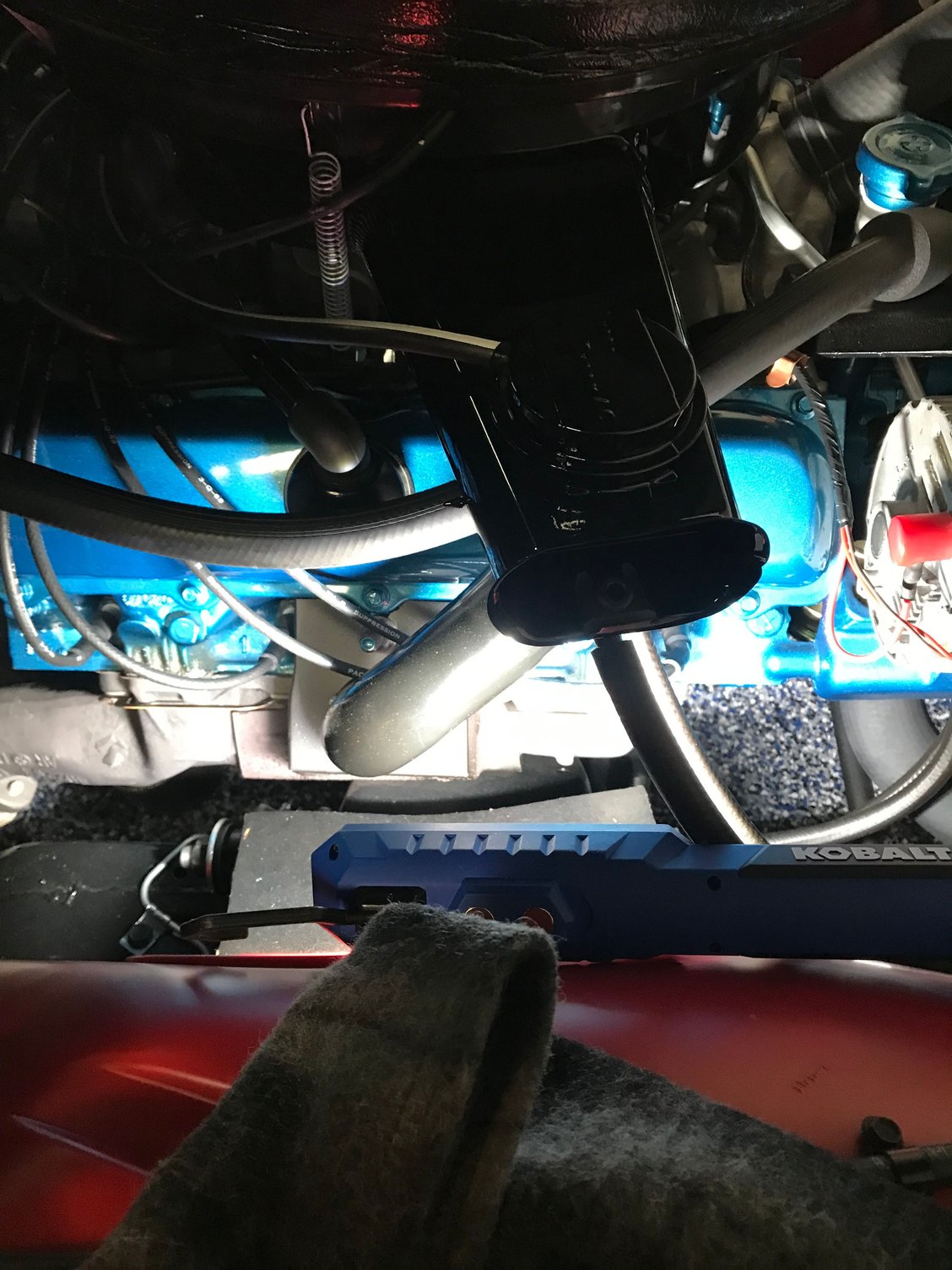

I have the factory stock setup on my ‘70 W-30. To remove the #4 and #6 sparks plugs do I also have to remove the entire OAI setup, the exhaust pipe from the manifold and the Exhaust Manifold Shroud ?

Yes SY2455 it is a serious question. Maybe you can enlighten me and tell me how I can get a spark plug socket down into this area without bending the Exhaust Manifold Shroud ?

Cannot get the socket on it Ralph - the Exhaust Manifold Shroud is in the way. I guess I can loosen the shroud and see if that helps but I wanted to see if anyone else has had this issue. Maybe there is a trick to it but I’m not seeing it.

You're all kind of missing the point. The OP has a repro heat stove that is not formed correctly and overlaps the plug. Look at his photos. There isn't a straight shot to get any socket on the plug. Removing or reshaping that heat stove are the only options.

The photos I’m viewing of the clearance and angles, combined with having run into similar on someone else’s car once before, clearly drive home the point (none missed) for a pass through socket IF OP doesn’t want to play tinker or remove the sheet metal when he wants to remove or install the crowded plugs(s). There is plenty of room to get a “pass through” socket and accompanying wrench on there, especially when the wrench only has to break it loose or snug it up for 1/8 - 1/4 of a turn.
I get the idea of making a “sustainable” mod by reforming the metal but OP appears to me as resistant to that.
