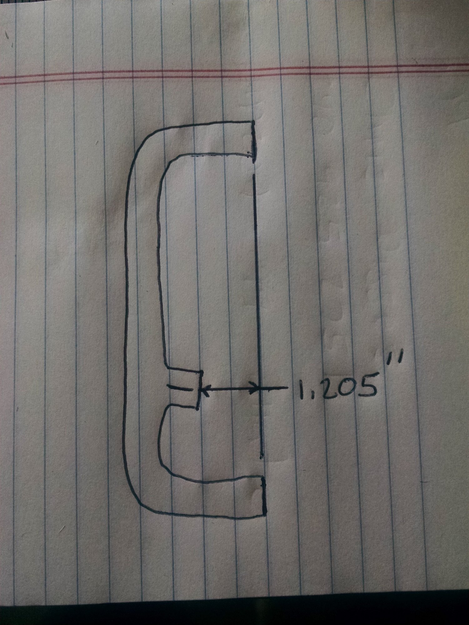

Any aftermarket seat they use will be better than the factory head material. I use Jloy seats from SBI and the ones they show for the 2.072 valves are 3/16 deep. Thats only .187 deep. The ones for the exhaust are .218 I have always had good luck with the seats they recommend as far as depth and od.
Like I said you really need to measure what is there before deciding what seat to use. Especially when the valves have been sunk like that. You simply cannot go by what the book says will work.

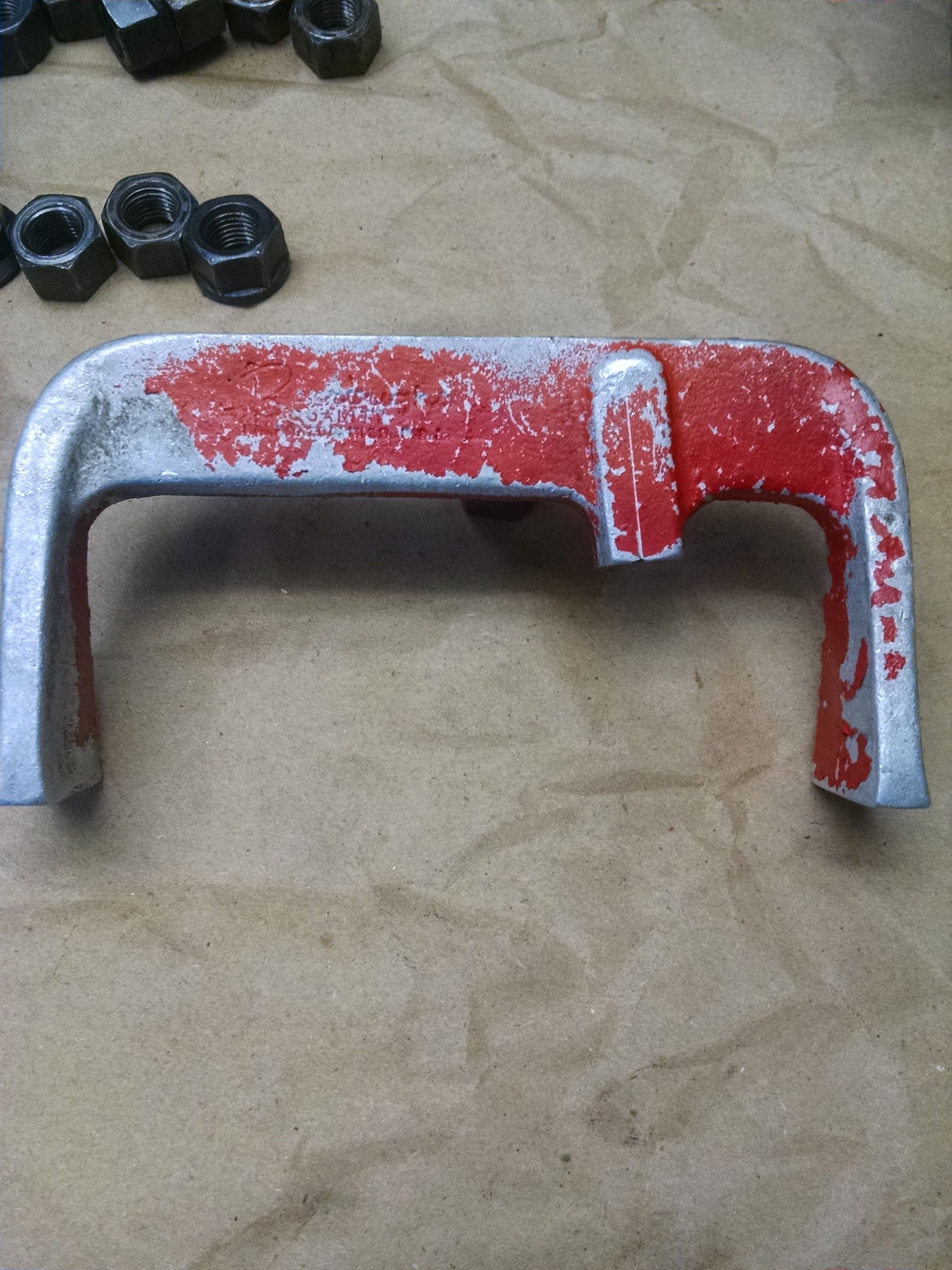

Also the hgt from the spring pad is sort of ballpark on Oldsmobiles. You really need to have the correct tool to measure the hgt referenced off the valve cover rail and rocker arm pads.
Here is a drawing of the measurements I took from the factory GM tool that I have.

Thanks Bill. That is great information! Mondello has that tool. I will get one.

a
The Mondello tool is not correct. At least the one that I bought wasnt
