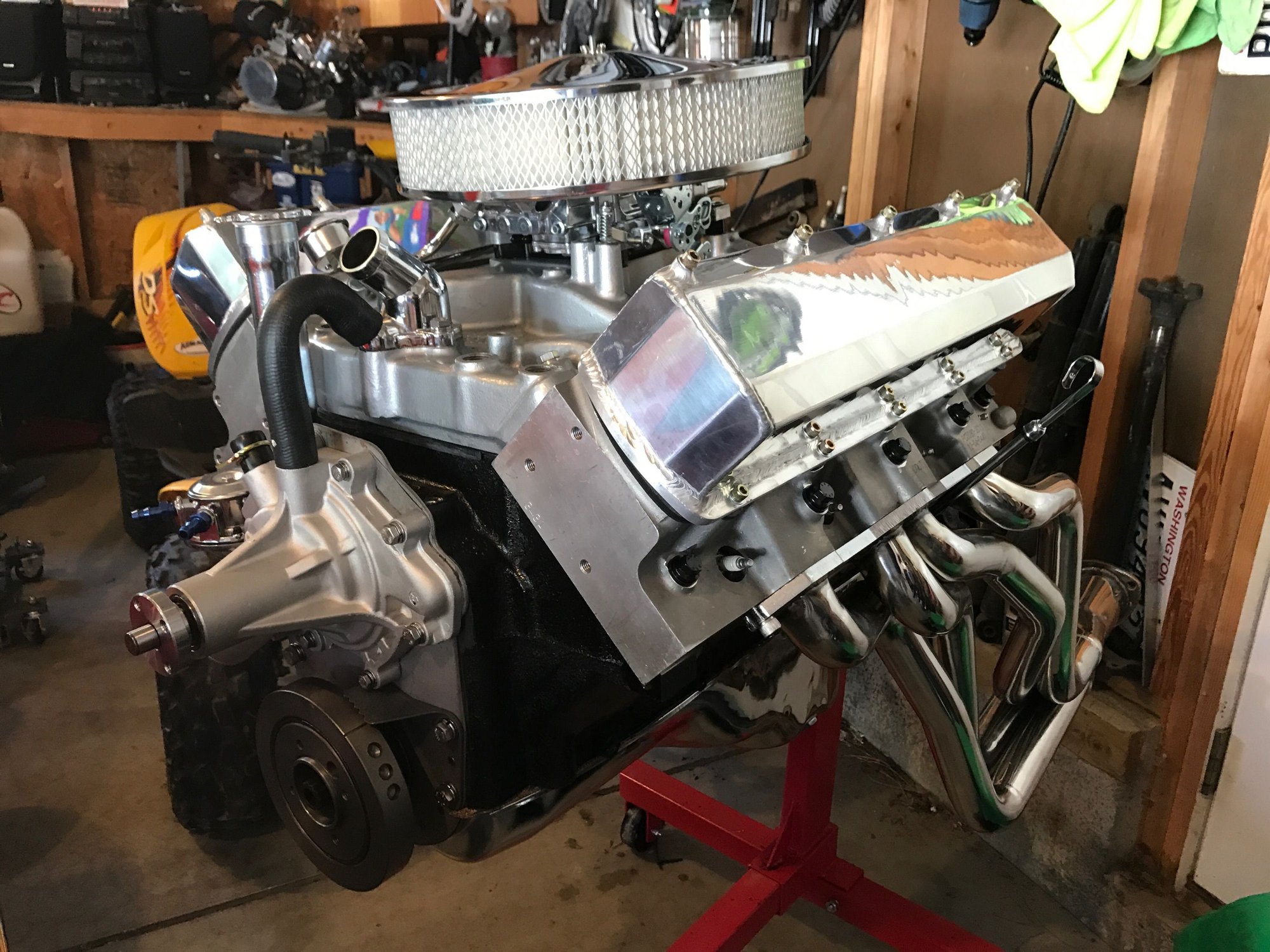

inching my way closer on this build ,i have to adjust the rockers arms now any advice for a good method of doing so?
File Type: jpg
File Type: jpg
Old Oct 6, 2018 | 11:43 AM
  #80
Kennybill's Avatar
Joined: Aug 2005
Posts: 1,972
From: Braceville, Ohio
Here you go.
https://classicoldsmobile.com/forums...r-rockers.html
