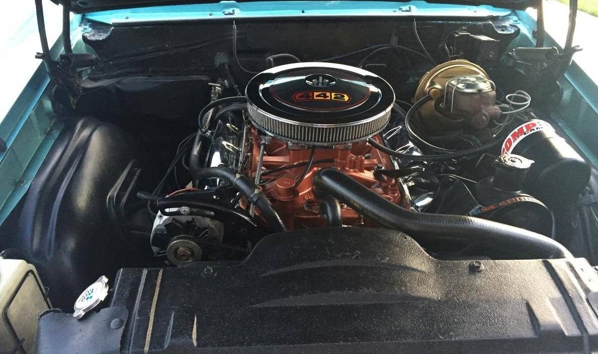

First thing i noticed with this 70 442 is the cam. second thing when you step on the brake the first time you stop is ok but the 2nd time it's too hard to stop.
I checked the hose it is not collapsed and is getting vacume but dosn't seem like enough vacume to keep up with the brakes.
i guess the cam is too much too have power brakes like the W30? external vacume can? booster assist? or change cam.
i will try and post vid of engine running for you guys too hear it, maybe try a new booster?
where can i buy a decent booster if thats the case?

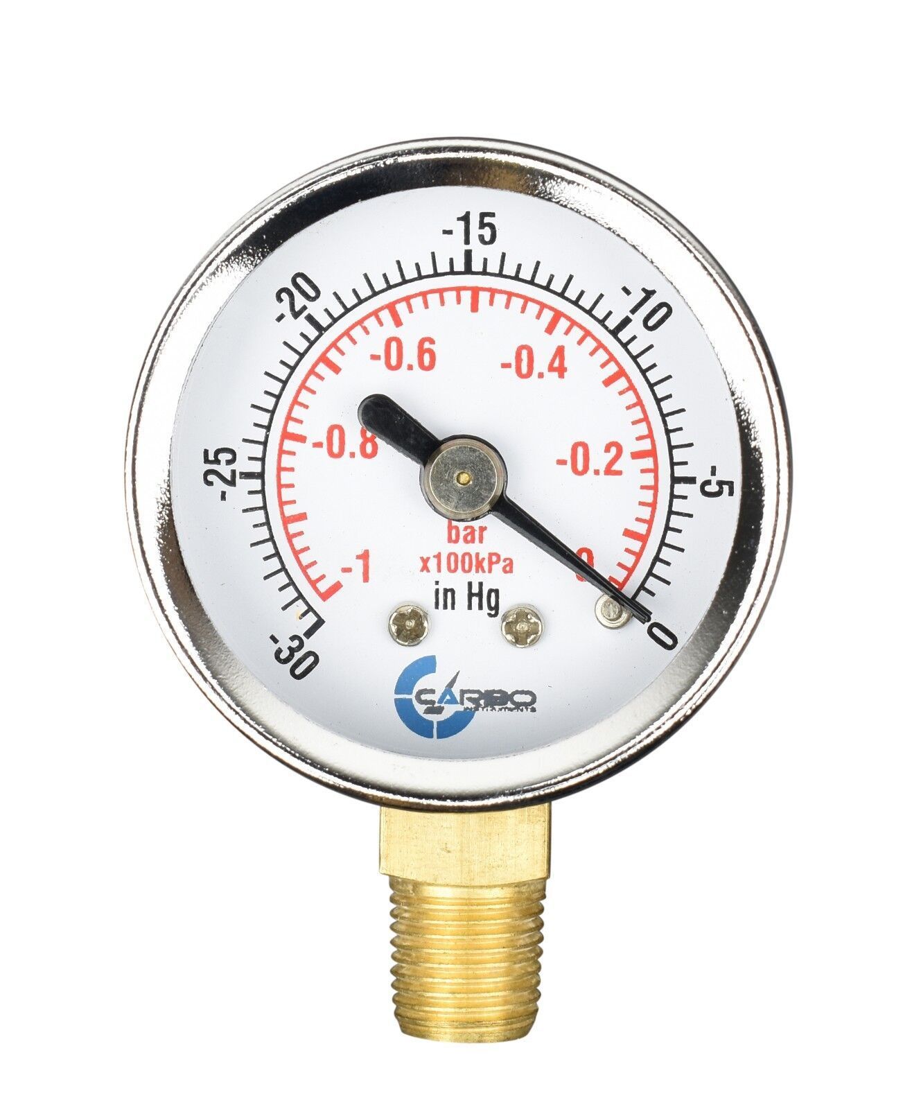

Will this $9 gauge work?
Old Jun 15, 2023 | 06:58 AM
Posts: 25,789
If it reads vacuum accurately - yes.
Old Jun 15, 2023 | 07:02 AM
Posts: 25,789
As noted in that ^^above^^ vacuum gauge description:
"ASME B40.1 Grade B Accuracy Compliance ± 3-2-3 % of span"
You get what you pay for - you can do the math.

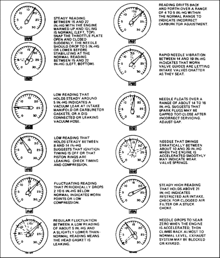

In the situation you're attempting to diagnose - possible leaking vacuum or low vacuum - the first two readings (on the left) of this chart are most likely the most applicable. In all cases, you expect to achieve a "steady" vacuum. Review the first two readings in your case - these will provide some insight.

I dunno what 3-2-3 means. If it’s 3% of the span of 30” then its accuracy is +/- 0.9 “. Sounds good enough for the job at hand.
Old Jun 15, 2023 | 02:16 PM
Posts: 25,789
Kenneth - I did a copy/paste - didn't realize it pasted most likely incorrectly, I believe it was+/- 3% as you stated & I agree that variance should be just fine.
Old Jun 15, 2023 | 02:20 PM
Posts: 25,789
I looked it up - says same as I posted. Who knows - I reckon ~3%...
