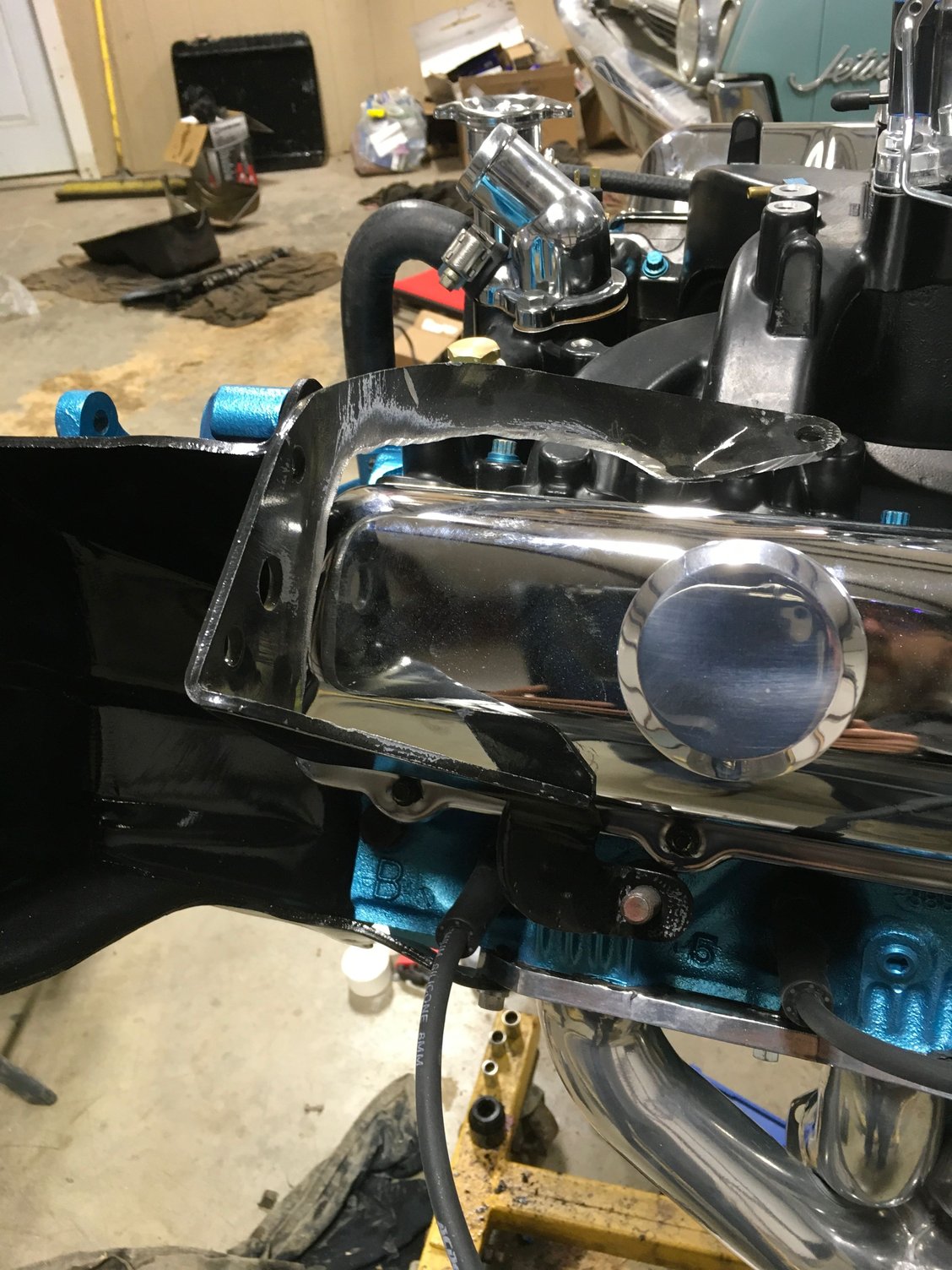

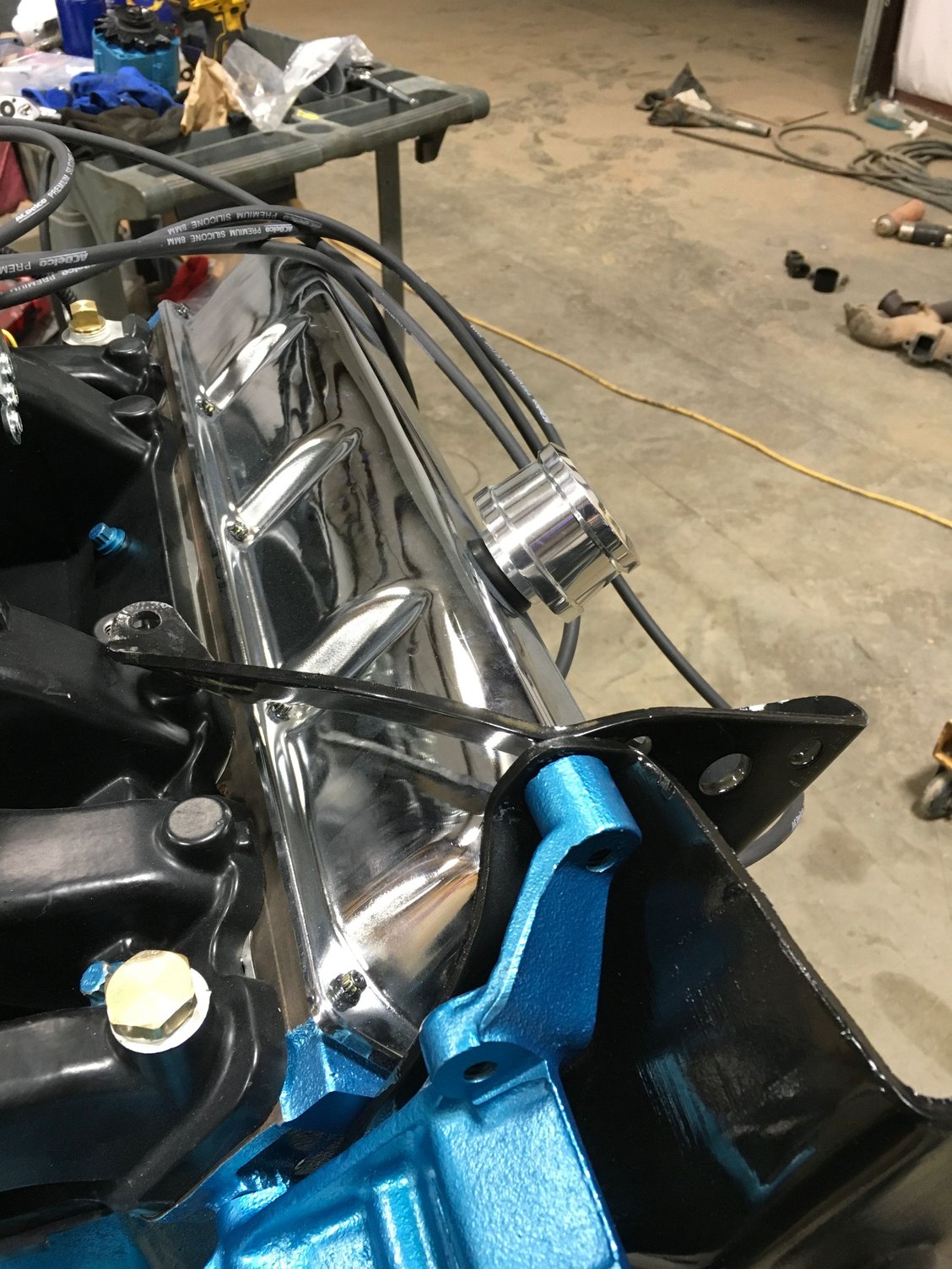

Here is a picture of the bracket in question
with the new intake manifold and the higher valve covers it will not line up without pushing on the lower side of the valve cover.

Your best bet would be to weld on a gusset next to the lower bolt tab to let you grind away that corner that is interfering with the valve cover. This bracket sees primarily tension loads, so the amount you've cut away isn't the end of the world. Alternately, use a 1968-up style bracket to mount the pump down lower. Clearance is tight in the 64-67 chassis, but it will just fit.
