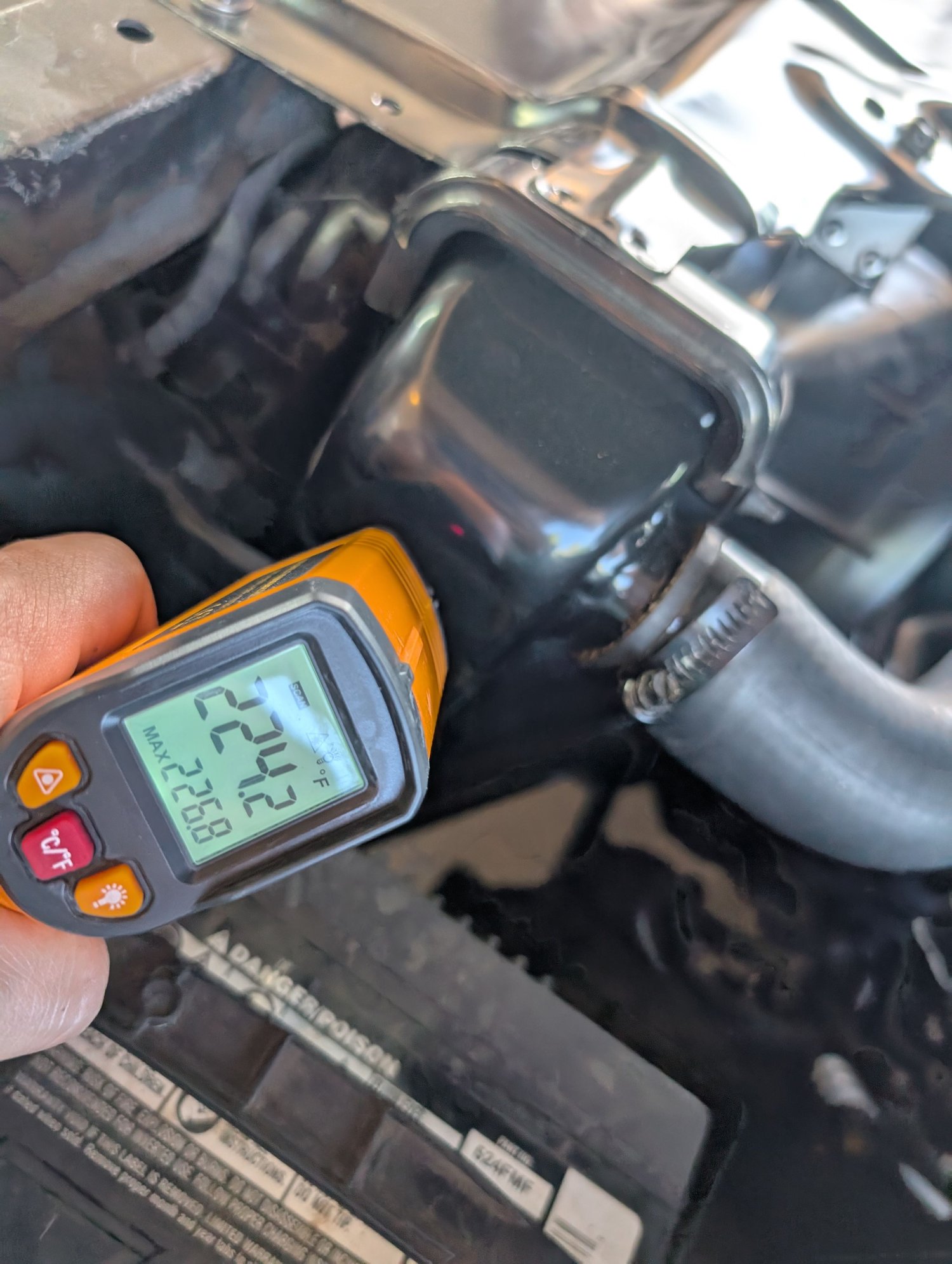

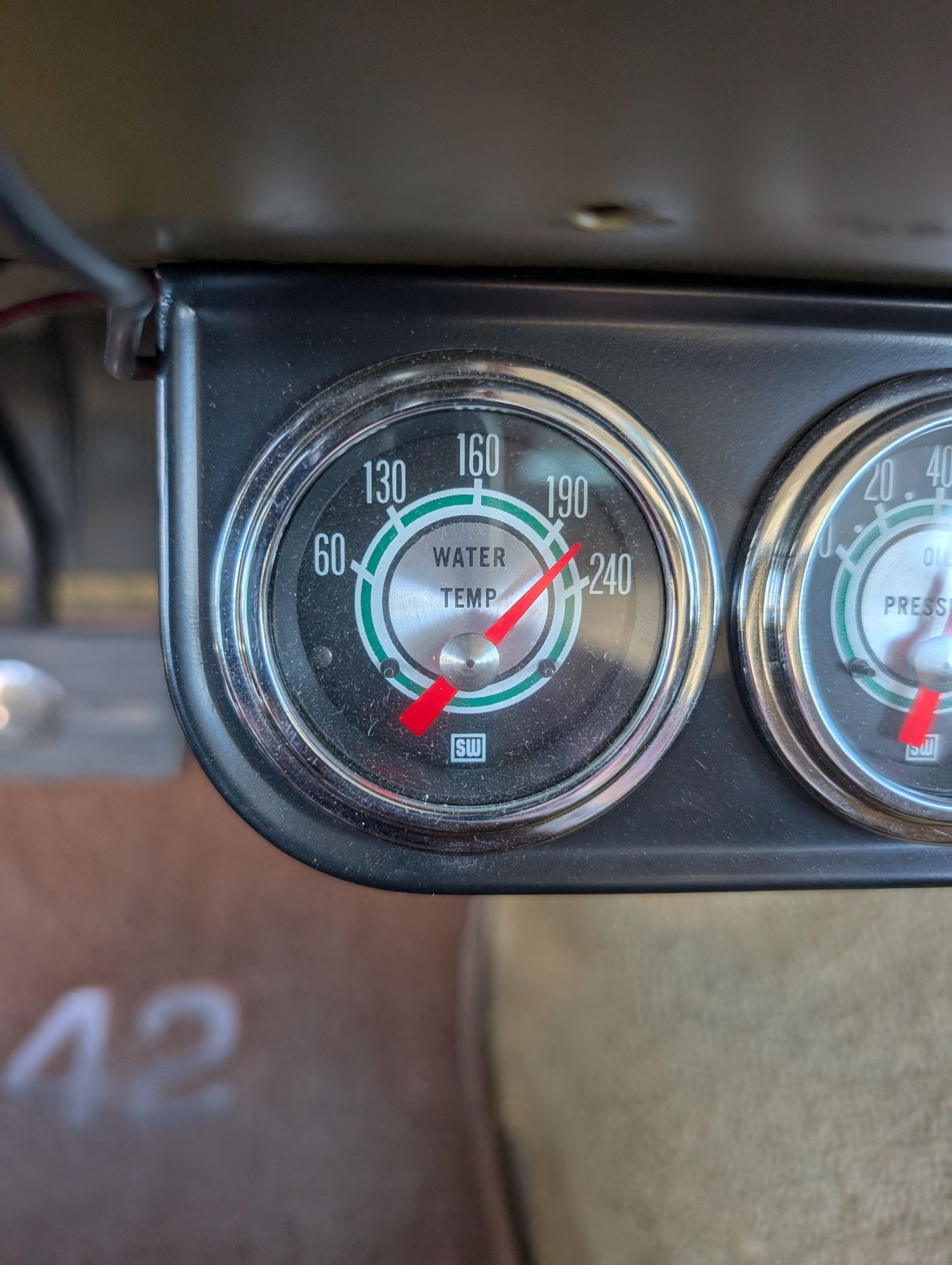

A version of this gets posted every summer, but I'll throw my story out here and see what I get. About 3 years ago I swapped a 455 Olds into my 1969 Vista Cruiser. The motor is an older stock rebuild - aluminum intake, stock style water pump, and a 180F thermostat. I'm running a factory AC setup and I live in Arizona. To state the obvious - it gets HOT here. Whenever the temperature climbed above 85-90F outside (which isn't even hot), my aftermarket gauge (Stewart Warner) indicated the car would run hot. In the 230F range during stop and go traffic with the AC on. Cutting the AC helped a bit, but it'd still stay around 215-220. Open highway driving didn't help- it would still get up there with the AC on.
This summer I replaced the older 4-row brass/copper radiator for a Cold Case aluminum one. Now the car runs fine on the open highway - 60-70 mph with the AC on and it stays around 205F (tested on a 100F day). However, it still climbs to 235F if I'm idling for a while (10 mins) or in long stop-and-go driving. I cut it off at that point.
I'm taking this to mean I now have sufficient cooling capacity but a low-speed airflow issue. I replaced the fan clutch with a Hayden HD model and I have the 7 blade 19" stock fan. No difference - I still climb to 230F or so if idle for a while.
I have (what I believe) is a stock fan shroud though the fan does seem to sit deeper in the shroud than expected. I have the rubber seal on the bottom and sides of the radiator. I am missing the passenger side masticated rubber strip - but can one small piece of rubber really make that much of a difference? I'm running 50/50 antifreeze - I even brought premixed to ensure it was correct. There are no mouse nests, scorpion dens, or rattlesnakes blocking the radiator or condenser.
I've spoken to a few shops and as expected get conflicting answers. Everything from "oh that's normal these ran hot back in the day", "aluminum radiators aren't as good as the original", "put electric fans on", and "if the idiot temp light isn't on your OK".
My last thoughts are:
1. Replace the thermostat just to see if that helps. I really don't think that will do anything though. The current one is 3 years old and the car runs fine on the highway.
2. Adjust the tension spring on the Hayden HD fan clutch to get stronger lockup and therefore more airflow at low speed.
3. Check the timing? Though my mechanic (who set the timing 3 years ago) said that's highly unlikely as the timing would have to be way way off to run this hot.
4. Water pump - I really don't think this is an issue either as highway drives fine.
Any suggestions? Is this really just normal and having a gauge is making me crazy? I can see not being able to run the AC while idling on a 115F day, but I'm getting hot under much less severe conditions.
Thanks for any input!

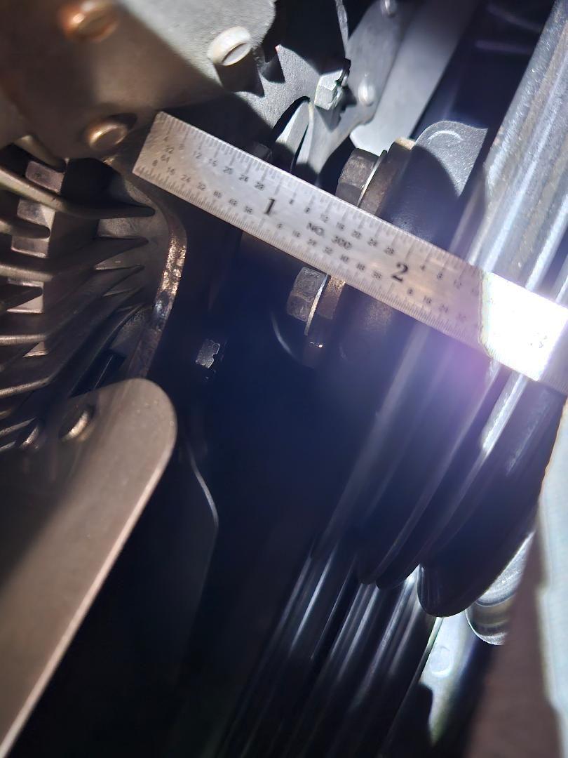

You have a good grasp of the possible problems. And you've gotten some good guidance.
Here are two other points that may help. The first is important; the second, less so.
1. The fan blades need to be centered on the trailing edge of the fan shroud to give best air movement. Modify the shroud or change spacers on the fan to accomodate.

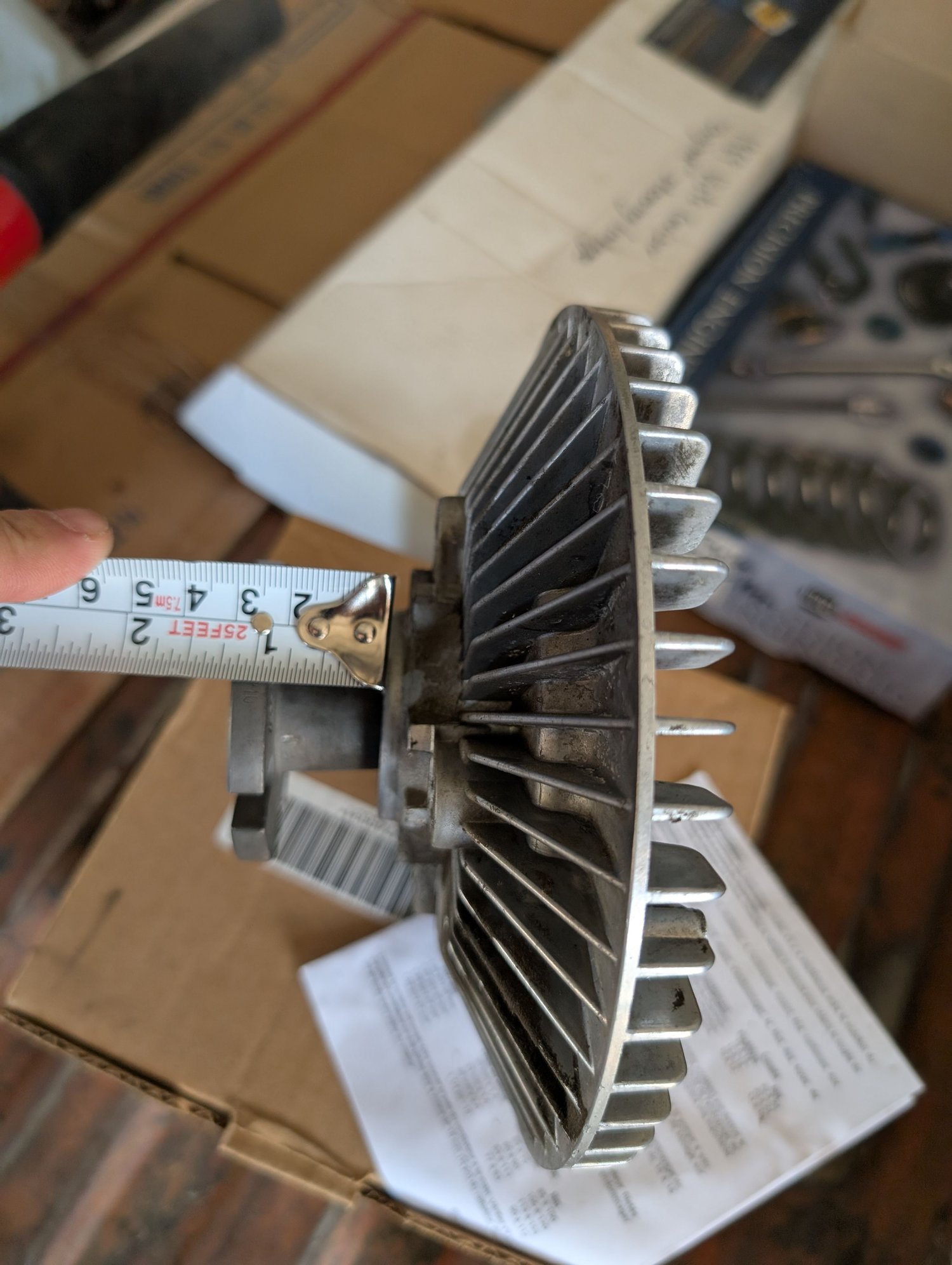

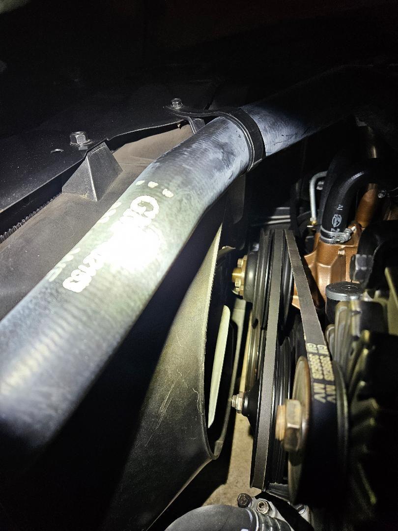

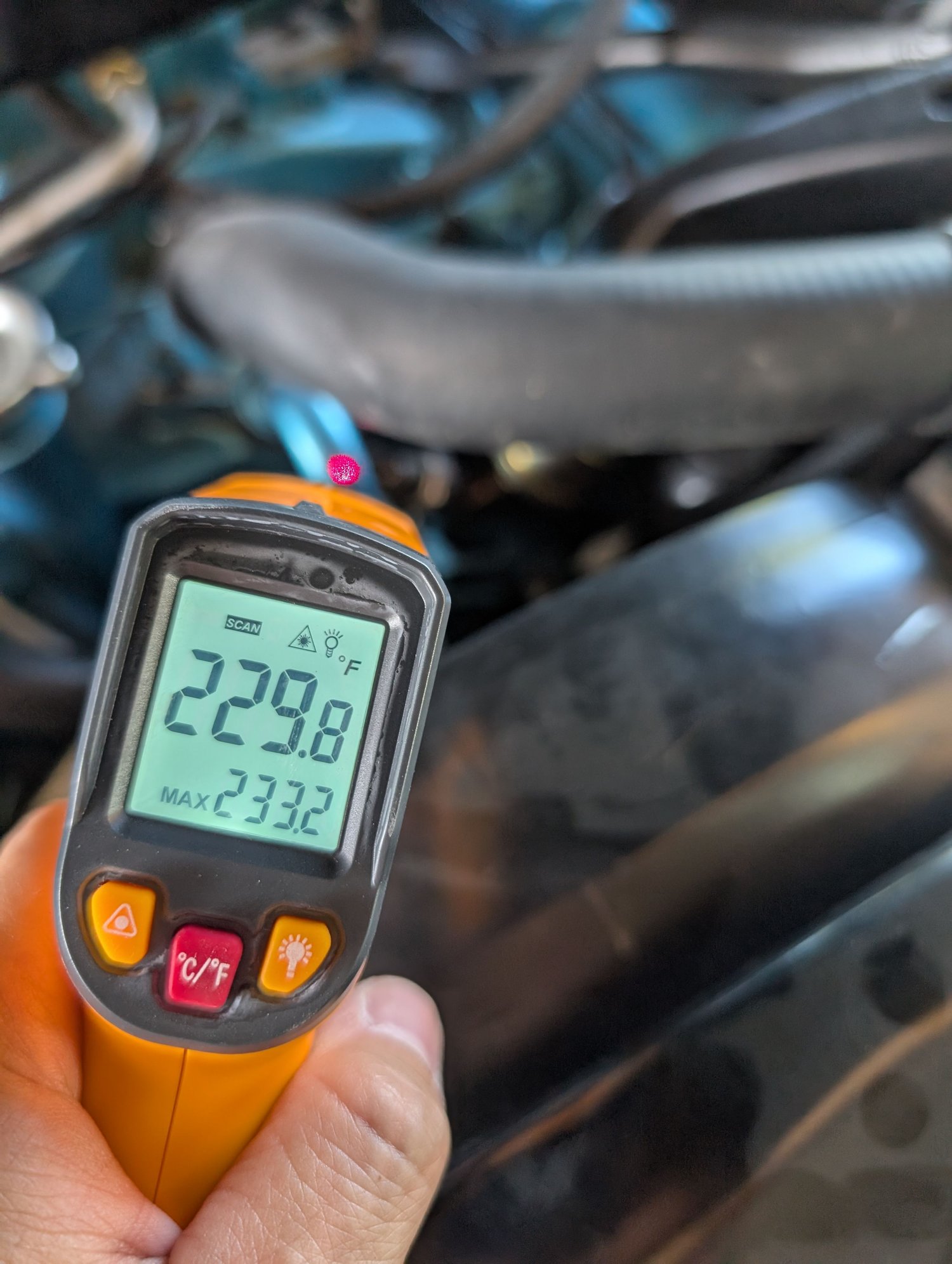

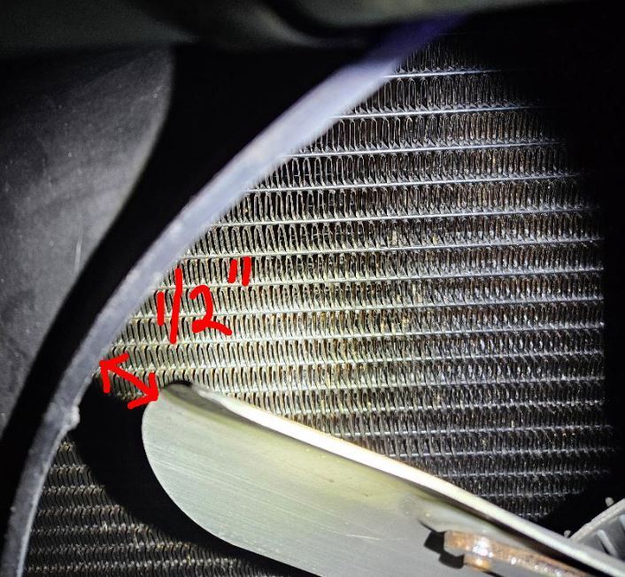

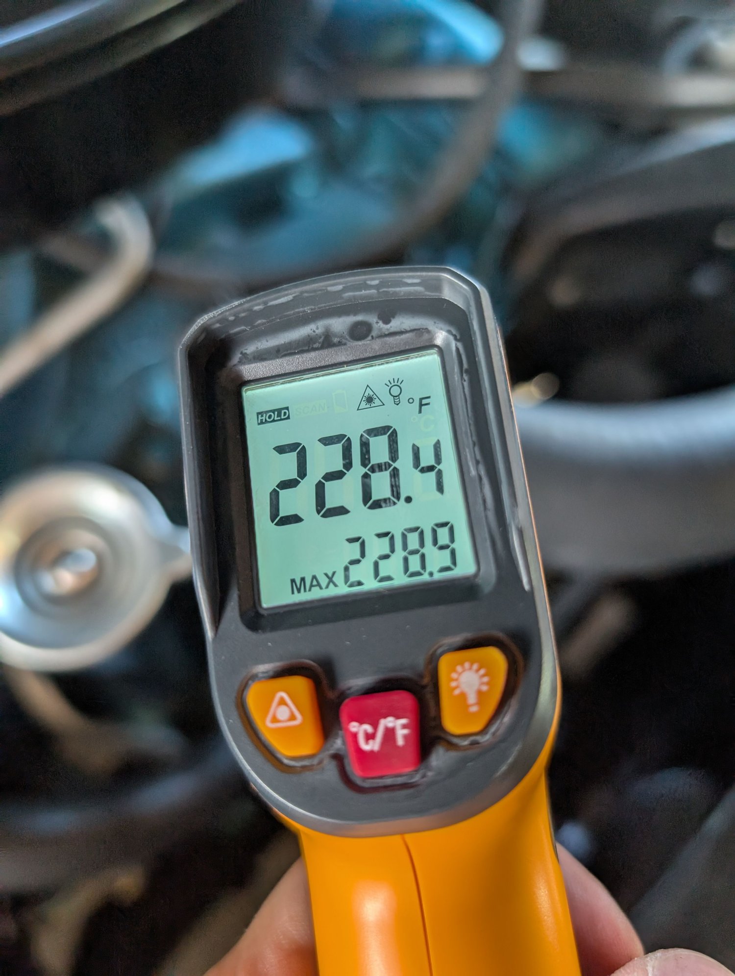

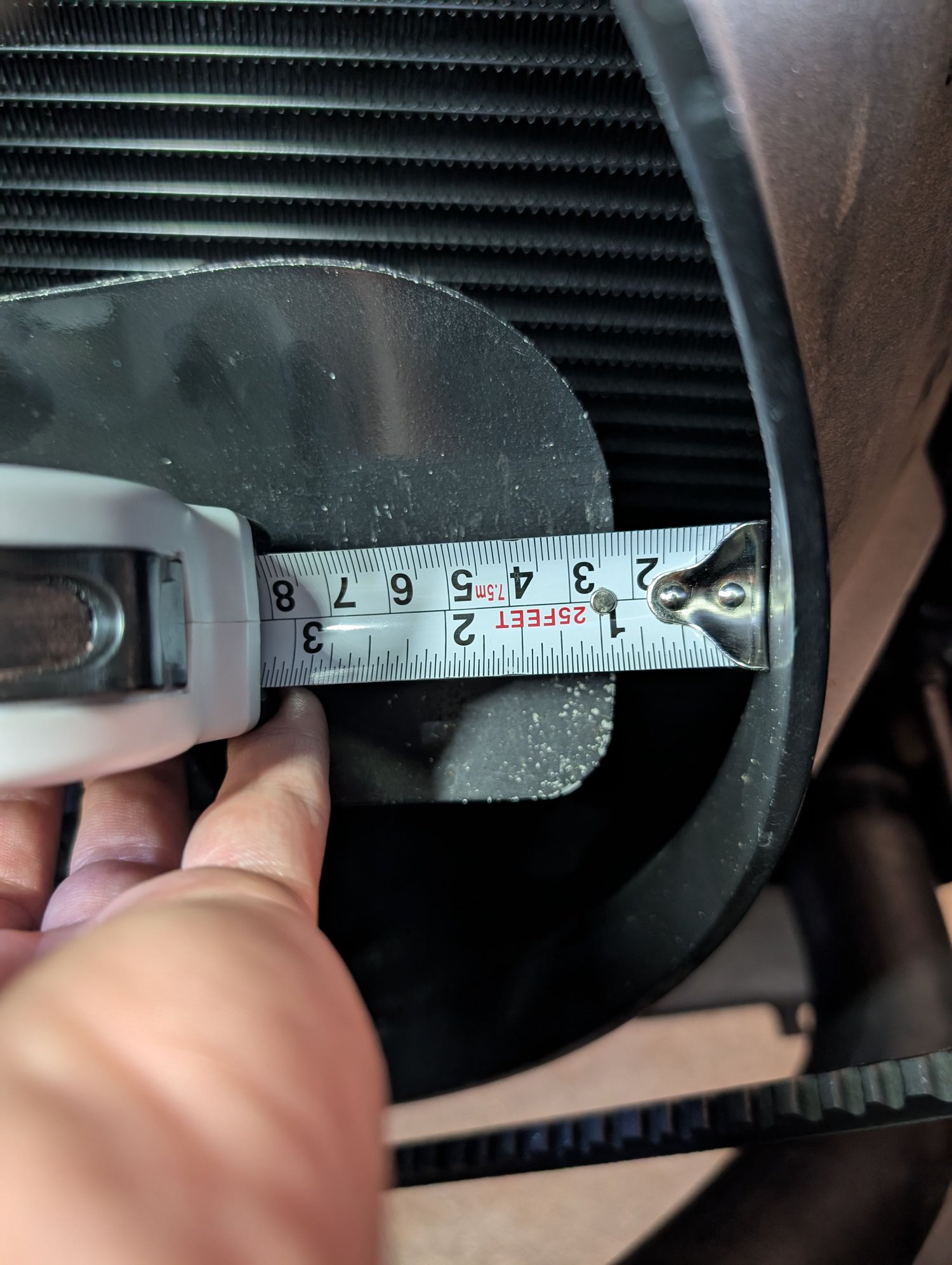

Thanks for all the input so far! To answer a few questions that have been posed:
1. Radiator specs: It's a ColdCase GMA-42AB. 2 row aluminum, 1.25" tubes, 16 fins per inch. While it didn't "solve" my high temps while idling, it did improve on-highway cooling. So this radiator has increased cooling capacity compared to my previous one (whether due to size, design, or just not have mineral deposits inside - who knows!)
2. Idle speed - 710 rpm checked with a digital timing light. It's a little lower than the Service Manual recommendation of 830 rpm.
3. Attached is a picture of the fan in the fan shroud. The fan does sit a little too deep, it's not 75% inside/25% outside. The shroud looks stock to me (it has the raised spot for the radiator hose clamp) and I'm using the correct fan clutch. I suppose a shorter fan clutch standoff could be used, but there isn't a lot of room between the clutch and standoff mounting bolts as is.

The biggest thing I see in this situation is relying on a gauge to tell you the truth without verifying the gauge.
With a healthy factory OEM 4 row cooling system, clutch fan, shroud, core support seals, good timing, and AF mixture mine runs 195° maybe 205° on a ballz out hot day.
It's been 95ish degrees with high sticky RH in my neck of the woods the last few days. Just did a cruise yesterday, 50-mile RT. Idling in traffic, it does not go above 205.
192° HD Stant, 50/50 mix regular green juice.
The point is, GM designed it to run like this. They worked fine when new. I've done nothing but maintain that engineering. I've tossed zero aftermarket fix-alls at it.

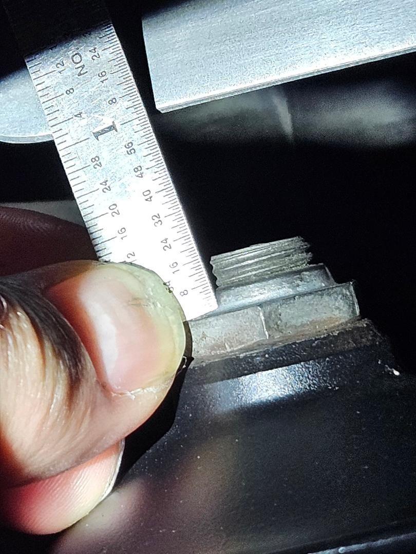

Firstly- thanks for all the engagement helping to correct this problem. I did not expect as much input for a "running hot issue", since it comes up so often. A big thank you!
Ok, I went out and got some measurements, pictures attached.
1. I saw wrong, I have a 6 blade fan. Blade depth is a little over 2", but not 2.5"
2. Distance from edge of fan blade to water pump pulley nut= 3/4"
3. Distance of fan center to mounting point about = 1 5/8"
4. Fan clutch standoff length (it's part of the clutch, can't be changed) = 1 1/8"
5. Depth of shroud = 4 7/8"
6. Fan tip to shroud distance = 7/8" (the shroud is hard to mount perfectly centered, so some spots may be closer, others maybe farther)
7. Once warmed up, curb idle adjusted to 850 rpm per the manual.
8. Timing at idle (with vacuum to HEI disconnected but not plugged and carb port plugged) = 8.0 degrees
Regarding the fan depth: a) either the shroud is incorrect, b) the mangled saddles are causing the radiator to be forward a bit more than correct, or c) I need a new fan with deeper pitch to clear the shroud (this would barely work).
According to the service manual - the clutch length should be 1.5" (I measured 1 1/8" but maybe they quote to a different face) and the correct fan is a 19"/6 blade fan, which I have.
Thoughts on that initial timing measurement of 8.0 degrees? I have an engine combination not present on the manual: 455 low compression with a 4 barrel QJet. At 850 rpm, the manual specs 6 degrees for a low compression 455 with a 2 barrel, and 8 degrees for a high compression 455 with a 4 barrel.

Additionally, here are some IR temp gun readings across the engine bay and a picture of the temp gauge.
Unless I measured the timing wrong and need to redo it, I'm out of things to check! I suppose I could have an inefficient water pump impeller, but that pump isn't leaking so it's staying on. The thermostat could be partially opening, but I'd think highway driving would be impacted in that case.
A Hayden Severe Duty Fan might be an answer, or a deeper pitch fan. But I have throwing parts at a problem.
Passenger side radiator tank upper
Lower rad hose
Lower rad hose
Upper rad hose
Upper rad hose
Driver side radiator tank upper
Thermostat housing
Thermostat housing
Thermostat neck
Thermostat neck
Upper rad hose near thermostat
Guage
Gauge
